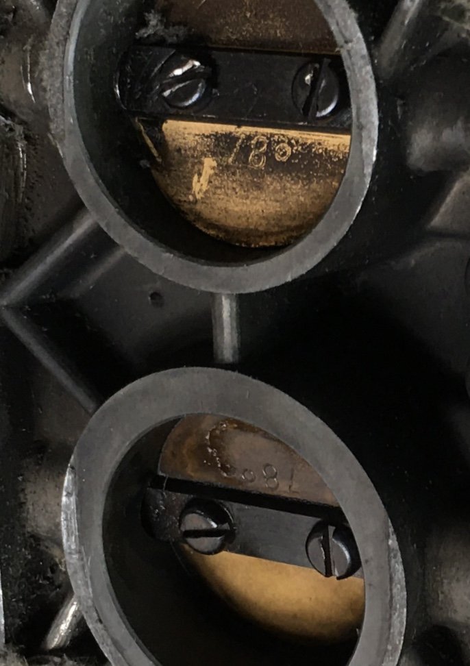

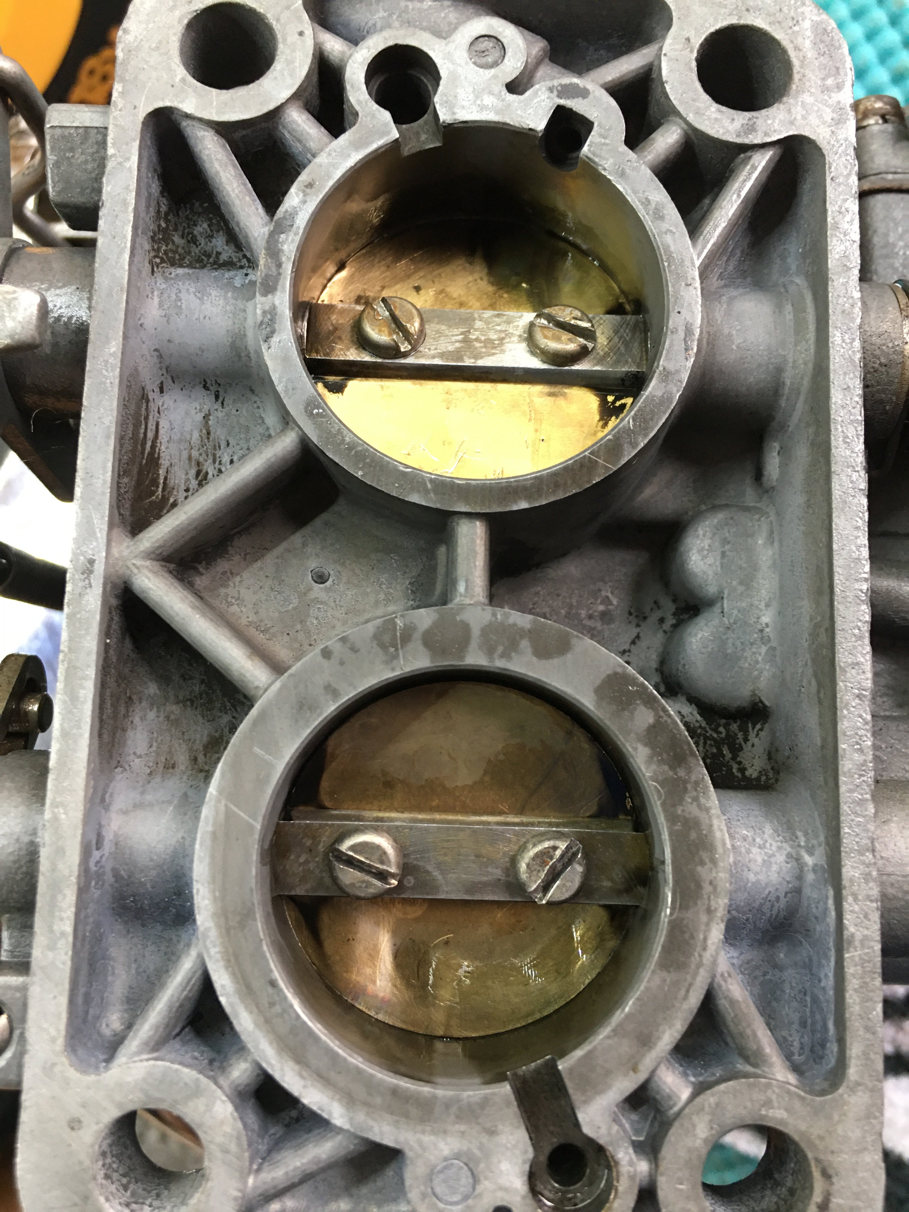

Investigation shows I re-assembled the Carb incorrectly, the first pic is pre service the second is what it looks like now......

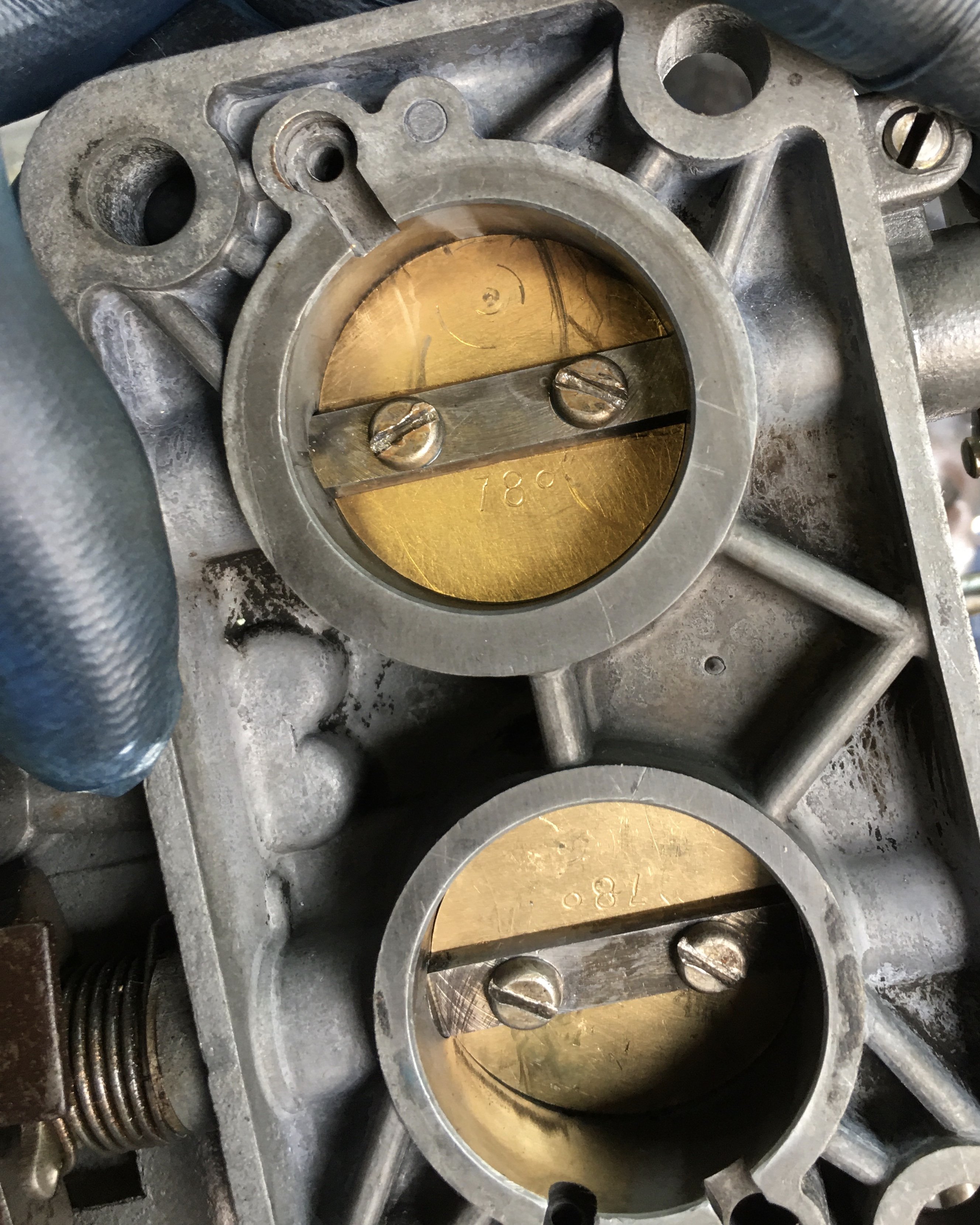

Yes, Johnny boy told me it couldn’t be right then I looked at Rays & you could see the 78 on the butterflies - I had to check mine &.......🤐
So - I’ve removed both butterflies, turned them over so the 78 degrees marking on both is closest to the centre (Top Tip) & the throttle & choke mechanism is much smoother & both butterflies close w/out a gap this time! Mix screw now x2 turns out - we’ll see 👍🤔

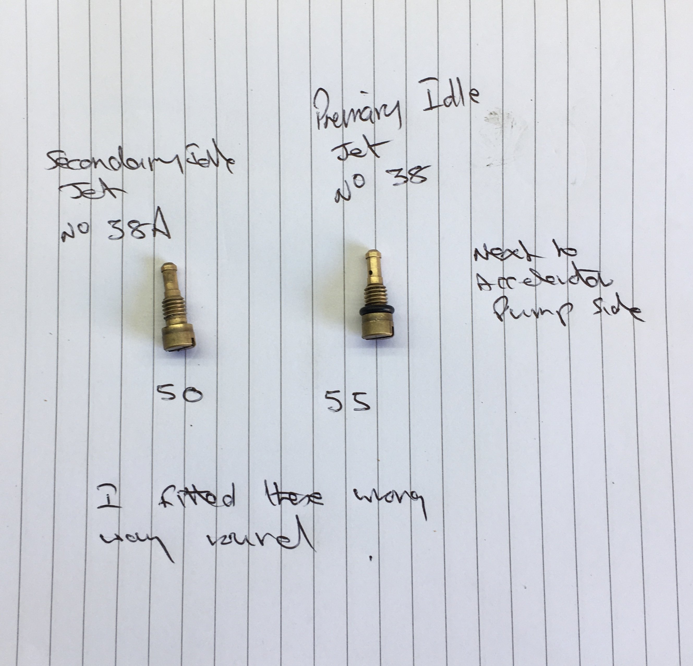

I’ve fitted the Primary Idle Jet (55) & Secondary Idle Jet (50) the wrong way round - but what difference would that make?
