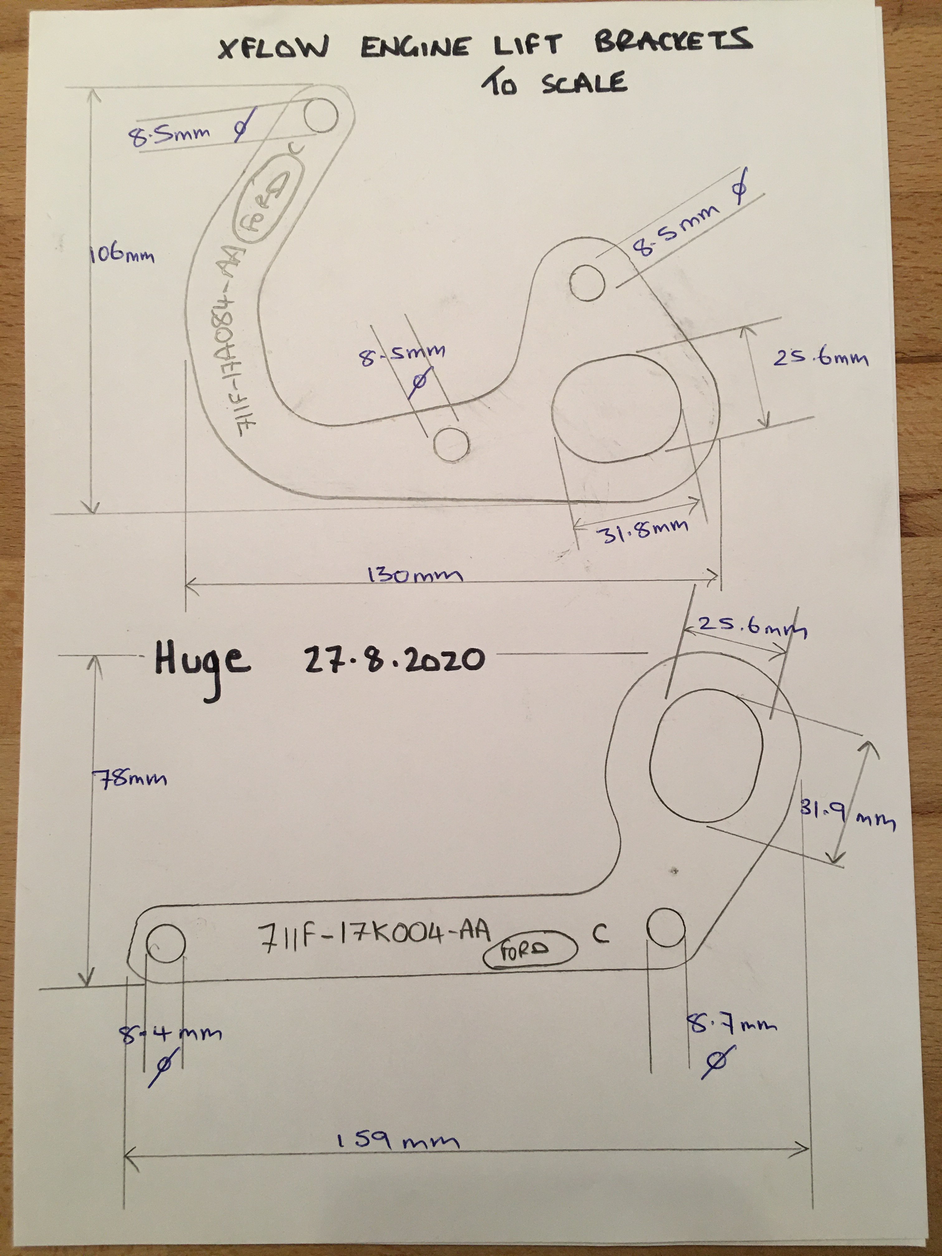

Huge Posted August 27, 2020 Author Report Posted August 27, 2020 Photo showing measurements of xflow engine lifting brackets in case anyone wants to take it upon themselves to have some made (Project Daisy) 1
