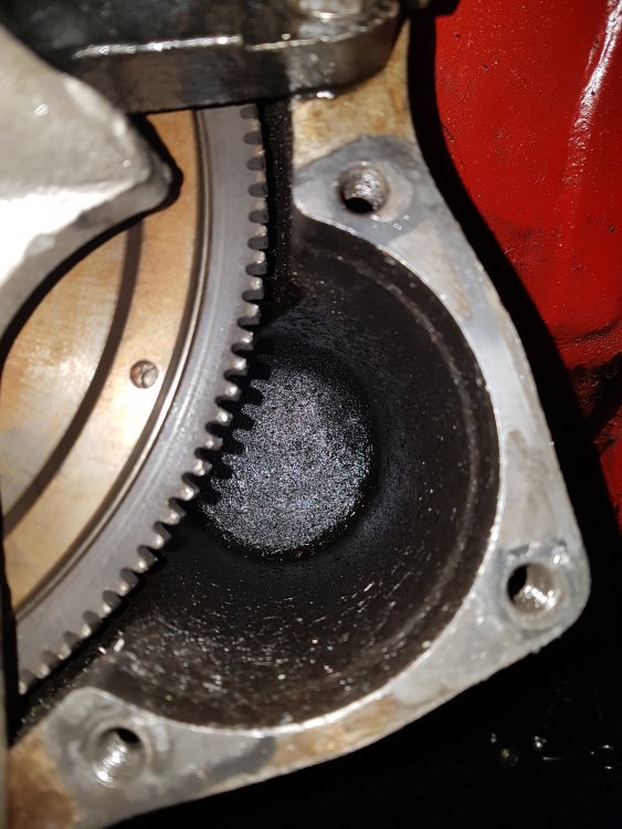

preacherman Posted September 30, 2020 Report Posted September 30, 2020 Question . Type 9 Cast iron bellhousing Is there A difference between a transit pinto bell housing and saloon pinto bellhousing. Ring gear and starters are different Need to sort my starting issues. I think I may have knackered ring gear or compatability issues between it all. Keep snapping the starter cone or they are being destroyed. Thankfully it made it through the rolling road session...just Neil
eeb43 Posted September 30, 2020 Report Posted September 30, 2020 transit pinto has a conversion plate on it to bolt it to a much bigger bellhousing
preacherman Posted September 30, 2020 Author Report Posted September 30, 2020 I might need to change flywheel ring gear or get a tranny 9 tooth starter. The starter motor guy said the tranny starter will foul on bell housing. Looks like I need to count flywheel teeth. The strangle thing is I saw the sierra GL the box came out of as I bought engine and box as a job lot
katana Posted September 30, 2020 Report Posted September 30, 2020 5 hours ago, preacherman said: Question . Type 9 Cast iron bellhousing Is there A difference between a transit pinto bell housing and saloon pinto bellhousing. Ring gear and starters are different From what i've seen on a Turbosport thread, some of the Transit flywheels are huge - about 13.5" compared to a usual pinto flywheel at about 11" - obviously the bell housings, ring gears & possibly starters are similarly different! The poor guy couldn't work out why the flywheel wouldn't fit into his RS bell housing LOL!
DT36 Posted September 30, 2020 Report Posted September 30, 2020 52 minutes ago, preacherman said: I might need to change flywheel ring gear or get a tranny 9 tooth starter. The starter motor guy said the tranny starter will foul on bell housing. Looks like I need to count flywheel teeth. The strangle thing is I saw the sierra GL the box came out of as I bought engine and box as a job lot I definitely definitely have a 135 tooth Pinto flywheel here. It's full weight, so nice idle 😉

preacherman Posted October 1, 2020 Author Report Posted October 1, 2020 So today had another look. When I start the car the starter engages ...engine turns ...start disengaged too quickly. Got it started and did 116mph on the heads of valley. A white van was right up my arse though cocky fairy.
DT36 Posted October 1, 2020 Report Posted October 1, 2020 16 minutes ago, preacherman said: So today had another look. When I start the car the starter engages ...engine turns ...start disengaged too quickly. Got it started and did 116mph on the heads of valley. A white van was right up my arse though cocky fairy. Have you tried Engineers Blue on the teeth to see how much the teeth are engaging? Might be worth a go.
preacherman Posted October 7, 2020 Author Report Posted October 7, 2020 Starter engages for a few seconds and disengages after 2 seconds. Car will not start as starter will not engage for long enough to start. Took if off cleaned it up and filed off some casting flash. Starter engages better but not harsh like it previously was. The ring gear on flywheel has some wear but I see worse Since I cameback from rolling road it will not start . Is it possible the ignition timing is too retarded. 20201007_195544.mp4
