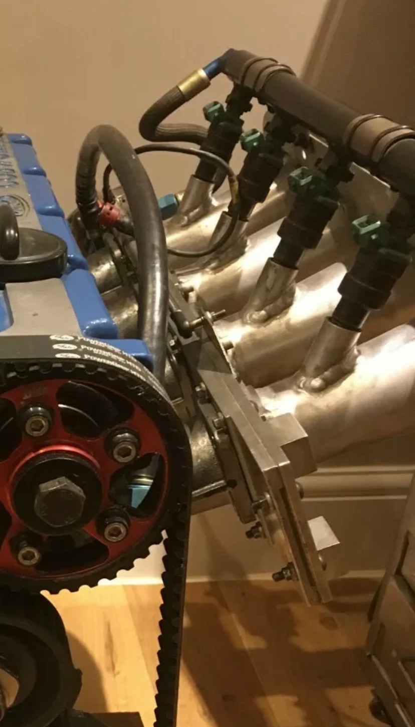

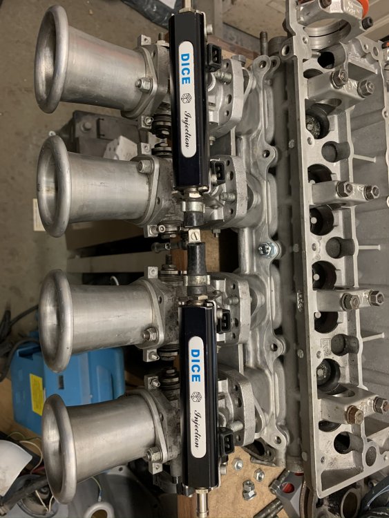

notenoughtime Posted November 15, 2020 Report Posted November 15, 2020 So I’m building a N/A Cosworth engine and have both set of 45 TB’s and a set of slide throttle bodies what would you choose i know slides aren’t really the best for most applications but how good does that look when you open the bonnet 😂 the Tb’s will be good all round pic of TB’s on the head
katana Posted November 15, 2020 Report Posted November 15, 2020 Don't know why you wouldn't want slide throttle bodies - they make the most power if that what you are after? And do look the bollux to anyone who knows what they are looking at! I'll straight swap if you want, slides for black TB's? 1
notenoughtime Posted November 15, 2020 Author Report Posted November 15, 2020 Thanks for the offer lol if I don’t use them I’ve got to keep them as when do you ever get offered another set

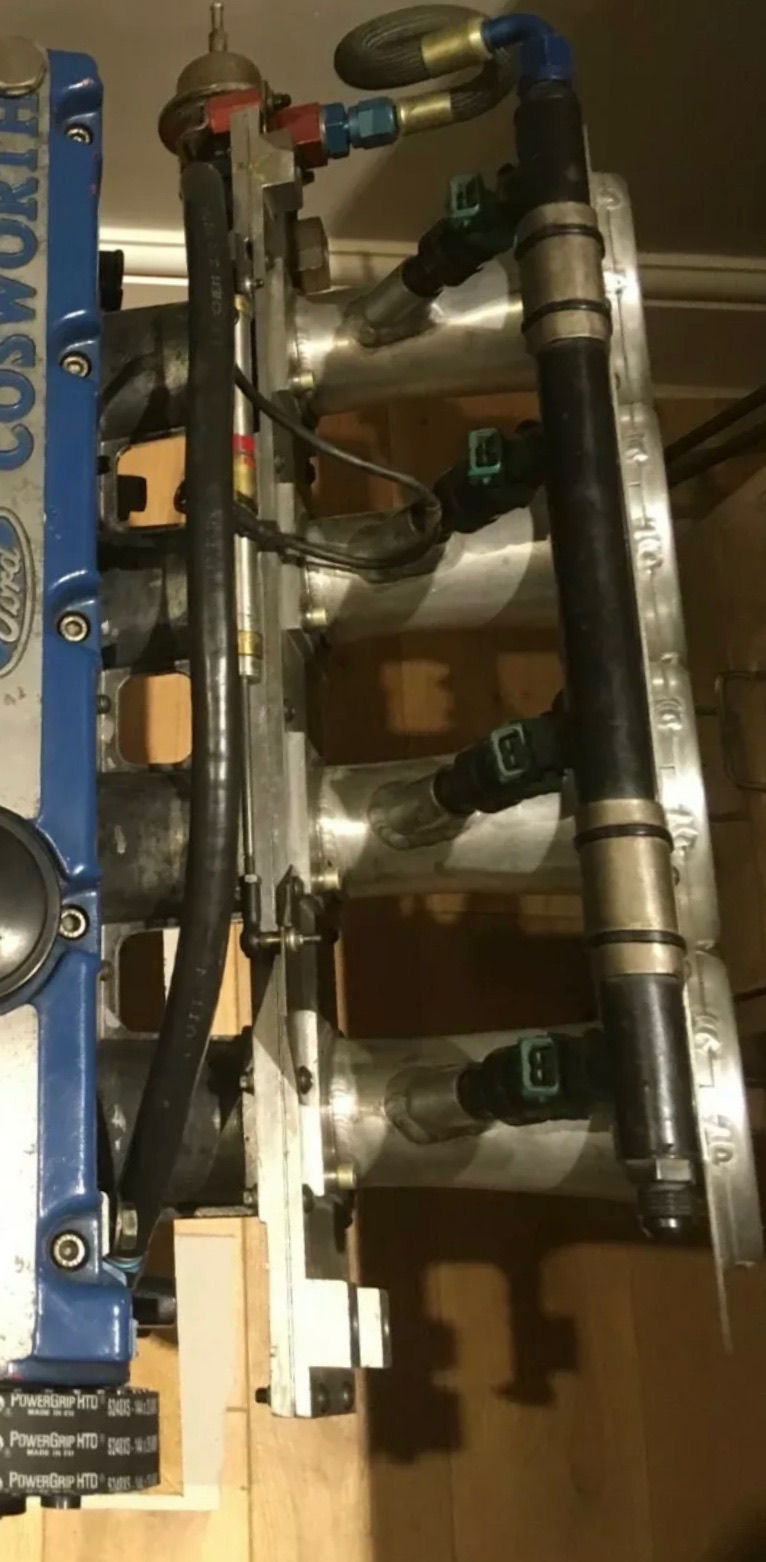

notenoughtime Posted November 15, 2020 Author Report Posted November 15, 2020 These are the slides with 330cc injectors more pics coming soon
notenoughtime Posted November 15, 2020 Author Report Posted November 15, 2020 (edited) I’m thinking of putting another set of injectors before slide to improve drivability on low end throttle and then get ecu to swap to outers as cams comes on song Edited November 15, 2020 by notenoughtime
