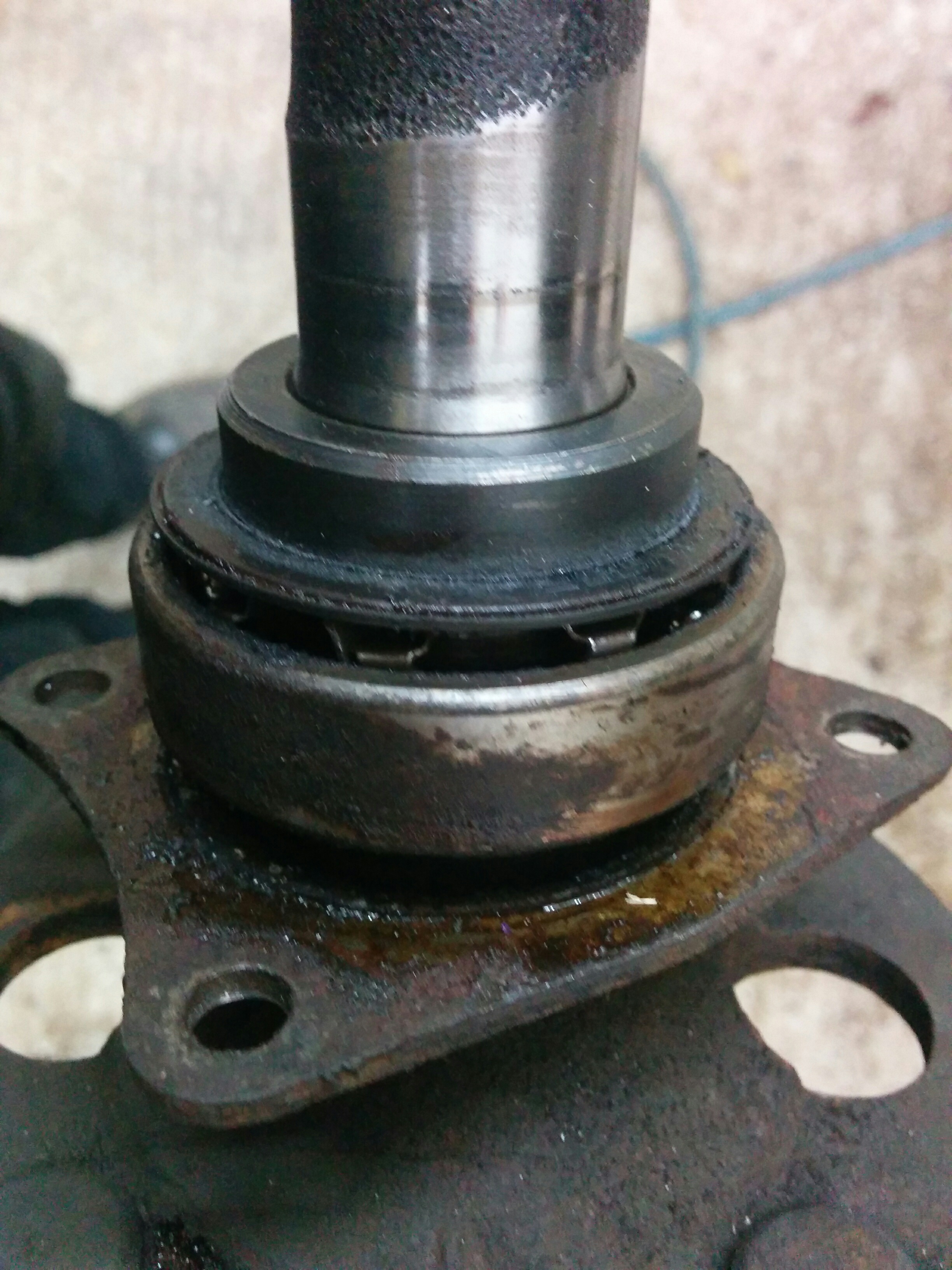

Johnny Boy Posted December 20, 2020 Report Posted December 20, 2020 I went out for hoon this morning, and started hearing unusual noises, of the kind that worry you. Got out had a look around, couldn't see anything, it sounded like a prop u/j ,wheel speed related. I was only about 5 miles from home, so drove home slowly. Got it up on the ramp , prop good suspect the diff or broken halfshaft. Noise from o/s wheel, no movement ,but strange clicking sound. Pulled the shaft out , and the wheel bearing had collapsed. New bearing then🙄

Johnny Boy Posted December 20, 2020 Author Report Posted December 20, 2020 3 hours ago, notenoughtime said: At least it’s not to much agro to do! I ordered 2, the other side seems fine, but so did the failed side, when I built up the axle last year. 🙄

Johnny Boy Posted December 26, 2020 Author Report Posted December 26, 2020 Well............... I managed to buy a pair of 1966 on bearings.................. I need 1965 ones................. So I've now ordered the correct ones, but they won't be here for a week or more.🙄
Johnny Boy Posted January 3, 2021 Author Report Posted January 3, 2021 All done now, and changed the oil in the ATB as I've done some miles now and it will be run in now.
