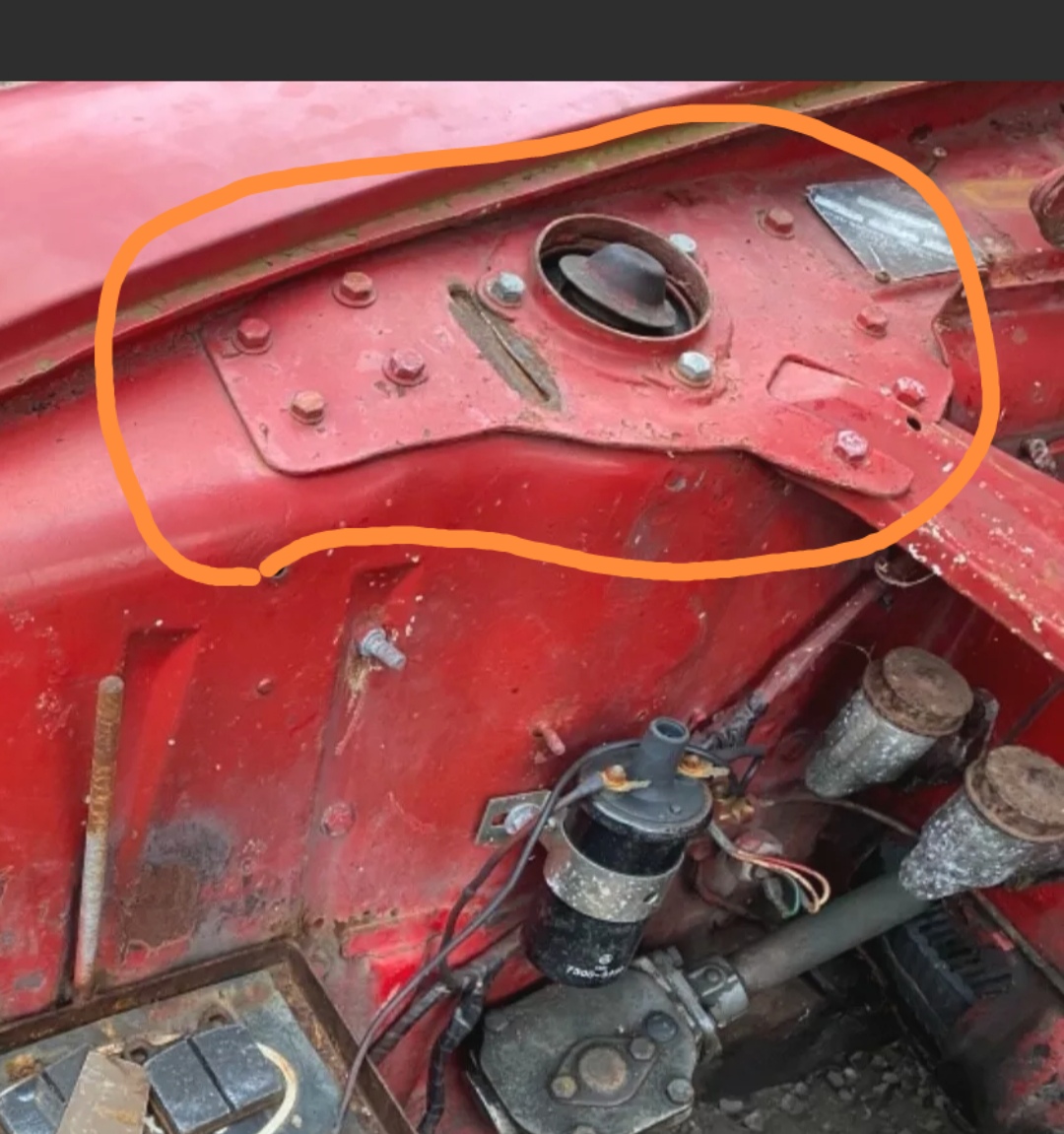

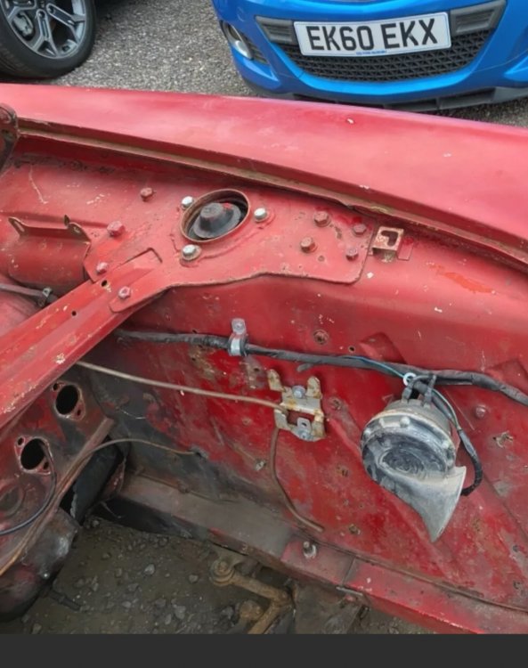

chinkamon Posted March 2, 2021 Report Posted March 2, 2021 Glancing eBay looking at stuff I can't afford ( as you do ) saw a 2dr cortina but it had unusual strengthening support type things on the mounts. It's an import as has the brace in place but has anyone seen these before?
colr6 Posted March 2, 2021 Report Posted March 2, 2021 What a bloody mess !!!! The diagonal brace is fitted to some export models and is welded. The bolt on plate is someone’s poor attempt at strengthening who obviously has no access to a welder. 1 1
chinkamon Posted March 2, 2021 Author Report Posted March 2, 2021 Well I guess it'll hold the front end together when the inevitable rust comes through 🤣
colr6 Posted March 2, 2021 Report Posted March 2, 2021 5 hours ago, chinkamon said: Well I guess it'll hold the front end together when the inevitable rust comes through 🤣 I’ve just had another look at those pics, it would appear the rubber top mounts are fitted on the WRONG side of strut plate. They should be underneath. Those pics should be in another thread Bodged repairs show us your worst....lol 1
