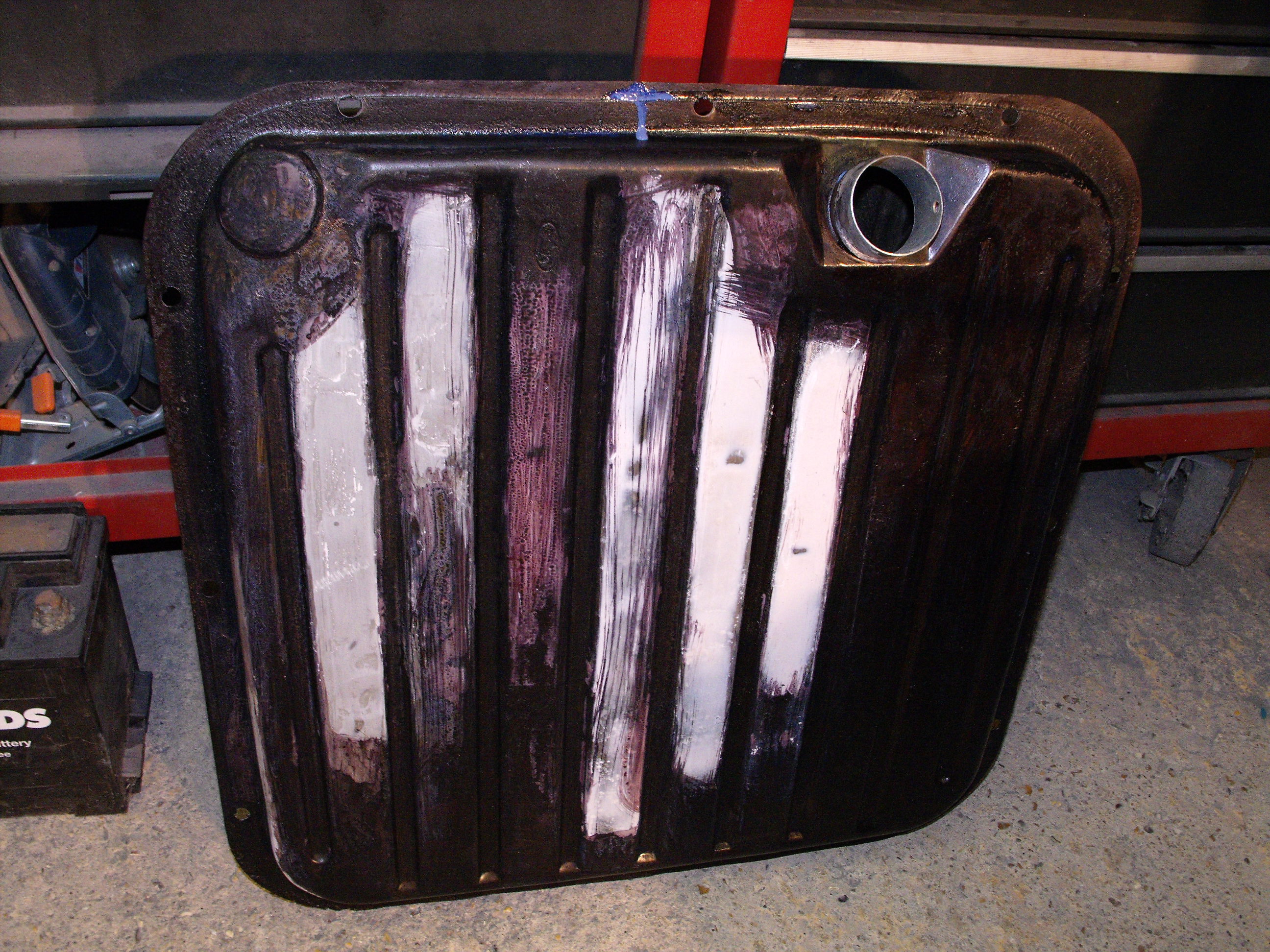

fuel tank for starters
Hard to find good ones and the Corsair tank is unique. But the Cortina Mk1 and 2 can be adapted to fit as they have the same mounting hole positions. The main difference is the position of the filler neck. Corsair is in the just off centre in the rear edge, whereas the Cortinas ones are on the right rear corner. I did have one from a mk2 Cortina which has bigger capacity by 2 galls. I had the filler neck position altered to suit the Corsair and fuel sender hole was altered to suit my original sender. See my pic. Be aware early 1500 corsair and mk1 cortina tanks used a smaller diameter fuel sender and different resistance values, so your later one wont fit into the early tanks. The early senders dont work with 2000e gauges either.

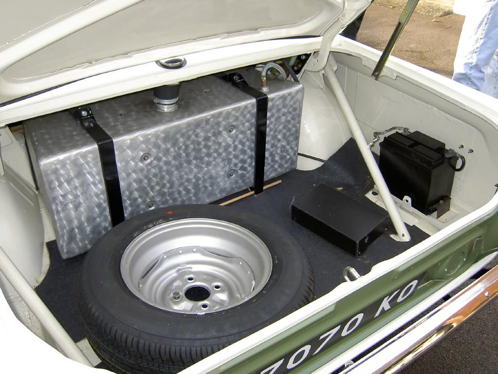

Good luck with sourcing the parts, if you are not fussed about originality you could always fit a fuel tank
