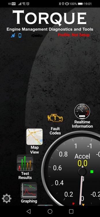

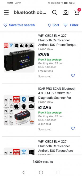

These are usually my first port of call on a more modern engine with various sensors etc.
I use this to read and erase fault codes.
Edited by dt36
Yeah just spoke to my mate he's hopefully gonna pop over with his fault reader.
