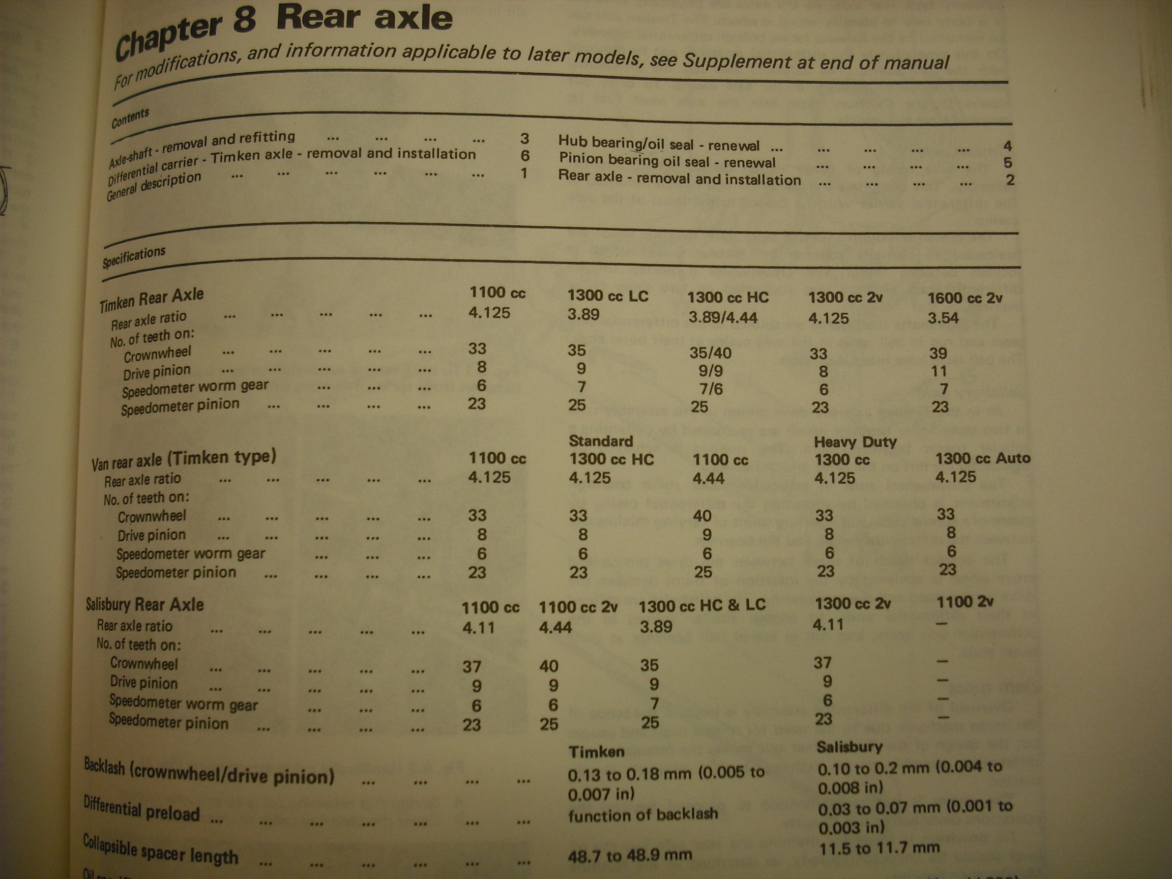

HotRodMatt Posted January 15, 2025 Report Posted January 15, 2025 Hi all, Clearing out my junk/parts from storage and I've found this English CWP, the crownwheel has 33 teeth and the pinion 9, which works out at 3.66. Can't say I've heard of this ratio so what's it come from? Matt
Miniliteman Posted January 15, 2025 Report Posted January 15, 2025 Count the pinion again, could be 8. Then it's a 4.125 .
HotRodMatt Posted January 16, 2025 Author Report Posted January 16, 2025 16 hours ago, Miniliteman said: Count the pinion again, could be 8. Then it's a 4.125 . Definitely 9 on the pinion.
anglia58 Posted January 16, 2025 Report Posted January 16, 2025 it's 9 on the pignion; and 33 on the crownwheel, it's not escort mk1/2 or cortina mk4/5, so you can trow it away, also becaurse the pinion teeth are sharp, and i think the sides have also a lot of wear, it's scrap, sorry it's not to piss you of, cheers marcel
HotRodMatt Posted January 16, 2025 Author Report Posted January 16, 2025 Yeah it's definitely past its best! Was going to bin it, was just curious. It bolts up perfectly to the diff gear carrier out of my Mk1. Strange.
