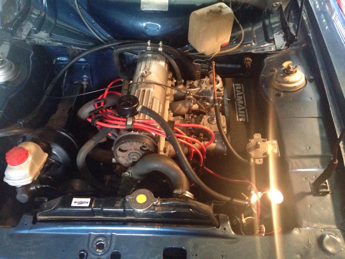

  9. Hi luckyjim It ended up being a dodgy earth on the starter relay. I moved the relay with the rest of the wiring and hadnt fastened it down tight enough on the earth. Carbies are on and it is running. Needs some tuning and I'm not sure about the heater hose routes.

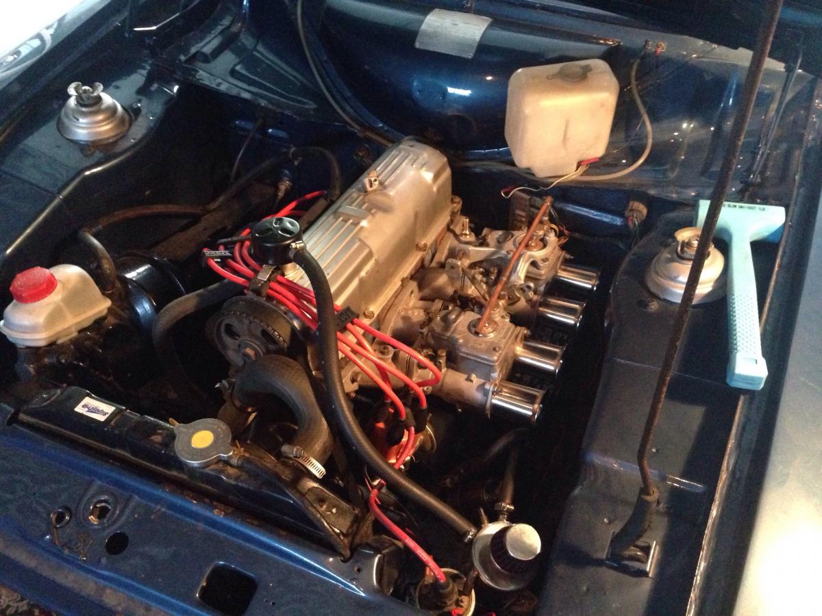

  10. So I just finished relocating the battery into the boot, fitting an oil catch can, malpassi filter king regulator/filter and twin 45DCOE's however once I got it all back together (Minus the throttle cable which I will have to sort out) the thing won't turn over I've run positive (Thick battery cable) directly to the starter and earthed the negative to the body in the boot. I've got the engine block earthed to the body and also run a second earth from one of the starter bolts to the gearbox cradle mount to the chassis. I didnt change any other wiring, just shortened things one at a time to neaten things up. Ive got the same voltage at the starter and engine block earth as I do accross the terminals on the battery Battery is the same 330cca battery that was under the bonnet. I don't even get a solinoid click. nothing, nada. Stereo, lights etc. all working great with no issues. Anyone have an idea?
