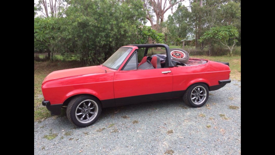

Haven't posted here in a while. - Front is now a little lower still. Much better stance now. - Had an oil pressure problem (pump drive shaft spun resulting in a scored big end.) Cheers to Pete @ Performance Thumpers for getting me back on the road with a days turn around to make a cruise the next day! Between the two us we had the motor out, apart, new bearings and pump drive in, reassembled, back in the car and on the road in a few hours. - Nothing much too new has happened on the car really. Not too much left to go really (Coil over front, Vented front discs and MK2 rear drums, engine rebuild, rear seat recover, wrap the headers so my left leg doesnt get so hot when driving it hard on a hot day) but putting the eski on the backburning a little atm to get a few things done on my Chevy Luv. Some pics of our local group.
Thanks Dalmarshall The "To Do" list is getting smaller: - Connect hidden radio antenna to 12v power - Dynamat under dash and inside doors (Already done floors and boot) - Deeper steering wheel so I can put the seat back another inch - Fit front speakers - Vented Capri style front rotors and space the M16 calipers out to suit - New strut inserts - New upholstery for rear seat (some sun damage on top of the backrest) - Down another inch on the front - Engine rebuild with bigger cam etc. (Current motor uses a little oil and blows some smoke, could use a freshen up) I would also like to fit an LSD but the Aussie Borgwarner diff doesnt really leave any options for this so ill probobly leave this till last as it will mean a rear axle swap.
Did a bit of work on the Escort last week. - 2.4 turn quick rack is in - Oil pressure sender T piece added so I can still run the warning light on the dash (Relocated to the centre panel) - Round headlight conversion - Drilled and tapped the bearing housing in the quick shifter and fitted bolts with lock nuts to take up the play and stop the rattle. (Worked well ) Also the car is fully poly bushed (Happened a couple of months ago but didn't update.) Also gave it a bit of a wash and drove the pants off it. Went through 4 tanks of fuel in a week. Love driving this thing.

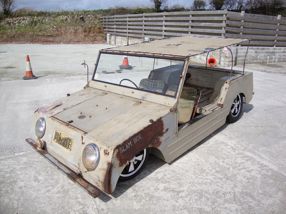

Aussie only "Country Buggy" VW A few of these getting around Aus in similar styles. Quite a rare car.
