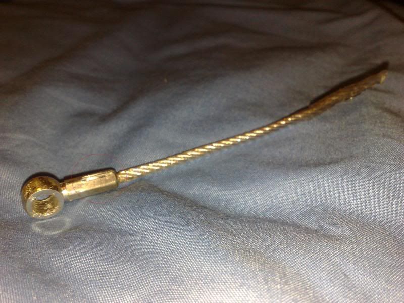

samurai Posted November 30, 2009 Report Posted November 30, 2009 Clutch cable broke today Anyone got any pictures of their engine bay with a pinto with a big manifold,i need to see how people route there cables. It seems that mine broke as i tied it to the speedo cable which gave it an angle! The heat/manifold also didnt help Thanks

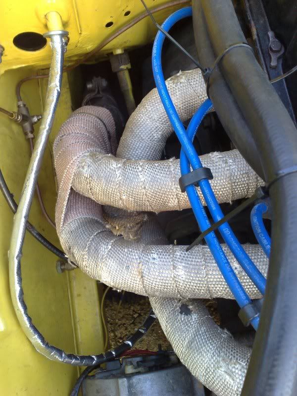

Admin Vista Posted November 30, 2009 Admin Report Posted November 30, 2009 Faced the same problem a couple of years ago and got a heat shielded one from somewhere shown in this thread from page 3 on http://www.oldskoolford.co.uk/phpBB2/vi ... &postorder

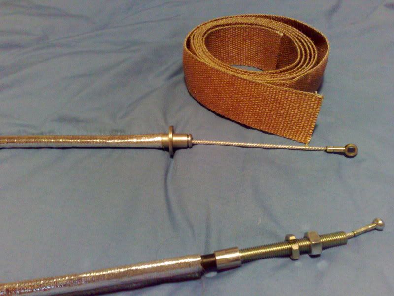

samurai Posted November 30, 2009 Author Report Posted November 30, 2009 I got 1 from 1 place which tured out to be crap then i got a long 1 from speedshack which broke today! So i ordered a heat shielded one from rally and competition equipment along with a heat shielded mat 50x50cm to wrap the clutch/speedo cables for extra protection. I noticed also the cable end where it connects to the clutch pedal is rubing on the bias pedalbox threaded bar! Ill get a picture now for you to see...

samurai Posted December 3, 2009 Author Report Posted December 3, 2009 The postman knocks on my door waking me up again before my alarm goes off! Heavy duty end bit compared to the other cable..made of metal..

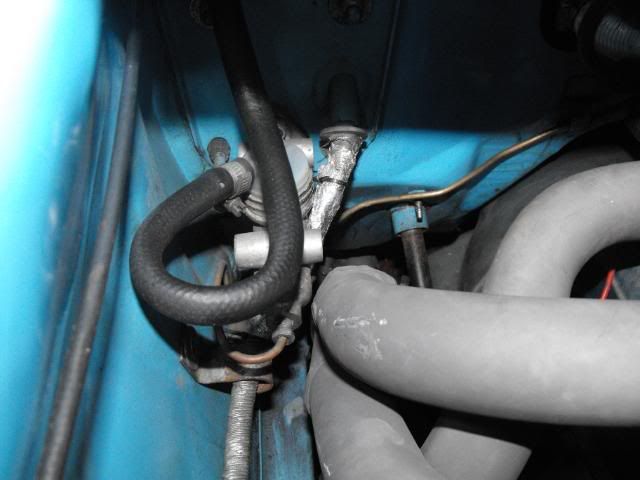

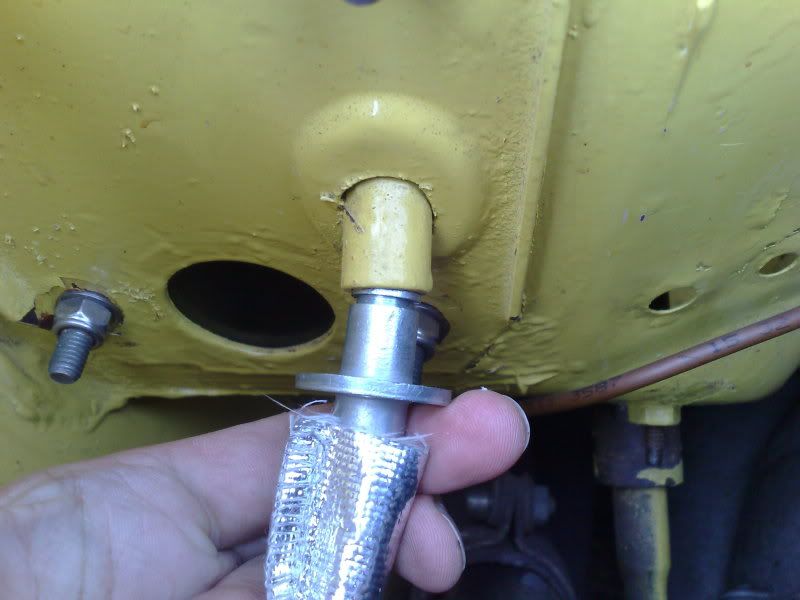

samurai Posted December 10, 2009 Author Report Posted December 10, 2009 First tryed fitting the heat shielded clutch cable and noticed that it wont fit in the hole like shown in the picture so it had to be filed down to fit. The cable is standard length with a metal end,its much nicer having the standard length cable as the other one was wayyy too long and was pointless. There is still alittle bit of a bend at the bulkhead end...will see how it goes. Also added more heat wrap around the manifold to go further down.

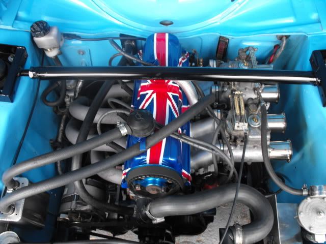

LEONMEX Posted December 10, 2009 Report Posted December 10, 2009 my old cable i got from r.a.c.e was bit longer & had the metal sleeve same as yours at the bulkhead. ran mine this close to the manifold & it was fine
samurai Posted December 10, 2009 Author Report Posted December 10, 2009 The angle of your cable coming out of the nozzle was like how mine was...and thats the one that snaped! Maybe the heat shield will make all the difference Nice rocker cover by the way How much did that cost? Id like one with a flag
