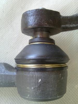

When you fit the Capri Bilstein struts to a Mk2 Escort you need to get special tie rod ends for the metric rack to imperial struts. Yet they dont actually screw into steering arms so Im confused as to the reason for the special tie rod ends? Further to that you dont need special track control arms? Am I missing something? Im sure the answer is obvious and will probably feel like an idiot afterwards. Thanks
You'll need RS ones as Smokem says mate.
The taper on standard mk2 escort legs that go into the steering arms is to small and the RS ones are bigger but have the same thread size on the rack rod.
  • Moderator
 Is is possible that it may be the other way around and that the RS ones are smaller? I just bought some tie rod ends for an Australian 2Lt/Rally Pack/RS2000 whose struts have integral steering arms which I believe are the same as standard Mk2 Euro Escorts but the same its clearly too big for the steering arms.

Just to bump this thread a bit, the tie rod ends arrived from the UK today and were ordered for a Euro RS2000 but they too are too big for the steering arms holes like the first set. It appears that Euro RS2000s and Australian 2lt Struts use the same control arms but neither fit the Capri Bilstein Struts. Im not sure what to do next thats 2 sets I have wasted my money on now. There must be a solution, after all these struts are so commonly fitted to Mk2 Escorts. How does everyone do it? Thanks.

Thanks for your reply. Im referring to original Capri Bilstein Struts with separate steering arms. (The photo I have is with the steering arm off the strut) Tie Rod Ends for the Australian struts didnt fit and thats understandable and it was mentioned here that European Mk2 RS2000 Tie Rod Ends were what was needed. They just arrived from the UK and appear to be the same as those for the Australian Struts in that the shaft of the Tie Rod Ends are too think to fit into the Capri steering arms. So Im getting a bit concerned what to do next. I cant keep buying Tie Rod ends just to experiment and with it being a common conversion there must be a solution im sure.
It may even be possible that the seller has supplied the wrong ones. these were the ones I purchased.

At £5.95 I would say that there's a high likelyhood that they're not RS2000 track rod ends, or that they're mid 90's rs2000 track rod ends. It's a common mistake from auto factors, I'd ask for a refund and if no joy raise a paypal claim.
In fact looking at the fitments in that listing, they're definitely the wrong ones as he lists them as being compatible with all the other models of mk2 escort, which RS2000 ones definitely are not. More confusing is that the text in black lists them as applicable to the RS2000 whereas the text in green says they're for 1.1, 1.3 and 1.6. Either way, they're definitely the wrong ones.
