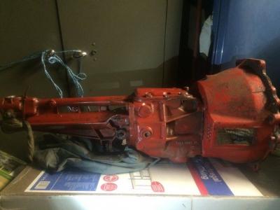

terry Posted January 2, 2016 Report Posted January 2, 2016 Hi all need a bit of help got a 4 speed gearbox for my escort but thrush bearings missing can anybody tell me which one a need ? i have 2 numbers 71BG 700 6JC or 72WO 7A040EA thanks
Admin Vista Posted January 2, 2016 Admin Report Posted January 2, 2016 Would guess that the type of four speed box dictates the choice of thrust bearing, do you know which type of box you have?
terry Posted January 3, 2016 Author Report Posted January 3, 2016 Hi no all i know is wont i put up i was hopeing someone on hear might be albe to help

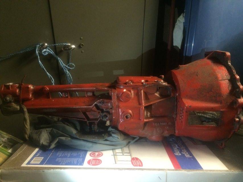

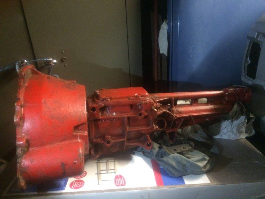

Admin Vista Posted January 3, 2016 Admin Report Posted January 3, 2016 Can you post up a few pics of th gearbox in question?

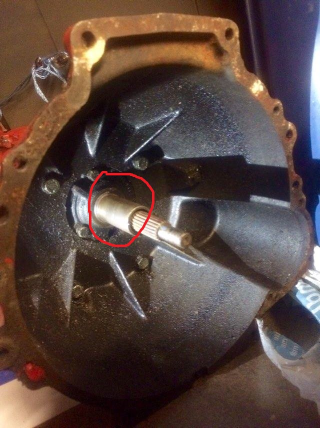

terry Posted January 5, 2016 Author Report Posted January 5, 2016 Can you post up a few pics of th gearbox in question? Here is the gearbox. I think it might be a type 3. Have circled a part which I'm having problems with getting a thrush bearing to fit.Any idea what size bearing?
colr6 Posted January 5, 2016 Report Posted January 5, 2016 It's a type three box, burtons list a release bearing for it should be 7/8 shaft 20 spline can't find a cross ref for either of your numbers. Hope this helps a bit
Admin Vista Posted January 5, 2016 Admin Report Posted January 5, 2016 Looks like a Type 3 to me too http://www.burtonpower.com/tuning-guides/tuning-guide-pages/ford-type-3-gearbox-guide.html How about this one? Perhaps worth a call to them at Burton before ordering though http://www.burtonpower.com/clutch-release-bearing-ford-cortina-capri-1-3-1-6-ecb110.html
