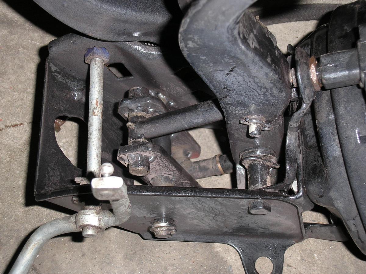

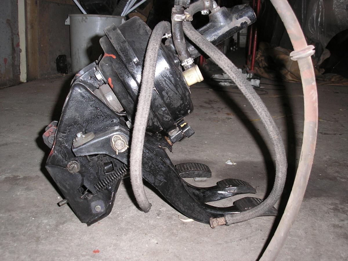

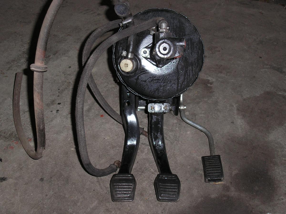

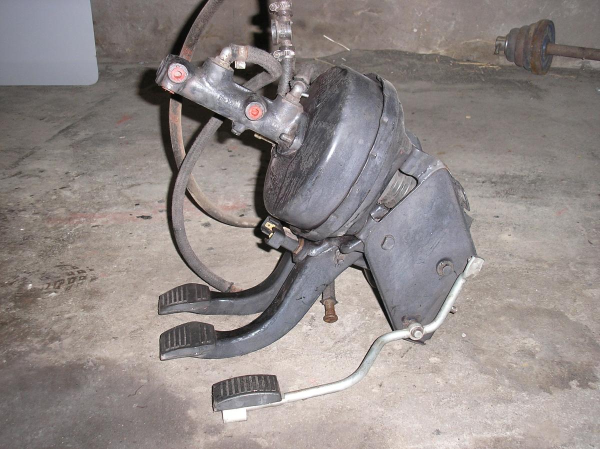

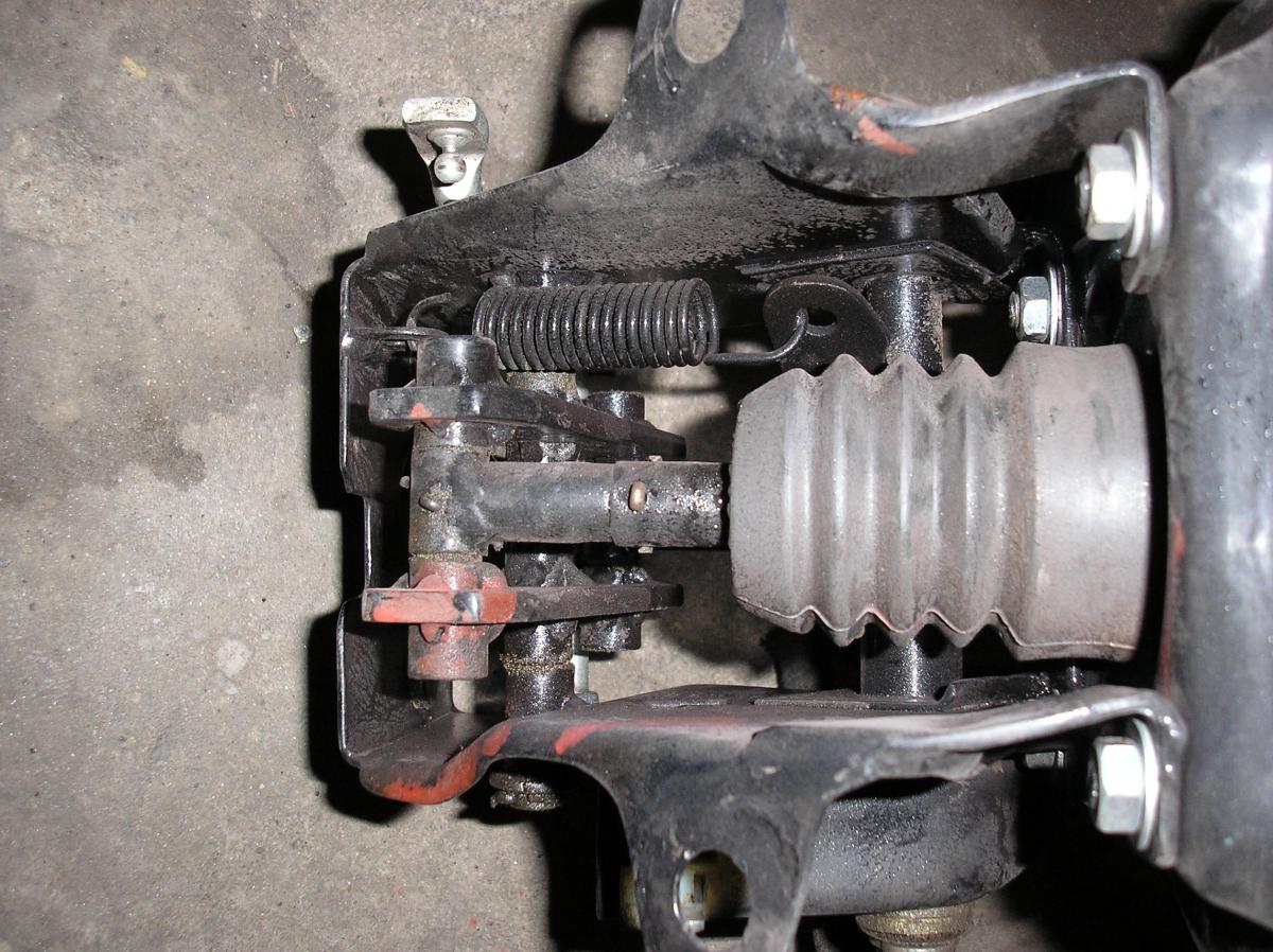

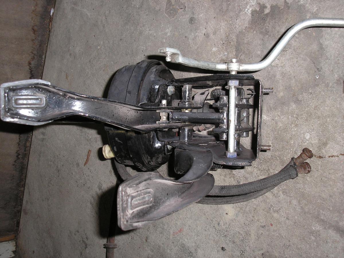

John escort mk1V6 Posted May 25, 2017 Report Posted May 25, 2017 I build this years ago and i did have it on mine estate to try it and the brakepedal was hard , 23.8 mm a booster from a taunus tc2/3. But now i have pedalbox with to cilinders on it. And i want to build it on mine mk1V6 with a electric vacuumpump. It is a fit tight and i got to loose a fit hardboard dash.
