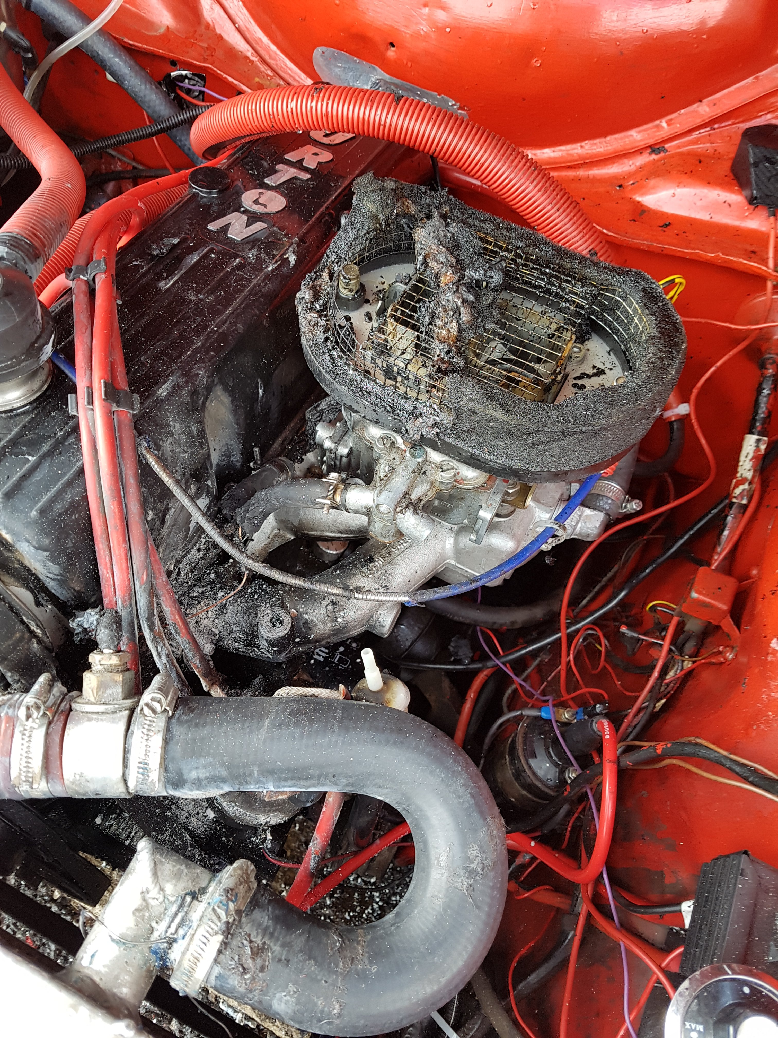

preacherman Posted May 27, 2018 Report Posted May 27, 2018 So started the escort today. Took a few goes but it got there.let it idle for a few minutes then it burst into flames. Lots of wet rags to smoother the flames. I could not stop it. Took my t shirt off and soaked it in water along with a coat and it stopped. I was actually about to give up on it and call it a day when it was burning. Damage Cam belt Top hose Dizzy cap and leads. Air filter Small burn to my tit,wrist and neck The cause was a split fuel pipe spraying fuel on the dizzy cap.

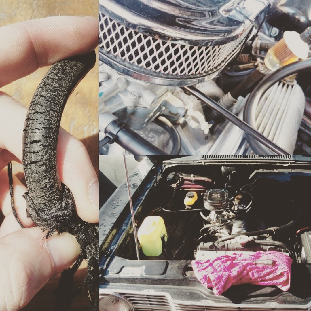

colr6 Posted May 27, 2018 Report Posted May 27, 2018 Sorry to hear about your misfortune, modern day fuels have a lot to answer for. Had some expensive braided hose on mine that started to leak fuel and only a year old. One has to be careful with what type of hose you use. Just looking, is that a foam air filter fitted ? That's one thing I wouldn't use, they tend to disk fuel up and one backfire it's up in smoke.
johnnyspencer Posted May 27, 2018 Report Posted May 27, 2018 17 minutes ago, colr6 said: Sorry to hear about your misfortune, modern day fuels have a lot to answer for. Had some expensive braided hose on mine that started to leak fuel and only a year old. One has to be careful with what type of hose you use. Just looking, is that a foam air filter fitted ? That's one thing I wouldn't use, they tend to disk fuel up and one backfire it's up in smoke. yep that's how my first mk1 fiesta went to car heaven, I wasn't so lucky I couldn't save it and it ended up a complete burnt out shell
AdamMc Posted May 27, 2018 Report Posted May 27, 2018 I was very nearly in the same boat a couple of weeks ago. Inadequate fuel hoses split badly and dripping on exhaust manifold, luckily caught it in time as I smelt it. They were covered with braided material so really hard to spot. I've seen this story an awful lot recently. Modern fuel is eating through this stuff.
preacherman Posted May 27, 2018 Author Report Posted May 27, 2018 Just noticed I singed my eyebrows. Yes it is a foam one and it made an horrible mess and the black smoke was choking. The fuel pipe is probably 12 mths old. Gonna change it all out.
mk1del Posted May 27, 2018 Report Posted May 27, 2018 Section in classic car weekly ,same thing ethanol in unleaded fuel rotting fuel pipes stored over winter, something we should all check
