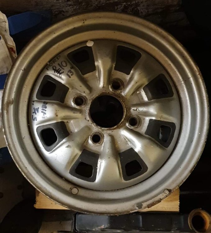

In my quest for Mexico steel wheels I purchased this one early on. When I got it home I realised it wasn't right. So what's it off?
It's a 5 1/2" 13 steel but without the deep dish.
Cant find any stamps or markings on it.

I would surmise it’s off a cortina mk3/4 2 ltr, even your second and third wheels are not matching.
The second is a 5 inch spare off the estate and the 3rd is off the mex

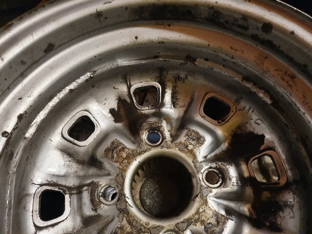

Do you mean where the centre cap fits? Not sure. The 4 spoke alloys are
11 hours ago, notenoughtime said:
Isn’t the fixing for the centre different on early Mexico deep dish steels?
Mk1 deep dish steels are 4 leaf clover design on the back, mk2 are fixed all the way round

The wheel that you first pictured with a smaller offset is fitted to my Escort Mk1 Sport.
They are also fitted to the Mk1 1300e.
