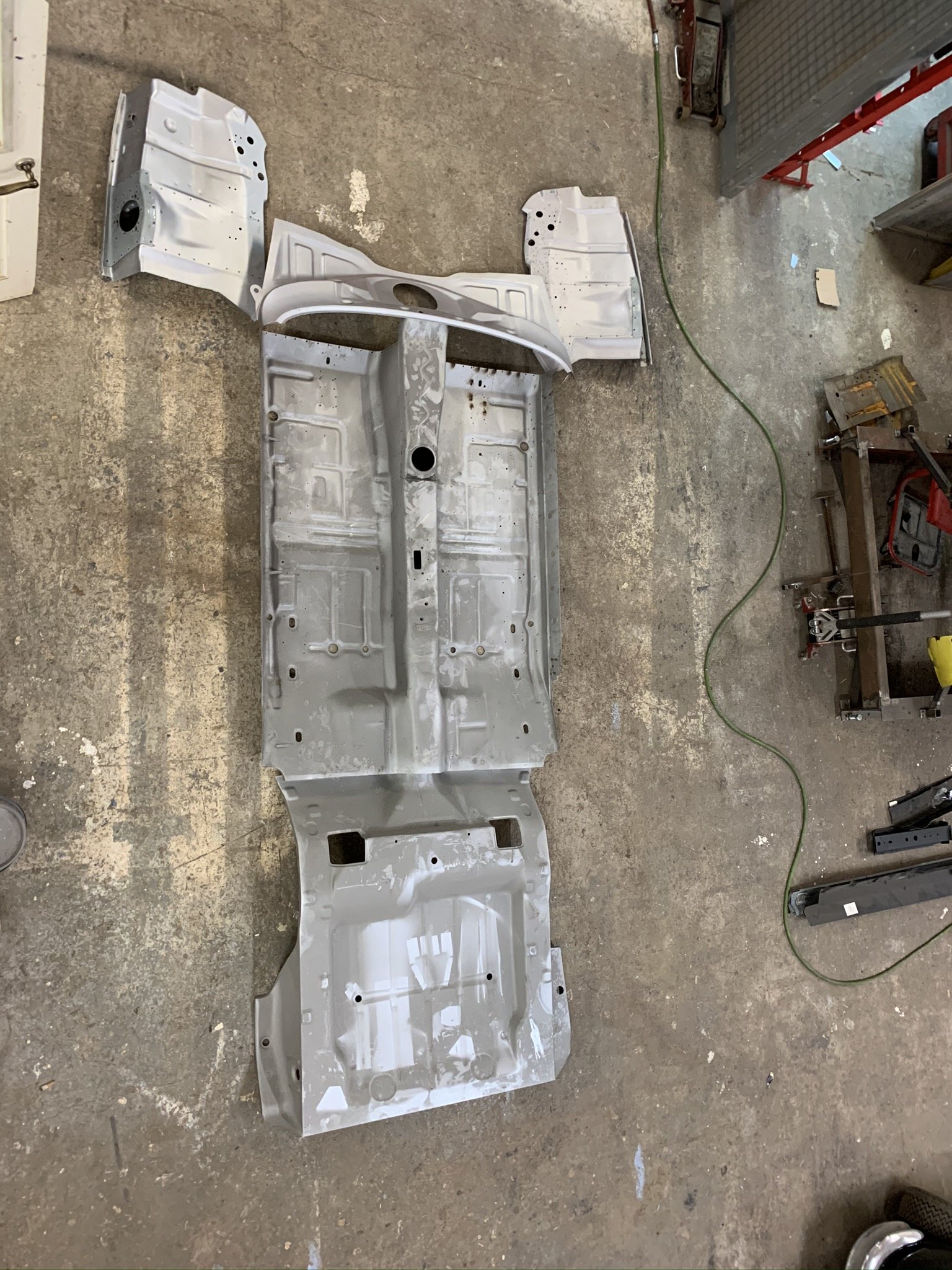

notenoughtime Posted October 21, 2019 Author Report Posted October 21, 2019 SOME of the panels needed, more on there way! 1

notenoughtime Posted October 21, 2019 Author Report Posted October 21, 2019 22 minutes ago, Monza said: Needs a bit of work/welding then m8.... Sent from my SM-G900F using Tapatalk Yes but the complete floors are easier to fit than trying to get repair panels to fit and look like they haven’t been done 1
Monza Posted October 21, 2019 Report Posted October 21, 2019 So I'm lead to believe. Wern't available when we started building mine.... neither were the complete inner wings or rear tubs!! List goes on [emoji85]Look foward to seeing your build m8...Sent from my SM-G900F using Tapatalk
notenoughtime Posted October 21, 2019 Author Report Posted October 21, 2019 12 minutes ago, Monza said: So I'm lead to believe. Wern't available when we started building mine.... neither were the complete inner wings or rear tubs!! List goes on Look foward to seeing your build m8... Sent from my SM-G900F using Tapatalk The list goes on indeed!! Got to pick the lower bulkhead up tomorrow

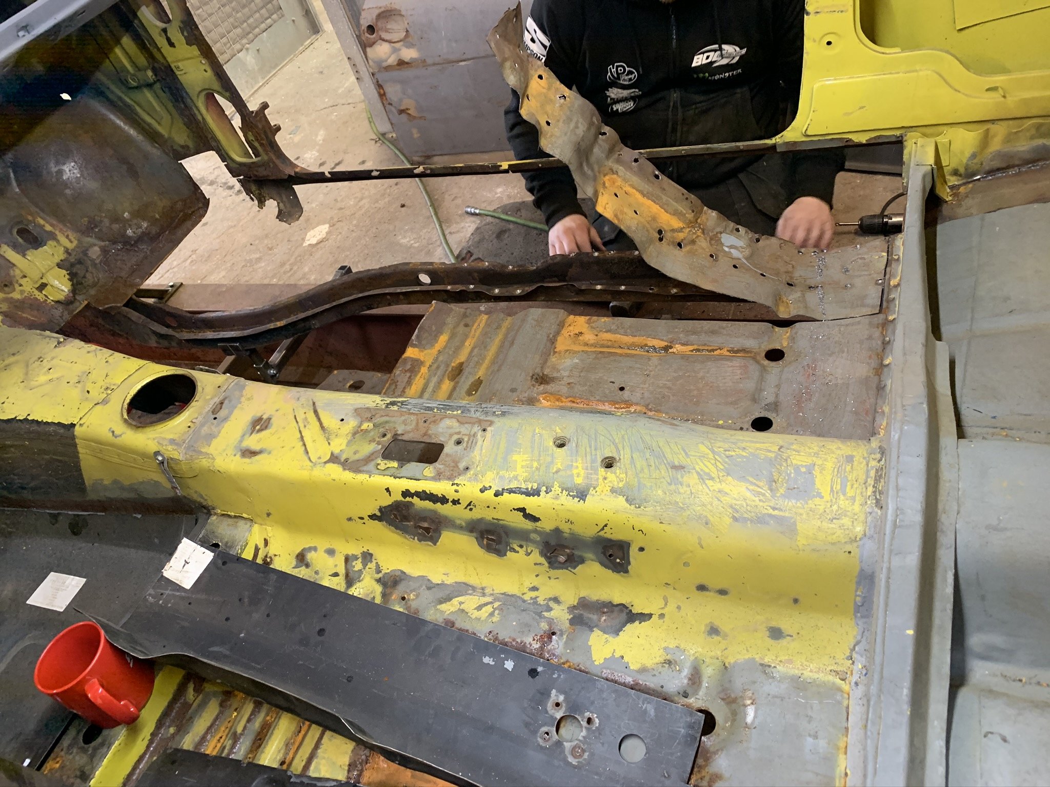

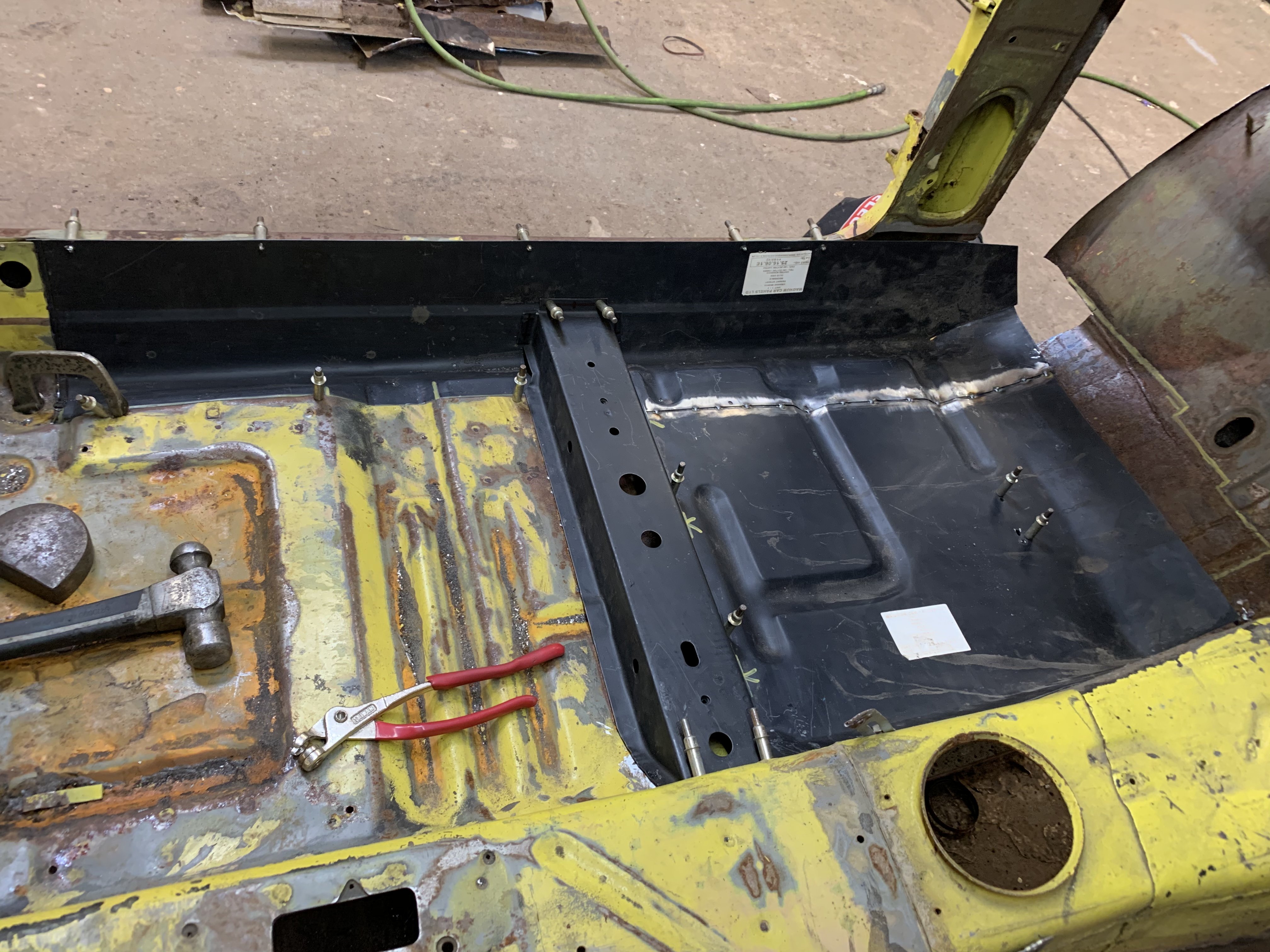

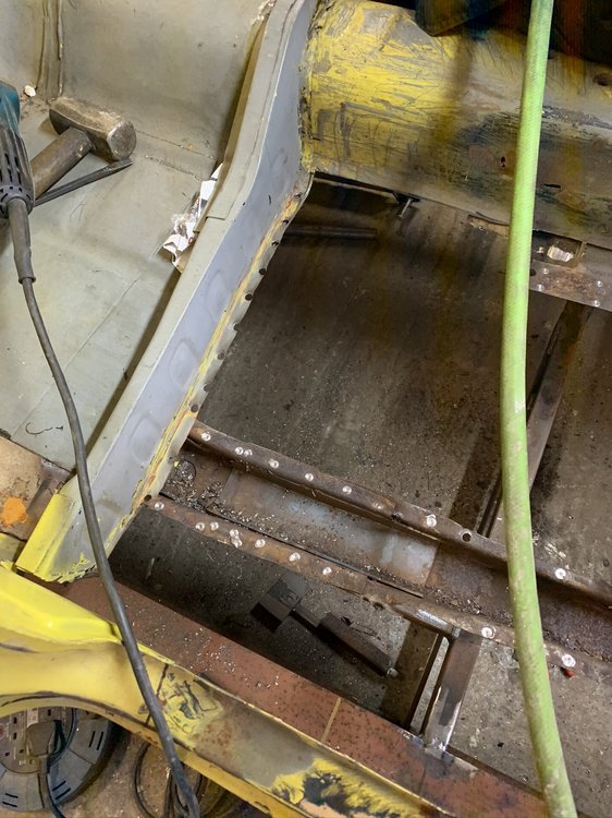

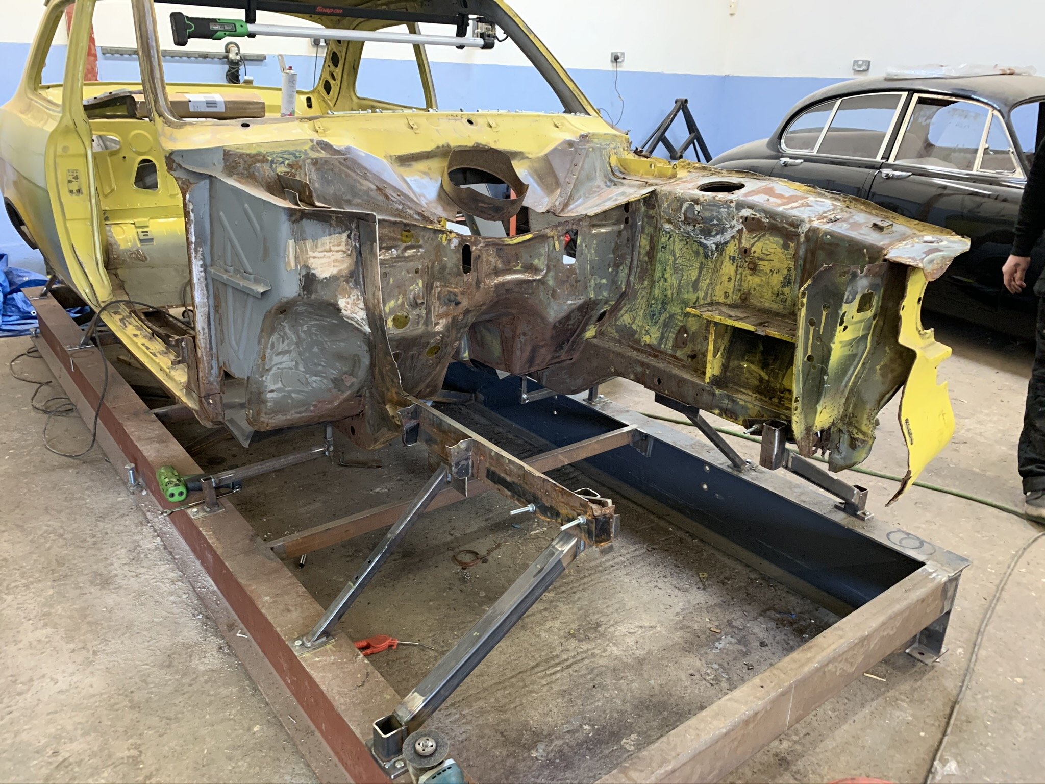

notenoughtime Posted October 21, 2019 Author Report Posted October 21, 2019 Before I start my car I’m doing this which unfortunately the guy isn’t fitting a full floor so I’m left with making good prob more expensive in the long run! Needs floors, chassis rails, inner sills, outer sills, a post repairs, inner wings, upper bulkhead, outer wings, front panel inner and out etc
notenoughtime Posted October 21, 2019 Author Report Posted October 21, 2019 Car came with repair panels and wants them fitted
colr6 Posted October 21, 2019 Report Posted October 21, 2019 Nowt so queer as folk 🤔 would end up a far better job with the full floor option. Would be a no brainer to me rather than fitting 4 pans.

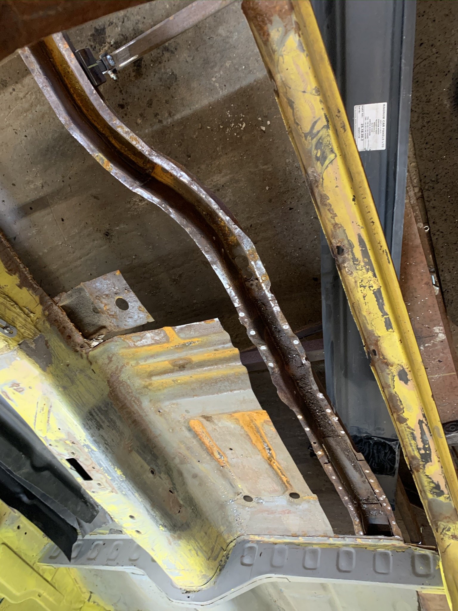

notenoughtime Posted October 21, 2019 Author Report Posted October 21, 2019 I’ve cut rear seat brace and seat crossmembers out so will lose the welds under those sections still an easier job to put a full floor in as comes with inner sills etc

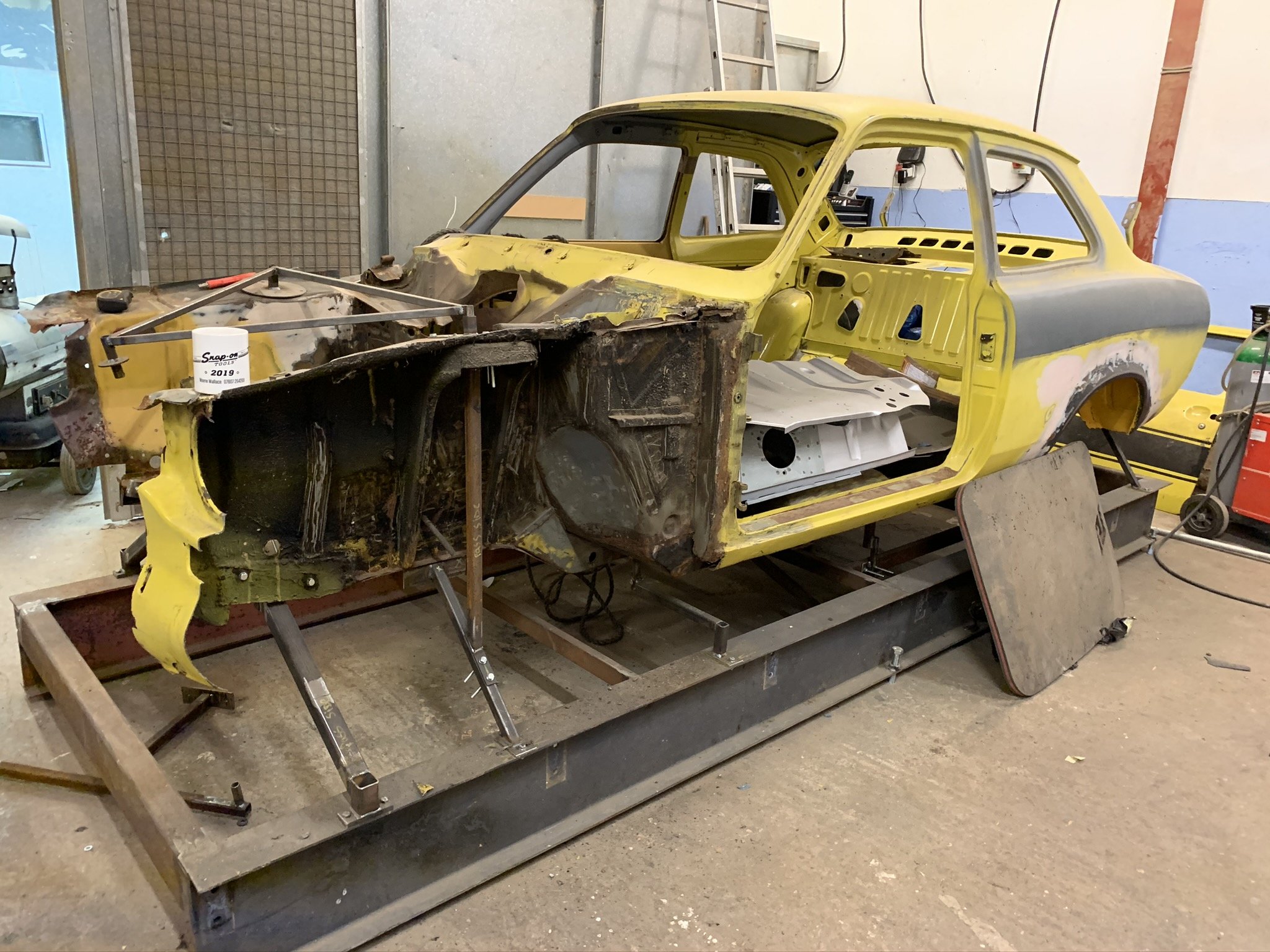

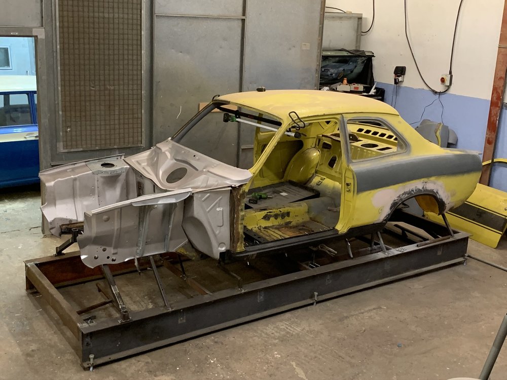

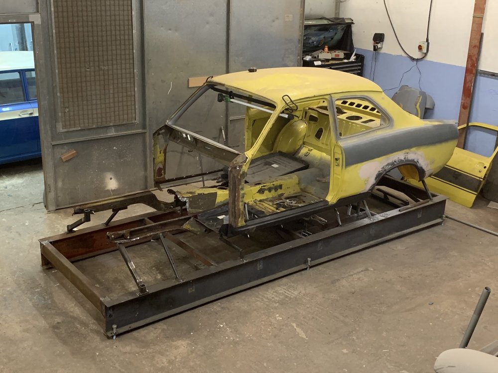

notenoughtime Posted October 24, 2019 Author Report Posted October 24, 2019 I probably should start a new topic but couple of pics of the 1300 Sport today The owner has decided on fitting a new bulkhead luckily New inner wings, bulkhead and upper bulkhead clamped in place, a bit of manipulation and I can start spot welding it back in place 2

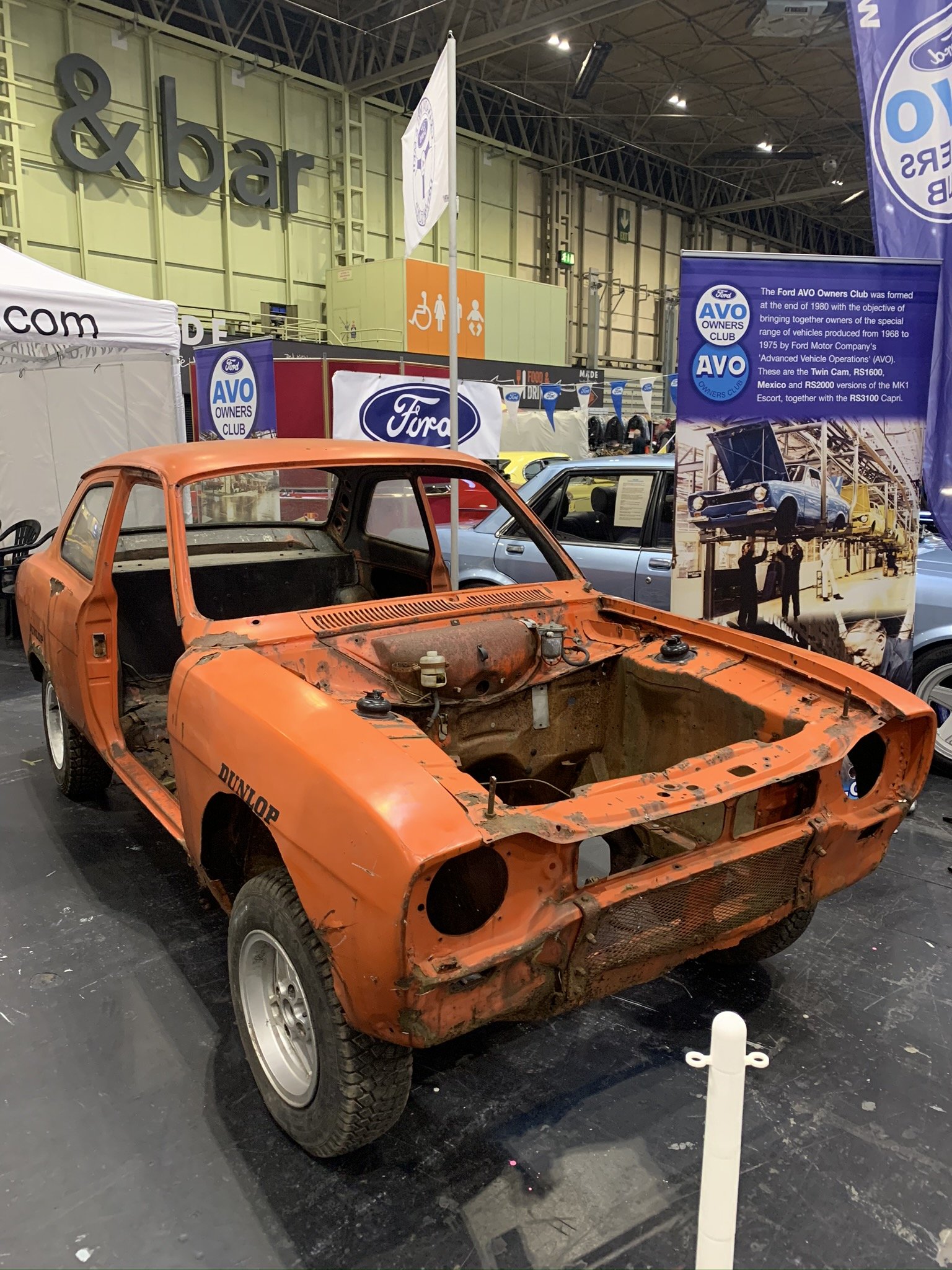

notenoughtime Posted November 11, 2019 Author Report Posted November 11, 2019 I thought I should post a pic of what I’ve bought for the few of you that didn’t make it to the NEC classic car show 1
Monza Posted November 12, 2019 Report Posted November 12, 2019 Saw it at the NEC....looks like an interesting car with a lot of rallying history. Looking foward to the build.Got your work cut out....but then didn't we all!!!Keep the pics coming [emoji106]Sent from my SM-G900F using Tapatalk
