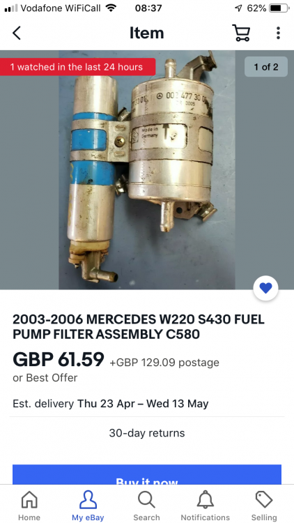

Scortedvan Posted April 16, 2020 Author Report Posted April 16, 2020 Thanks both! Yes I'm not dead set on an 044, they just seem to be favoured when researching pumps. Really i am happy to use anything that can deliver sufficient pressure and flow for standard power. These were the setups i mentioned earlier, one from a w202 merc and one from an early Porsche (928 i think?). Either would clean up well with a new filter, and would mount quite nicely i think? They seem to sell for around £50 complete. Joe
