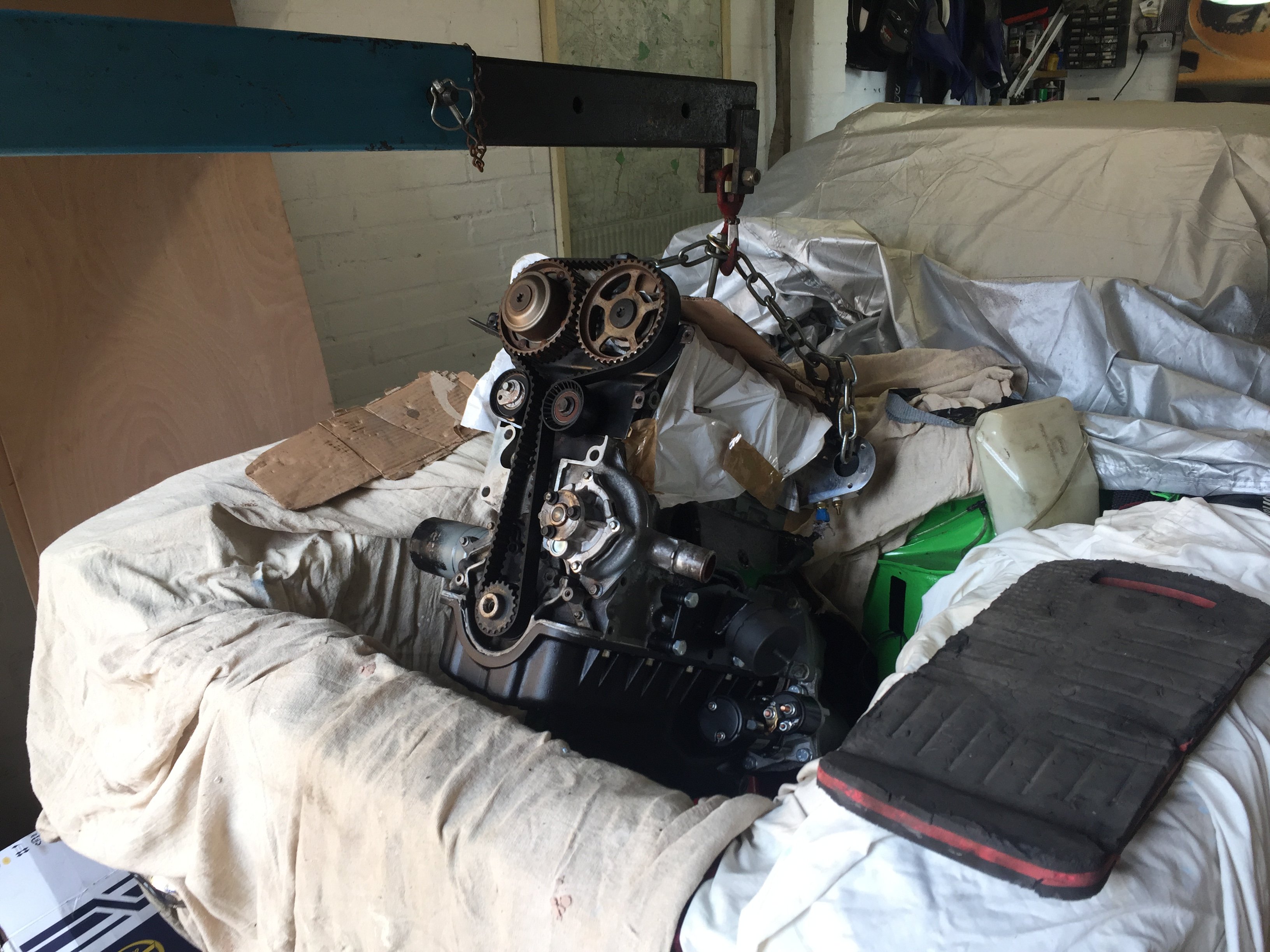

Scortedvan Posted May 9, 2020 Author Report Posted May 9, 2020 Managed to get some time yesterday to get the engine and box mated together and dropped into the car. The grp4 tunnel certainly makes fitment far easier than with a standard tunnel, and im really pleased with the retroford mounts and sump. There isn't much tolerance around the bulkhead and subframe, yet everything fits perfectly. They also look factory finish which is pleasing! The only thing that needs adressing is the gearbox mount which has ended up a few mm from where it sat before but to be honest thats a complete non issue all things considered. One thing that may come back to bite me is my choice if starter motor. All research pointed me toward an lrs707, when using a zetec flywheel. And thats what ive used, but i went cheap and it doesn't seem very good... i did power it up whilst on the floor and it engaged the ring gear and span the engine over but it doesn't fill me with confidence to be honest! Plenty of stuff i can do now, but i do need to save some cash aswell - outstanding items now are exhaust, throttle bodies and engine management so not exactly cheap!

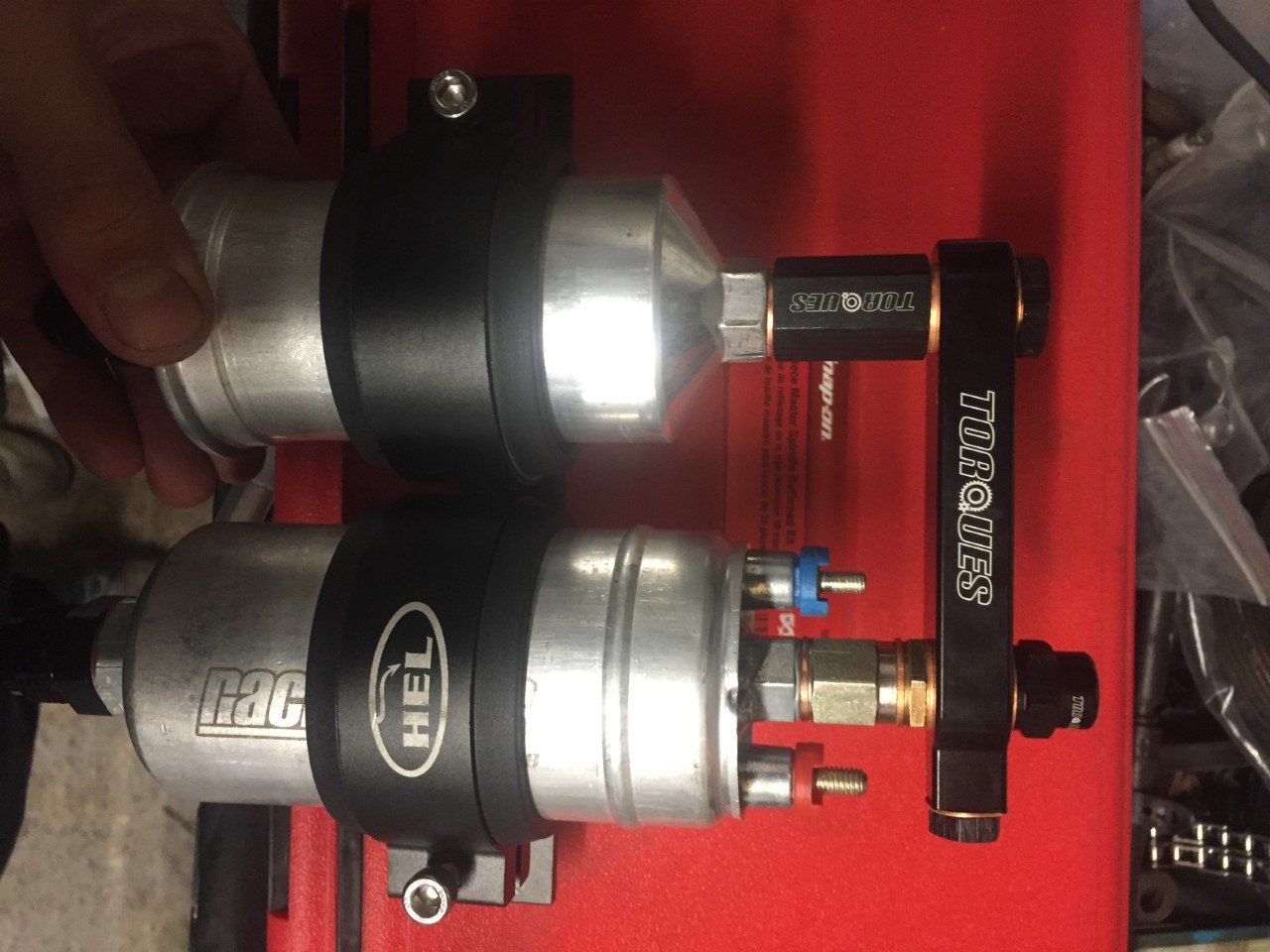

Scortedvan Posted May 21, 2020 Author Report Posted May 21, 2020 HI all, Little bit more progress made! The plan was to complete the fuel system after getting the engine in, so thats what ive been concentrating on. I have the pump and filter fitted in a very nice cradle, and I also got a bit of a deal on a superb pump/filter manifold from Torques_UK (who are fantastic by the way, cant say enough good things about them - everything's next day delivery, everything's quality and he answers all questions). I then started getting the supply and return line ran in, which went well. The black lines and fittings against the green car look really good in my opinion (also in the picture ignore the fact that I only go one of the P Clip eyes over the bolt I noticed after looking at the picture I took and sorted it!). The lines are in the engine bay now, just need to decide where the regulator will sit. I really wanted it on the bulkhead by the brake res, however there may not be enough room, and it may end up living on the inner wing. I need to work that out. I also got the return line fitted into the sender which is great, to be sure i half filled the tank with fuel and hung it upside down so the sender was the lowest point and nothing leaked (better safe than sorry!). I also sorted the supply to the pump fitting but this I'm less happy with. Its fine, it doesn't leak, but I really want a proper adapter. So being unable to locate one, I've commissioned a company to make them. I have managed to muster some interest on another forum, so I should be able to sell a couple to cover the minimum order cost of 10. Finally one thing I wasn't expecting to get this month was a set of throttle bodies, which also came up at a very respectable price (half what I expected to end up paying). They are from a Hayabusa and came with a manifold to suit and the injector harness. Next steps now will be to wait for payday! And then order the cooling system parts I need. I'm going to use RF pipes, although costly, it will be nice to just have them fit without messing around.I am still trying to source an expansion tank that I like, lots on ebay but I just haven't seen one that I think will suit properly yet. Id like a cylindrical one that I can get tucked into the nearside corner really. I am half thinking of running waterless coolant and no expansion tank, but ive also thought there are some fundamental flaws with doing that so im undecided as yet. From that point, I will just need engine management and an exhaust - everything else should be done! I had the engine turning over on the key the other day which was good to hear, though I still need to put a cam belt kit on it so it was only a brief flick! 1
