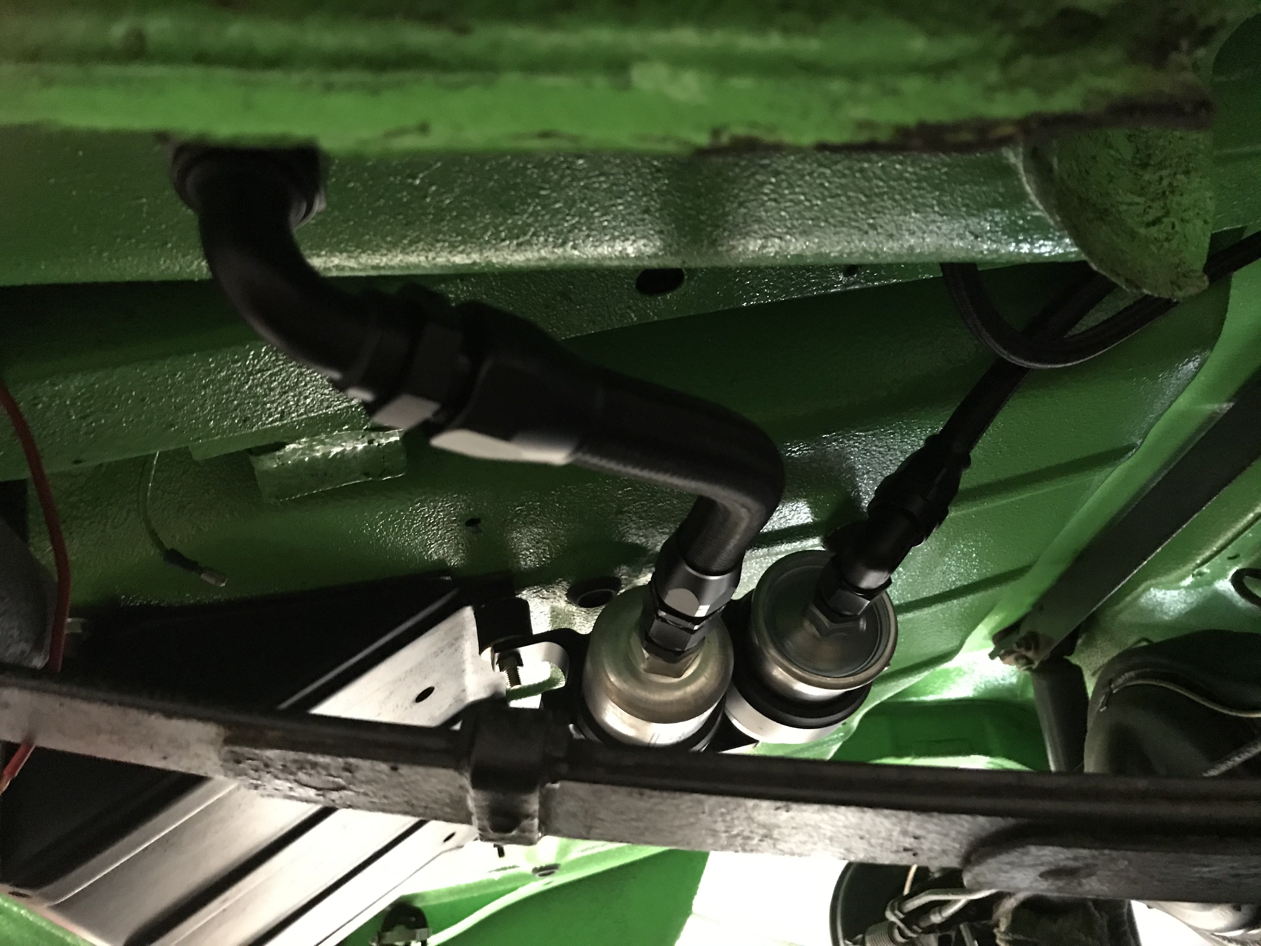

Another week and a bit more done. The fuel system is complete now, the nylon braided teflon lines are all in up to the regulator which i have had to put on the o/s inner wing due to the throttle bodies making bulkhead mounting difficult. The outlet from the tank will suffice for now, but i have the technical drawings back for an adaptor, I'm just waiting on making an order as i need to order 10 @25 a go!

I have also managed to prime the fuel system to check for leaks and ensure the static pressure is correct. Thankfully no leaks were present and i got a nice steady 3.2bar which should suffice. It was really nice to hear the pump run actually, with that and the engine cranking from the key now it feels very close to being complete.

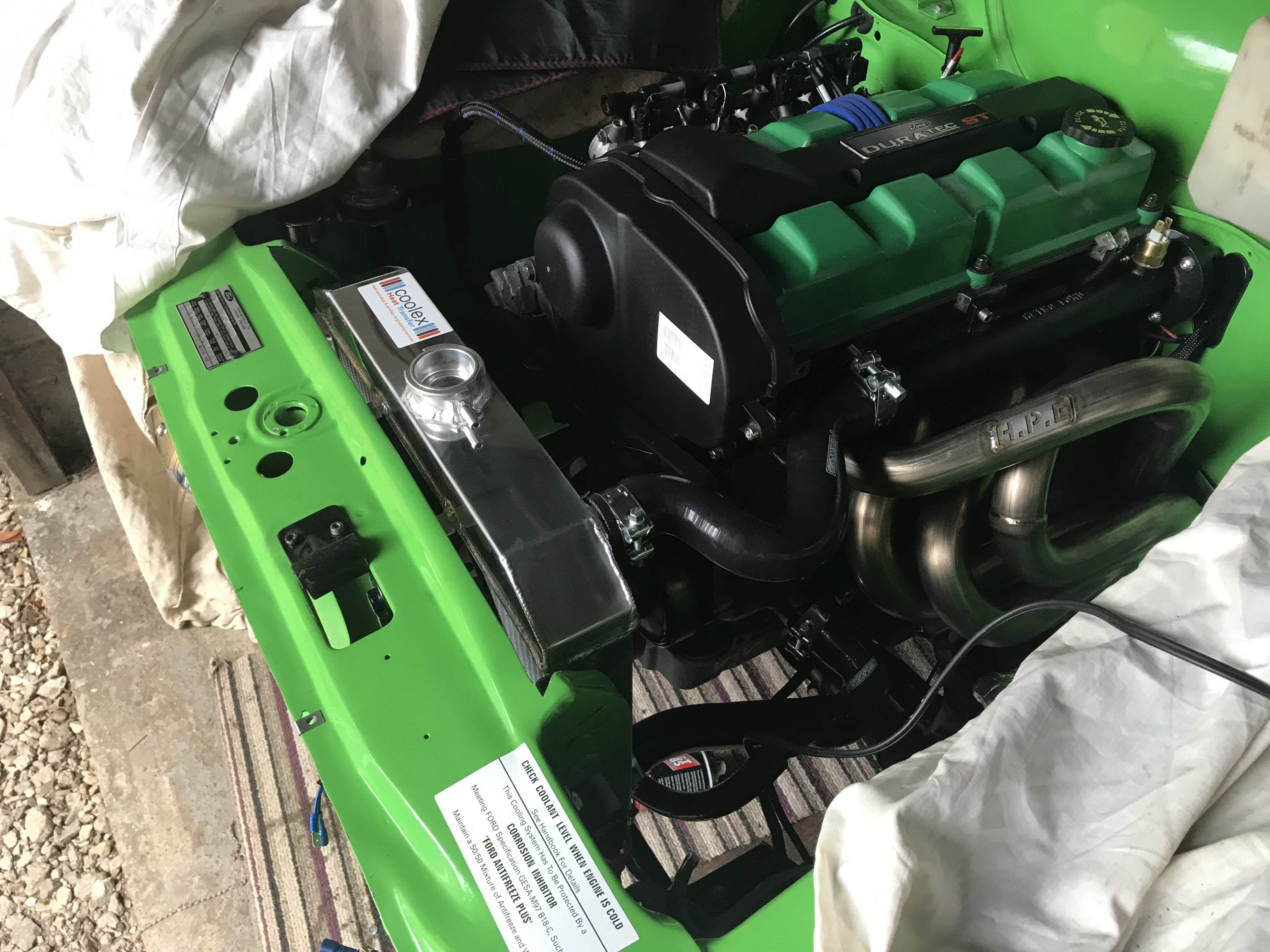

One of the more exciting packages arrived today - the exhaust from HPE/Piper. It took a little under a week to arrive which is pretty good considering everything, and was packaged really well. Ive had the manifold and 2 1/4” system.
I immediately offered the manifold up, as i have been looking at the gap the down pipe has to fit through, and to be honest i couldn't see this bit being straight forward, especially after previously trying an ashley  manifold which (no exaggeration) did not fit anywhere, even the head flange was bent and the holes were out. I neednt have worried though, it fits perfectly! I dont think it could fit any better if it had been made on the car. Its absolutely perfect. And the rest of the system was just as simple, it all just slid together in no time and hung perfectly. You also get a cotton reel mount for the centre pipe which i think mk2s use, for the sake of 1 hole in the rear floor pan i will fit this as it will make the hole thing much sturdier, not that it really needs it.

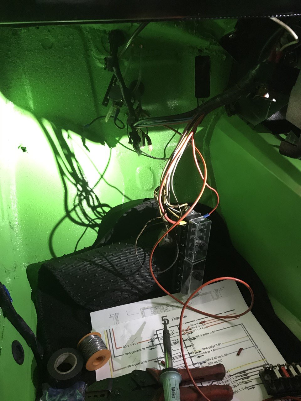

Yet another small update! I'm just working through a few little bits that are outstanding whilst I wait to have enough cash saved to buy the engine management. This time it was the wiring. Firstly where I moved the original fuse box to inside the passenger foot well, there wasn't much spare cable to fit it nicely anywhere, plus it was pretty fragile anyway so I replaced it with a standard blade fuse box. This has enough spare slots to take the output from the fuel pump relay, and also a main relay output to power up the ECU on ignition on. I needed to extend the cables that originally connected to the fuse box in the engine bay, but the rest were ok. I just need to tidy the wiring up to it (still pretty messy in the pics) and fit the cover for it, then find somewhere neat to fit it permanently, initially I'm thinking under the dash out the way. Then the ECU and relays can live there aswell. The wiring to this fuse box I've done exactly as standard with the fuse positions the same as they are in the original fuse box, so the original wiring diagram is still applicable. This means the fuse ratings can be kept the same (the 20A fuses in the pic were all I had at the time so I could test).
I also got hold of a battery terminal fuse box from a Renault Megane Scenic, so that I can fuse the main power line to the front of the car, and also the independent battery lines (one for the fuel pump relay and one for the main relay). This is really neat and I've been meaning to do it for ages. Its silly there never was a fuse to the front but this was how I bought the car and I never got round to sorting it before.
So I'm very close to the end of the actual work at this stage... i still need my radiator back (6 weeks to swap the inlet and outlet connections over and leak test it!) and then the front of the car can go back together. Then the management fit, should take long as I'm preparing the connections for it in advance, then hopefully start it and go through the preliminary checks and snagging...  and then hopefully I can get it over to NMS for mapping!
Don't tuck the fusebox too out of the way - last thing you need beside the road having to stand on your melon to find a popped fuse! Top of footwell, high on inner wing / scuttle - discrete but out of the way?
Yeah, no doubt where ever I put it, it will be easily accessible. Although I should need to look at it far less often than I did with the ceramic fuse box, a ritual on the car used to be to re tension them! Behind the dash is very much 'open plan' in my car so I can get to it fine. Though in general I must admit, I am a sucker for trying so hard to hide things away, I make life more difficult  :)

Hi all! Pleased to say im almost at the end now with this project in terms of buying and fitting parts. One thing thats been causing an unnecessary amount of grief was my radiator.. which as ive mentioned through the thread has gone awol at the hands of a guy i shouldn't have trusted. So looking for a replacement the obvious choice was one from RF as ive used their hoses but they are insanely expensive. So a but more searching and i found a company called CoolExperts that basically custom make radiators for mk1/2 escorts. Theyre superb, they offer different size cores, with/without fans and fillers, with/without fan switches etc. So i ordered a 55mm core rad, with inlet and outlet on the pass side, with a 10”cutlass fan - £190 delivered! Very pleased with it, and the fit is great considering i don't have the cutout lower panel.
Im yet to fill it with coolant as i still need a length of 8mm hose for the degas pipe but once that arrives i can fill it and run it properly! Im hoping to have it ready for mapping in September so fingers crossed..

Well, the end of this project is incredibly close now im pleased to say! The expansion tank which was the last part i was waiting for arrived the other day, plus a few clips and bits of hose. This allowed me to finally fill it with coolant and run up to temp. Pleased to say there were no coolant leaks at all, although the system is pretty straight forward and ive not coupled multiple sections of hose together, so the only joins are where each pipe ultimately terminates.
At this point i actually felt pretty nervous, i knew it started but its almost like i was putting off running it up. After multiple checks I put a couple of jerry cans of fuel in the tank, and flicked the key. I had the laptop connected so i could make some aterations and monitor temps etc. The only things i needed to tweak on the base map was the injector flow rate, the base map was set at 300cc/min and this made the thing run mega rich. I took this down to 220cc/min and its much happier, but this will all be set correctly when i take it for mapping. I also dialled the fuel pressure up a bit - ideal is 3bar and mine was closer to 2.5bar when running. Otherwise... happy days! No leaks of any sort, and the fan cut in  at 100c and bought the temp down to 92c where it then dropped back out. I let it cycle like this a few times, and it was perfect (also bare in mind the ambient temp was 32 and i ended up seeing intake temps of around 45+ so it was working hard!).
It was a little lumpy when just off idle and whilst revving and the throttle bodies id only breifly checked by gapping the butterflies so i stuck the balancing kit on and synced them up and this made things even better.
So with confidence at a high i decided to see if it would let me drive it out the garage... and it did 😎 It was also good enough to let me pin it down the road very very briefly! It was fantastic to feel it move itself and even on the base map it just felt very torquey and responsive. And again no issues, everything just worked. So for now, i just need to get it over for mapping and at some point get a proper air filter for it, im using filter socks at the moment but they dont really fit very well.
Hopefully then, the next update will be the rolling road result! As i said at the start of the thread, im not bothered about chasing numbers, but its always nice to see a result. I just want a strong reliable setup.

Oh and i also found a neat little pre filter i can fit in the An-10 connection from the fuel tank to the pump - the original ford in tank filter wont fit where i modified the tank adapter and its bothered me that i had nothing, so quite pleasing to find this. It was around £4 from Torques UK.
