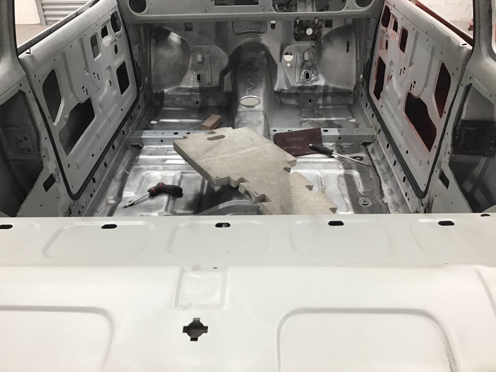

kev the rev Posted December 8, 2021 Report Posted December 8, 2021 as above gona bite the bullet and go for a full new floor pan in my mk2 escort rs 2000 , but which one is good qaulity and good fitment all replys appreciated
