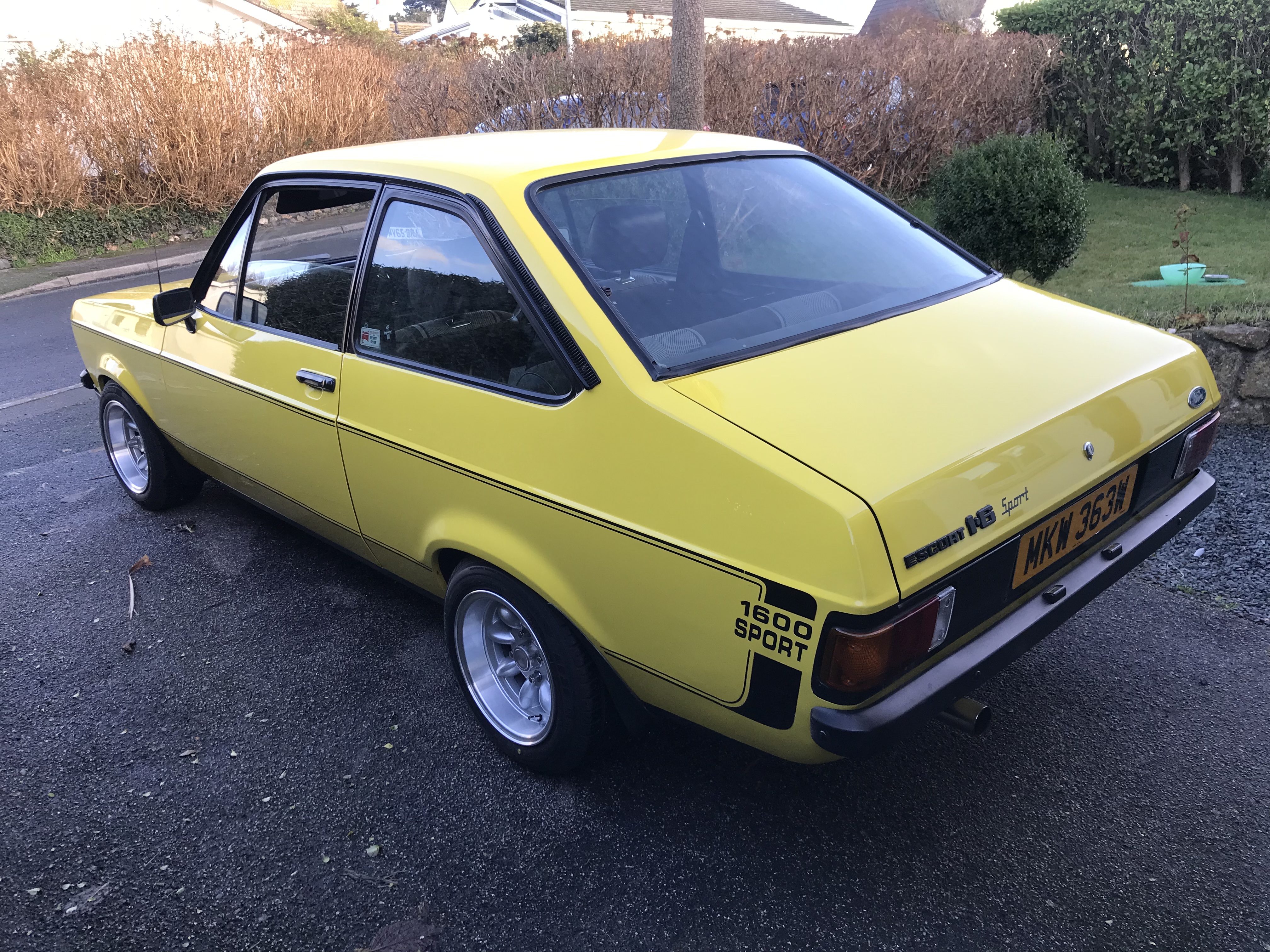

On 08/01/2023 at 12:00, Nige65 said:
Bought this late last year, really happy with the condition of it, just a little bit of tidying needed.
The tyres were shot and the original steel wheels needed refurbishing so changed them both.
It’s a bit of a pain to start but I’m putting that down to the 32/36DGAV which I will probably replace if I can’t resolve the issue.
 Thanks to James (RP) for the info, it’s a February ‘81 car, it also came with the rear window Louvre which is in really good condition, not sure if I will refit it so might be available in the future.
Nige.
