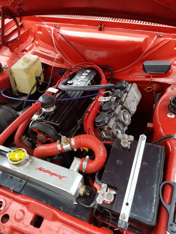

Fitted new bike pump. All ok and started straight away. Interesting the old pump was dead when in the car and ok when put across a battery. Made all new connections so should be ok. Fitted a thermostat from a mini that opens at 72 degrees. Had to reduce diameter with the angle grinder by about 3 mm to fit. Got the electric fan to switch on as well so getting ready for a bit of winter time motoring. The 12v solenoid that operates the bike carb choked failed again I think it's not man enough for the job. A more heavier duty one has been sourced.
So,fitted better solenoid to operate the choke and appears all ok.fitted some large plastic trumpets with no air filters.its amazing how big a difference different air filters can make to bike carbs. Going to the rolling road 28th October for setting up at the Moseley old creamery garage. Car runs better with mini thermostat which opens about early 70 degrees.heaters are nice and warm.

So, fitted new throttle cable and has a lovely smooth operation. So went out for a blast on some wet n greasy roads it's amazing how easy the back end steps out Shame the electric fuel pump failed 1 mile from home in the pissing rain.mrs not too happy about towing me home. Need to buy a better quality bike carb pump.for now we are on the road. Bugger
So, the bike carbs are up and running, I made some air filters as a temporary measure using tomato cans cut in half , section of mesh over the opeining and then some ramair filter material over the top. Does the job at £9. Fitted an electric choke using a £5 solenoid onto a switch, nice. Need to improve the throttle cable attachment as i have to much play in the set up , will sort it this weekend. Overall the sound is better , idle is better and pick up is smoother. Too early to say if the performance / mpg has altered as i need to get the timing sorted once i have the throttle cable sorted. Overall though its an easy conversion.

Fitted mikuni bike carbs to the pinto escort today. Quite an easy conversion and runs very well. Just need to sort some air filters and relocate the oil catch tank
