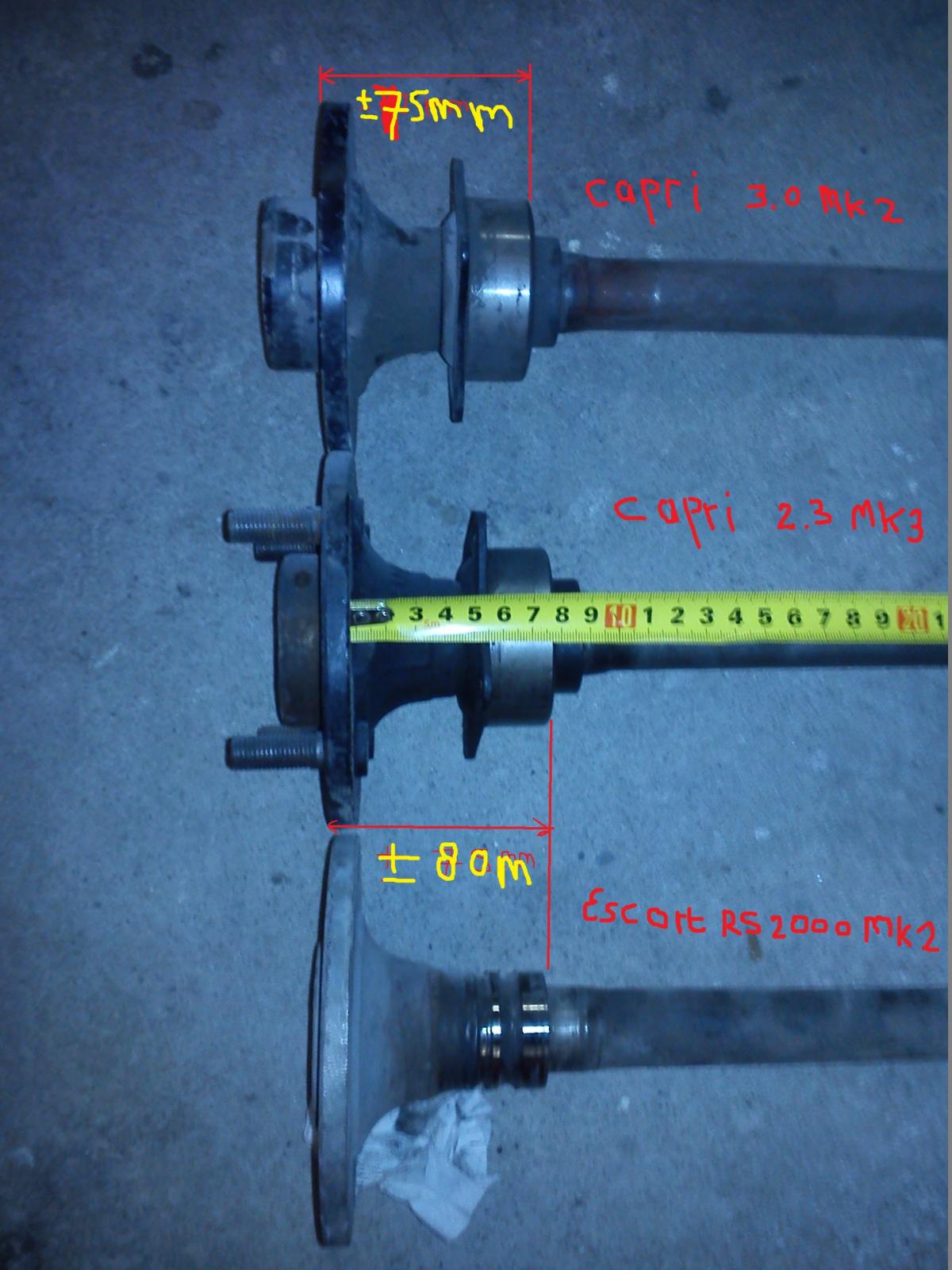

John escort mk1V6 Posted January 8, 2015 Report Posted January 8, 2015 I did have `74 capri mk2 3.0 drums 9 inch [cologne] , heavy ones and the backplate is also further to the diff [5mm]. And now i have capri mk3 3.0 drums [cologne] on mine escort mk1 with escort mk2 axle/pipe`s [cologne] , and they are thinner/lighter. And the diff from a capri V6 cologne and at the moment capri mk1 half shaft , did i make a litte shorter and the splines longer. These differents are also seen on the capri mk1 axle`s , i have them both. And i am not sure if the backplate patern this 100% the same , from a escort cologne axle and a salisbury. And if i am not wrong the centerhole/bearing is bigger from a salisbury axle.

John escort mk1V6 Posted January 8, 2015 Report Posted January 8, 2015 Hi Jon , i have the 3,0 capri mk3 drum on mine , but i almost sure that you will need to place a spacer between the drum and axle , becourse the off set from a escort is 5mm sorter than from a capri mk3 , ohterwise the drum comes against the back plate. The drums with back plate from a mk1/2 capri can work , but need work done bolt pattern. bearinghole. And then comes the wheel more to the out side 3mm , becourse the drum are thikker.

John escort mk1V6 Posted January 8, 2015 Report Posted January 8, 2015 If the capri 9 inch drums are same as the rs2000 , i got them on the 1300 escort mk2 cologne axle , but i did need to use a spacer between the drums and halfshaft , if mine mind is right. I will check it to night with picture. Sorry to confuse you , but it must fit trommels with backplate capri mk3 3,0 on a escort mk2 RS2000 , but on a base model [small cologne diff] i don`t think so.

classicwhitey Posted January 8, 2015 Report Posted January 8, 2015 im building a new axle at the moment with mk3 capri 3 litre brakes. pad diametre is 56mm with 9 inch drums. the bracking surface inside the drum is 64mm once mounted the back plates sit 16- 17mm towards the diff.
