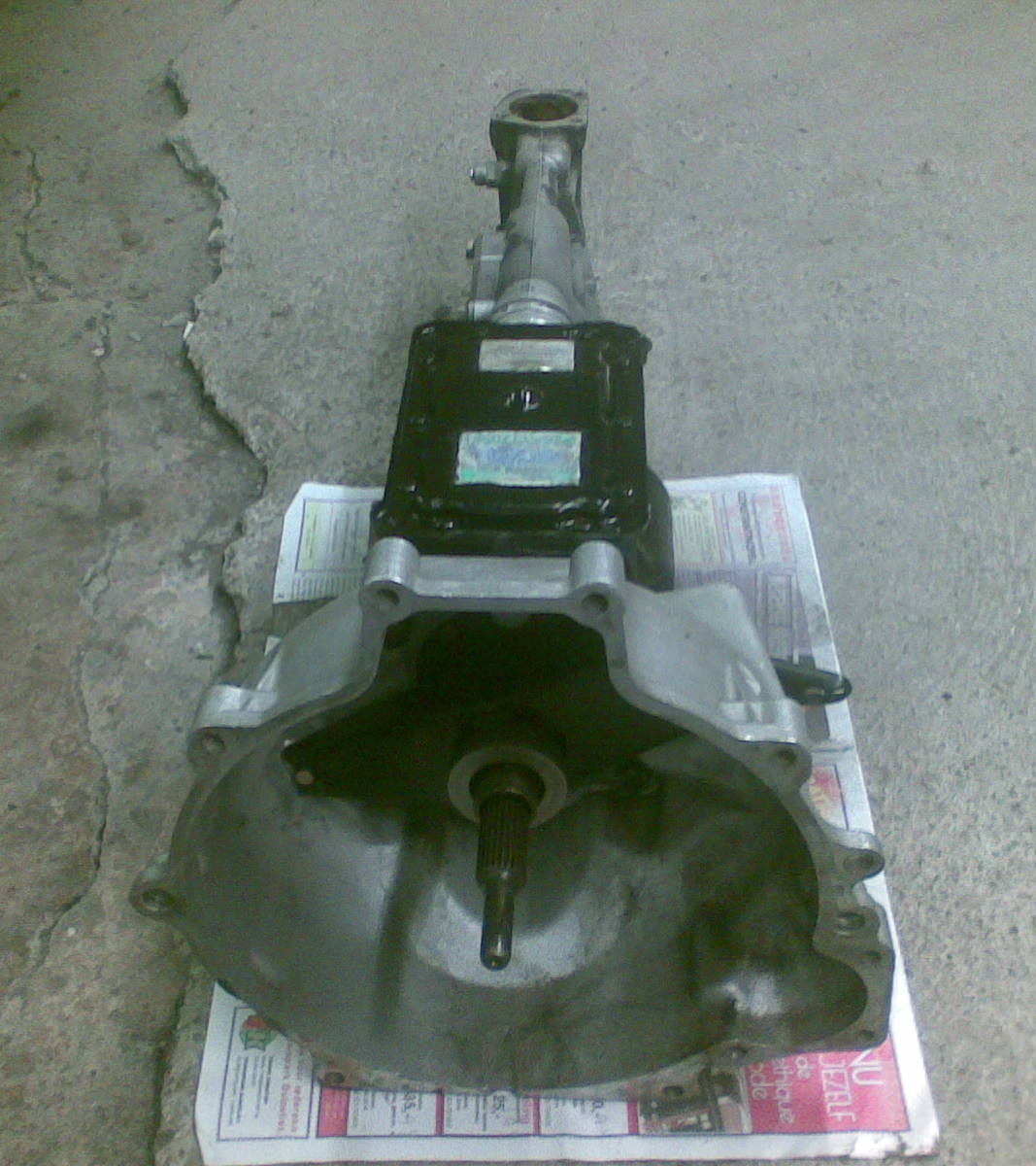

Bigfish Posted January 29, 2016 Report Posted January 29, 2016 afternoon can anyone tell.me if this box is the v6?
John escort mk1V6 Posted January 29, 2016 Report Posted January 29, 2016 No thats a 4cil gearbox with a 4cil bellhousing , this is a 6cil sorry.

colr6 Posted January 30, 2016 Report Posted January 30, 2016 Box should be 1" 23 spline, so should be clutch plate used. Another thing that would stop it going together is incorrect / damaged spigot/ bearing very mis aligned clutch.
deltamal Posted January 30, 2016 Report Posted January 30, 2016 V6 is type 9 with a long input shaft, it should project beyond the belhousing, 23 spline.
