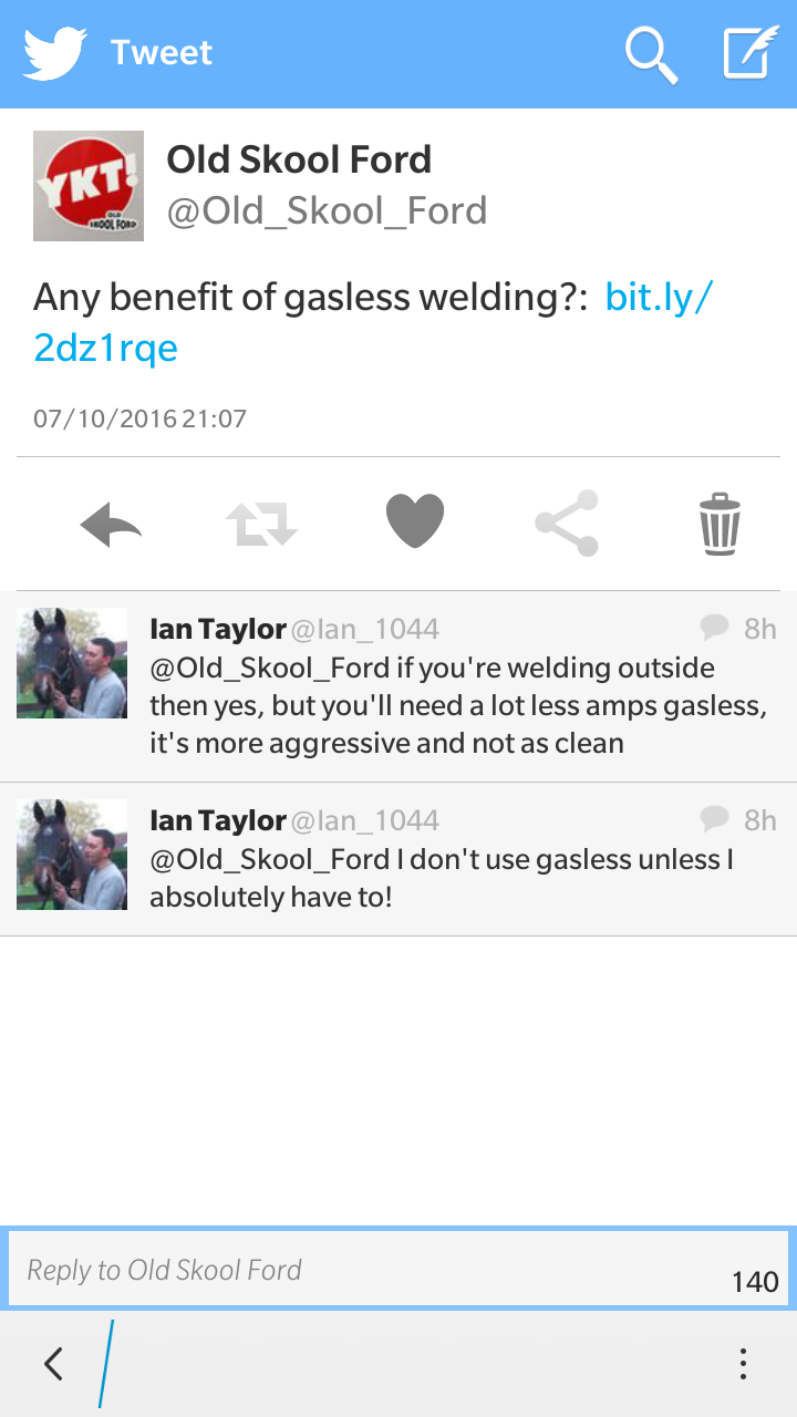

Admin Vista Posted October 8, 2016 Admin Report Posted October 8, 2016 A couple of responses on our Twitter feed for you 1

BTM_FDR Posted October 8, 2016 Author Report Posted October 8, 2016 Thanks for that Vista, helpful as I don't 'do' social media haha Thanks Jas, it seems the lower the ampage, the cheaper the welder in most cases. I'm not trying to be a cheapscate, just finding my options Gnar
