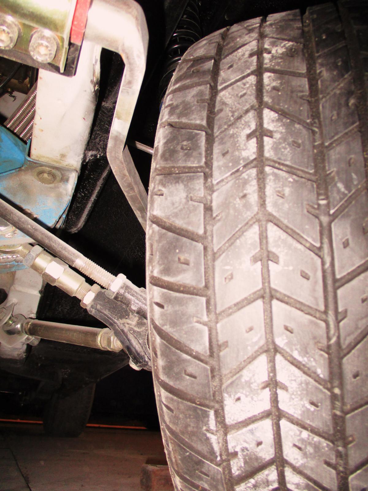

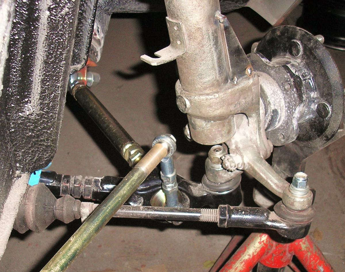

This a foto from mine mk2 estate , mk2 short steeringbox with the mk2 RS2000 rod ends and with the Capri legs.

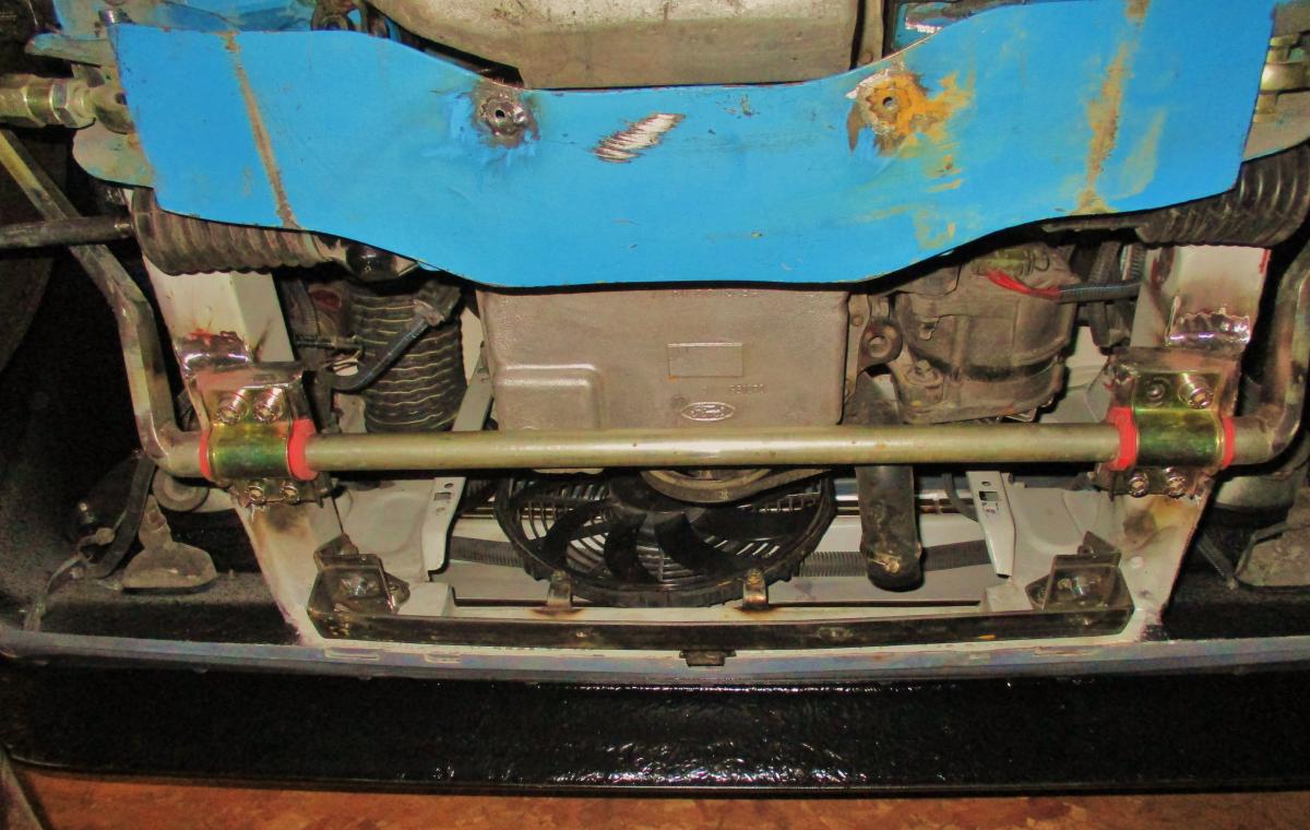

Where did your anti- roll bar and drop links come from ?
I believe that i bought the droplinks may be at burtonpower /anti-roll bars at gpr4 fab  or at rally design i did extend them to make it fit.

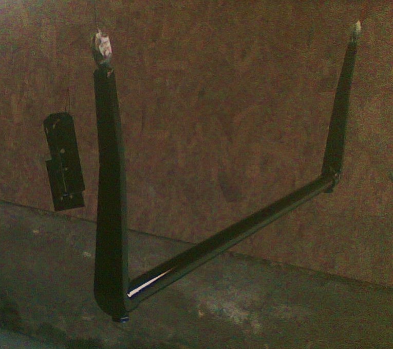

But the are to weak for mine taste , they are normal used with very hard coil-over and special shock absorbers , so i have made a other anti-roll bar with parts from rally design from a race siërra [8g bar]and make the bar shorter and bend the arms that going to the drop links , i have weld this together instead of bolting , much better.
I have this done for mine mk1V6 and for mine estate.
I wonder why you consider them too weak? They aren't a structural suspension component and aren't carrying any direct suspension loads. You have the substantial compression struts, modified TCA's and beefy struts, so hub is well triangulated - the links will be transmitting very little force and in compression generally and so will be  using steel's strongest medium?
I took as an implication that the anti- roll bar resistance not been strong enough as against actual strenght of the bar in mounting purposes.
What i meant is the body roll it`s got with the thin anti-rollbar , i want a go-kart feeling and not a old Citroen feeling.
I drove a little bit with anti-rollbar and i didn`t like it so i did place the old 22mm Capri one that did make fit before and started to order and build this one and i like this one better.
I understand that a soft/weak anti-rollbar gives more road contact and i think thats more a rally car feeling and i want more a race car feeling.
