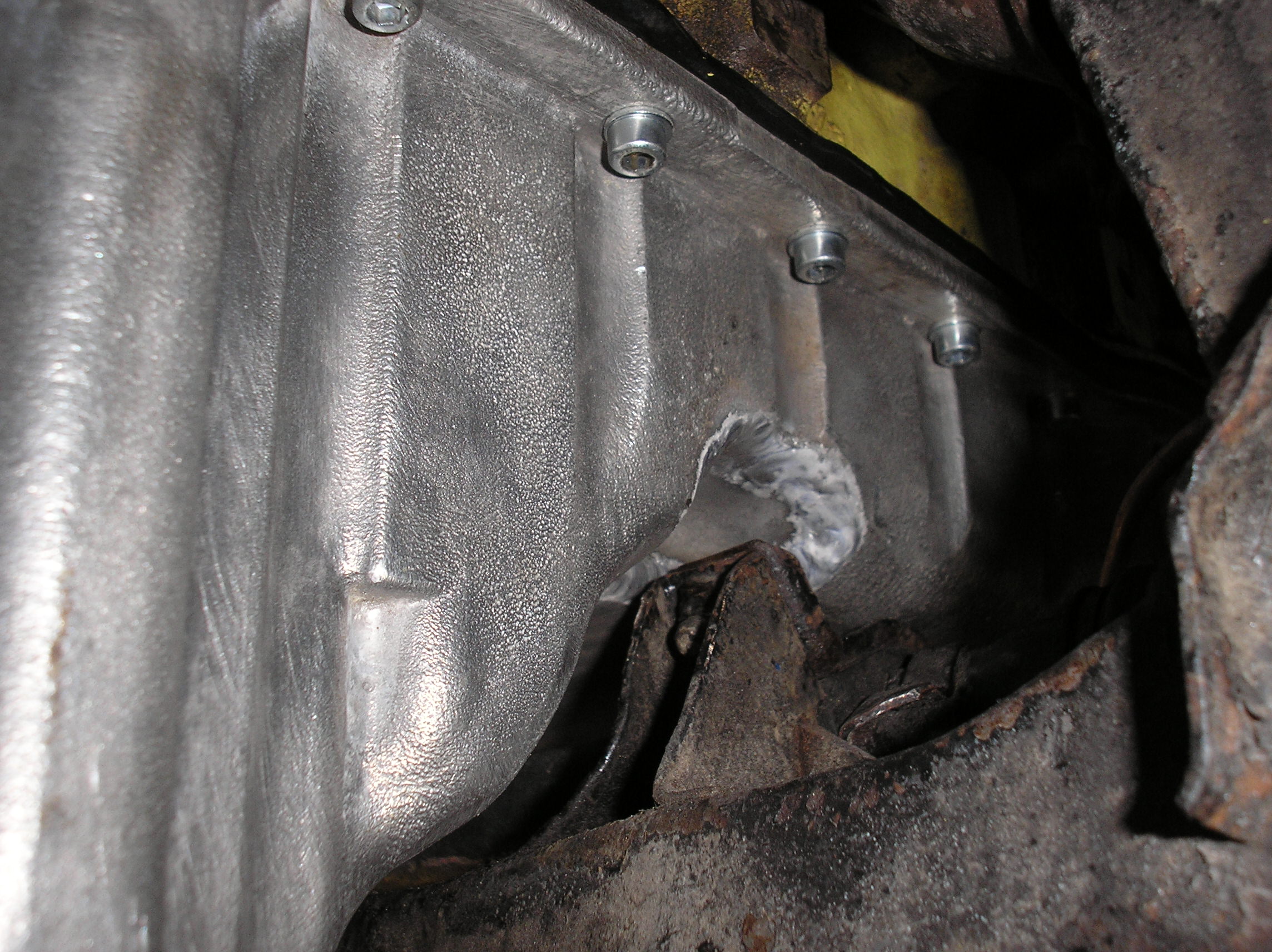

John escort mk1V6 Posted September 26, 2017 Report Posted September 26, 2017 It fits , the alloy one is thicker and heavier , and also just must close the two holes on the side`s. And you better can take the 4 piece gasket , with glue.
BROWNY 1968 Posted September 26, 2017 Author Report Posted September 26, 2017 16 minutes ago, John escort mk1V6 said: It fits , the alloy one is thicker and heavier , and also just must close the two holes on the side`s. And you better can take the 4 piece gasket , with glue. that's good to know john, did you modify the pick up pipe or use the cossie oil pump and pick up pipe ?
John escort mk1V6 Posted September 26, 2017 Report Posted September 26, 2017 No , i do use the original pick-up pipe.
BROWNY 1968 Posted September 26, 2017 Author Report Posted September 26, 2017 thanks for your replies john, don't think I will need to modify mine to fit like you have, plenty of room under my transit, will make some plates up to cover the oil return holes at the back on the sides cheers browny
John escort mk1V6 Posted September 27, 2017 Report Posted September 27, 2017 Your welcome Browny , i don`t have very much space in mine escort , so the oilpan did some modification , cheers.

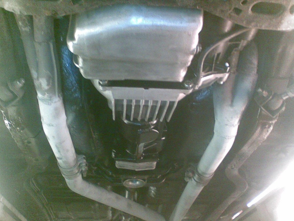

John escort mk1V6 Posted September 29, 2017 Report Posted September 29, 2017 Yes , it was a bit of trouble , it`s a Granada mk3 2,8i EFI but not complete , so i bought the k-jectronic from a mk2. And it`s getting very hot , but i have already a bigger radiator , but it`s not so easy to install becourse i have than also a bit of bodywork to do. But a triple weber kit was a better choose , and more powerfull.
BROWNY 1968 Posted September 29, 2017 Author Report Posted September 29, 2017 kool. that does look very tight in there, triple webers sounds like fun will keep this thread updated as I get mine back together cheers
John escort mk1V6 Posted September 30, 2017 Report Posted September 30, 2017 13 hours ago, BROWNY 1968 said: kool. that does look very tight in there, triple webers sounds like fun will keep this thread updated as I get mine back together cheers Yes , but now i think of it , i think that the oilpan doesn`t fit on a 2.0 V6 , these got a thinner crankshaft.

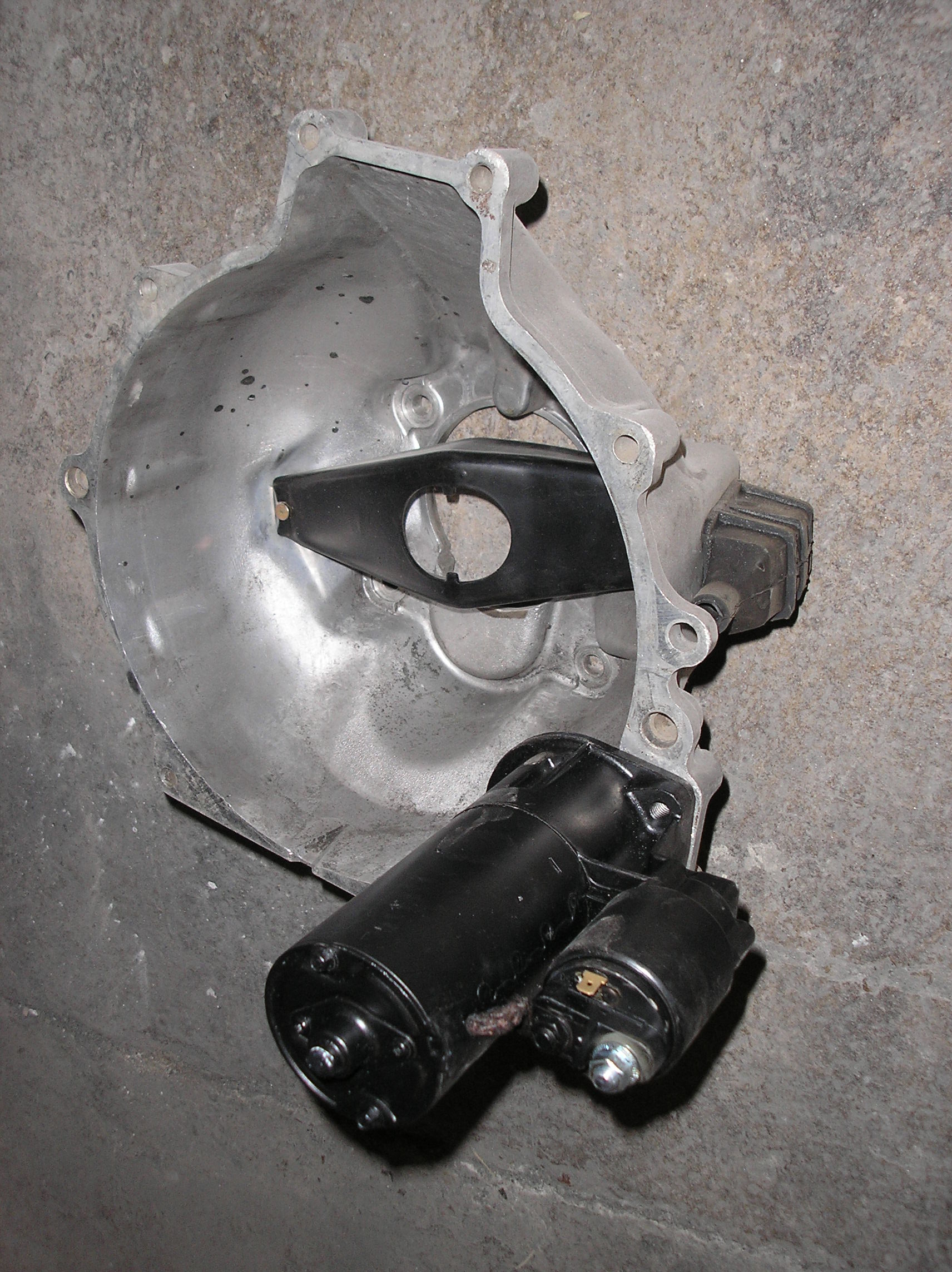

BROWNY 1968 Posted October 1, 2017 Author Report Posted October 1, 2017 got the sump bolted on today john, mine is a 2.8, looks like I need a smaller starter motor though, mine is too big cheers.
John escort mk1V6 Posted October 2, 2017 Report Posted October 2, 2017 You can take starter from a 2,0 V6 cortina , capri , Granada mk1/2 , but also from a Granada mk3 2,8 V6 these are thinner , than the fatter capri/Granada 2,8. http://www.ebay.nl/itm/FORD-CAPRI-GRANADA-SCORPIO-SIERRA-2-8-2-9-V6-PETROL-NEW-RMFD-STARTER-MOTOR-/272301747375?hash=item3f6672ecaf:g:xRIAAOSwRJ9XgLaJ You can also take the 4x4 bellhouse with that starter [3 bolts mounting] In this case you will need the metal plate or a-just the old one.
