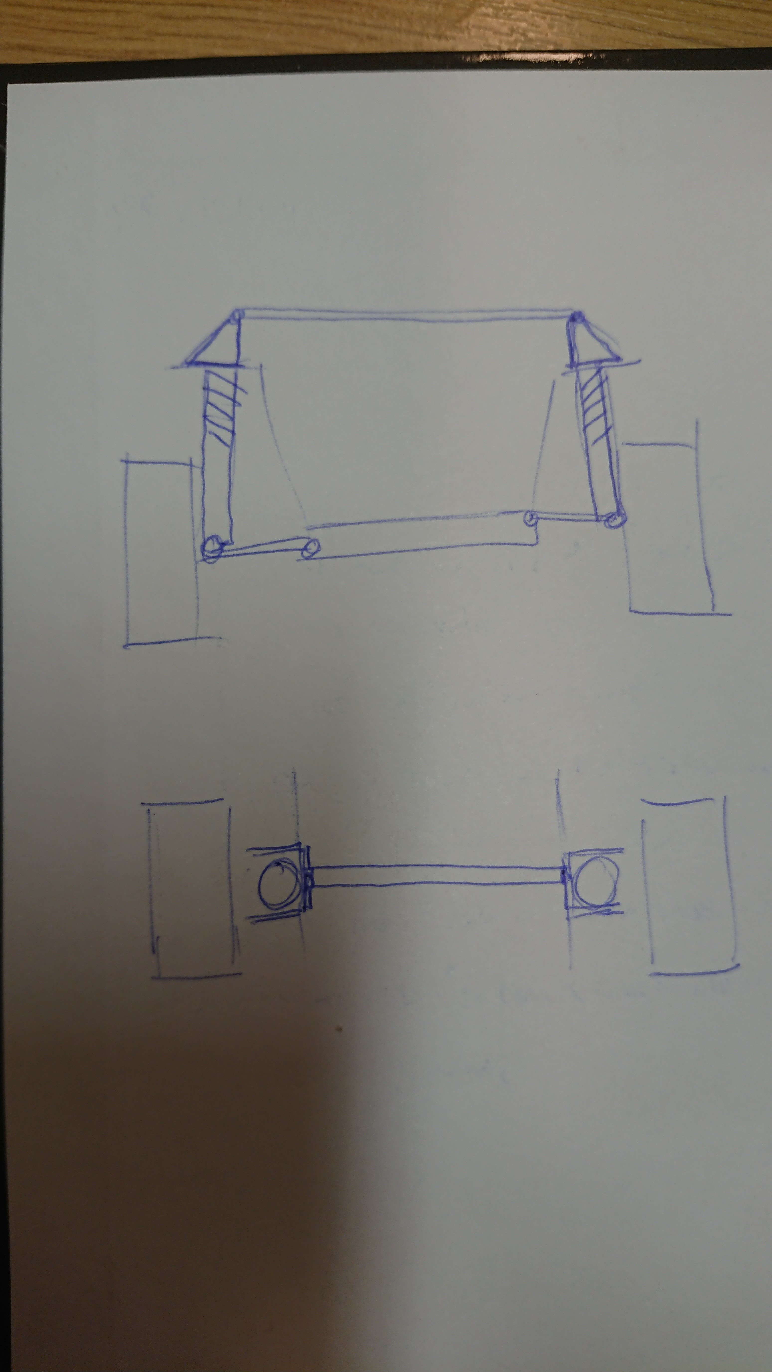

Surely, it would be easier (from an install and maintenance) point of view to build tower extensions and go over the top. If you use triangulated tower extensions, you should get a good transfer of the forces into a bar between the two tower tops. You're just trying to stop the tops of the struts moving. Of course, that all pre-supposes you've enough clearance to go over the top....

Thanks. Yes, an egg can be strong. But, only when it is whole. What happens when you cut a shell in half...? As you say, you'd need to brace it. I was suggesting bracing at the strut tops, as this would be relatively easy - could use a nice simple bar. I've attached a really (crap) simple drawing to show what I mean (I didn't draw the engine). Of course, I may have missed something - someone please point out the obvious!
Anyway, you're right about movement. I'm pretty sure the struts will be fairly vertical, maybe a few degrees off, so there shouldn't be too much horizontal force at the strut tops (hence most cars don't come with a brace as standard...).
2 hours ago, Jimbonic said:
Hi Katana,

Actually half a sphere will be as strong as a whole as the load is equally distributed down to the cut diameter! Its when there is a crack - that's when the pressure finds the weakness and it fails. Anyway a brace is more a style thing for most and isn't needed but it won't harm and if the owner wants it - why not, even if any benefit can be seen or not!
