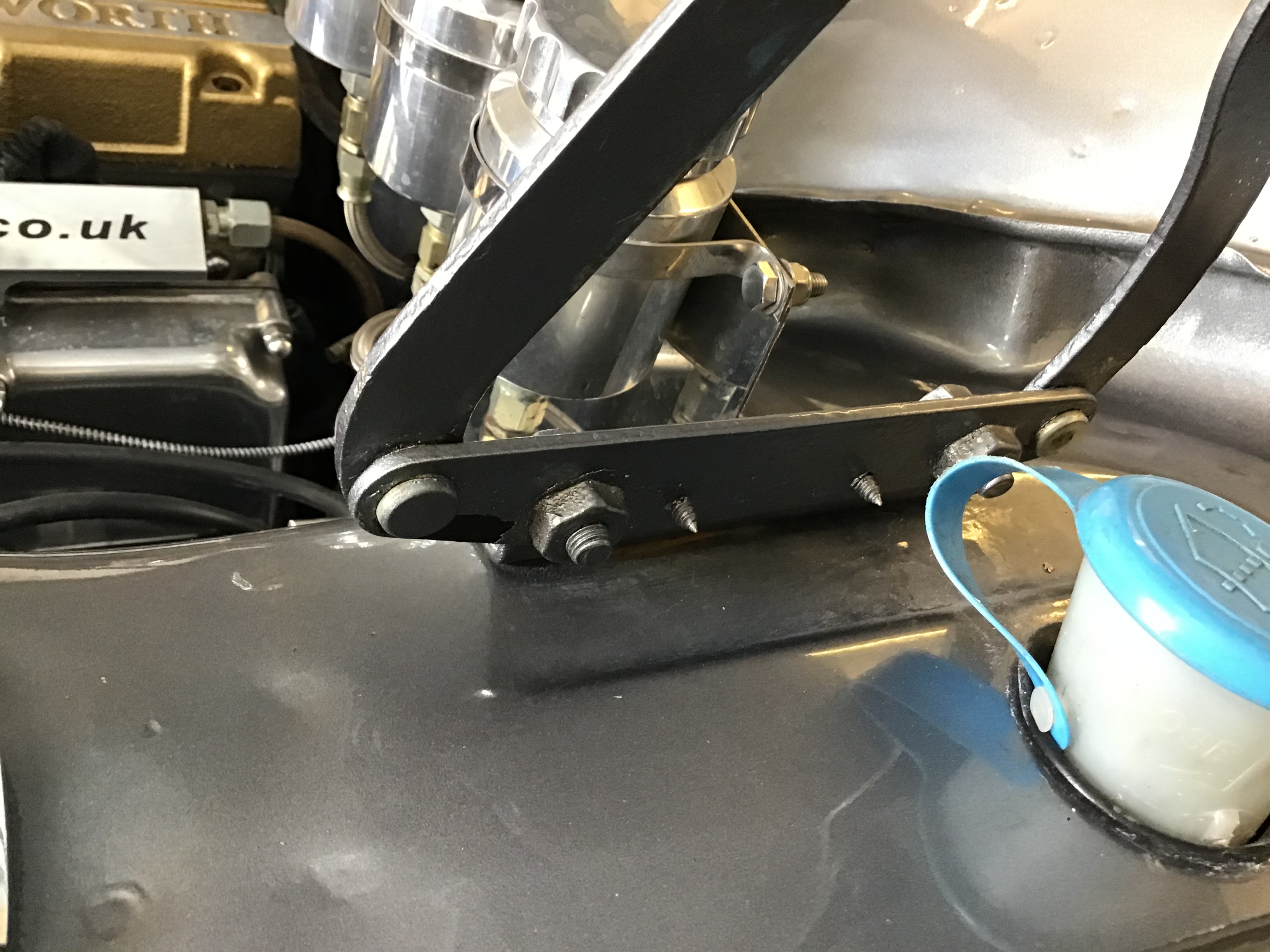

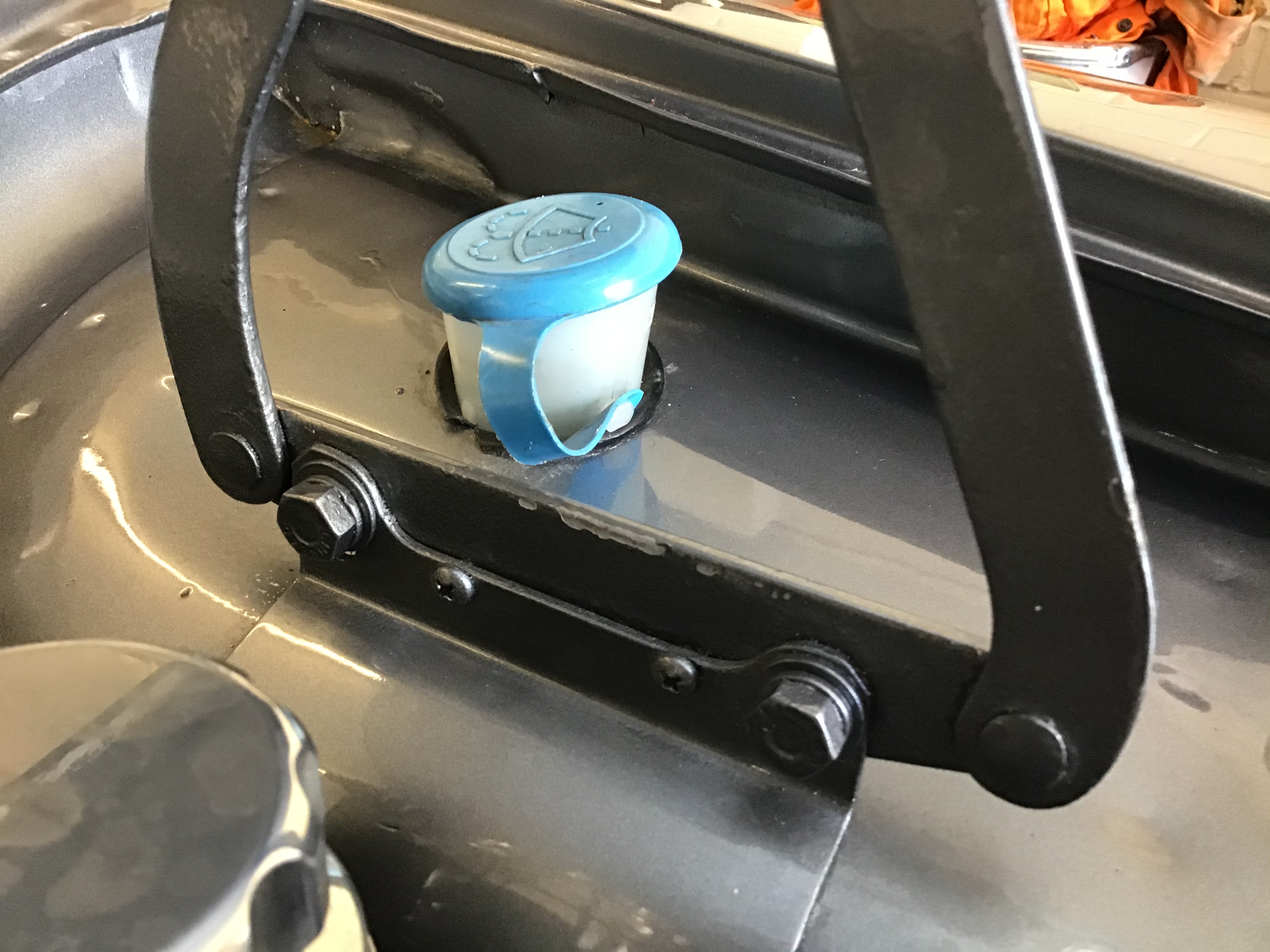

colr6 Posted June 8, 2021 Report Posted June 8, 2021 I re pinned mine using slightly larger Clevis pins drilling to suit and peening the heads over, worked a treat.
Johnny Boy Posted June 8, 2021 Author Report Posted June 8, 2021 2 hours ago, colr6 said: I re pinned mine using slightly larger Clevis pins drilling to suit and peening the heads over, worked a treat. Yes , that's a good option. I,m picking up the old ones from the body guy tonight, I'll have a look , good idea
colr6 Posted June 8, 2021 Report Posted June 8, 2021 6 minutes ago, Johnny Boy said: Yes , that's a good option. I,m picking up the old ones from the body guy tonight, I'll have a look , good idea Tbh it was quite easy to do, must be I did it ....lol a couple of pics of finished pins. 1
Johnny Boy Posted June 8, 2021 Author Report Posted June 8, 2021 50 minutes ago, colr6 said: Tbh it was quite easy to do, must be I did it ....lol a couple of pics of finished pins. Steel or brass ?
colr6 Posted June 8, 2021 Report Posted June 8, 2021 9 minutes ago, Johnny Boy said: Steel or brass ? Steel.
Johnny Boy Posted July 14, 2021 Author Report Posted July 14, 2021 All sorted, I got some 10mm clevis pins , and got a pal to turn the ends down , drilled the hinges to 10mm,then drilled a hole in the end, and rivited them in place by using a press 😀
