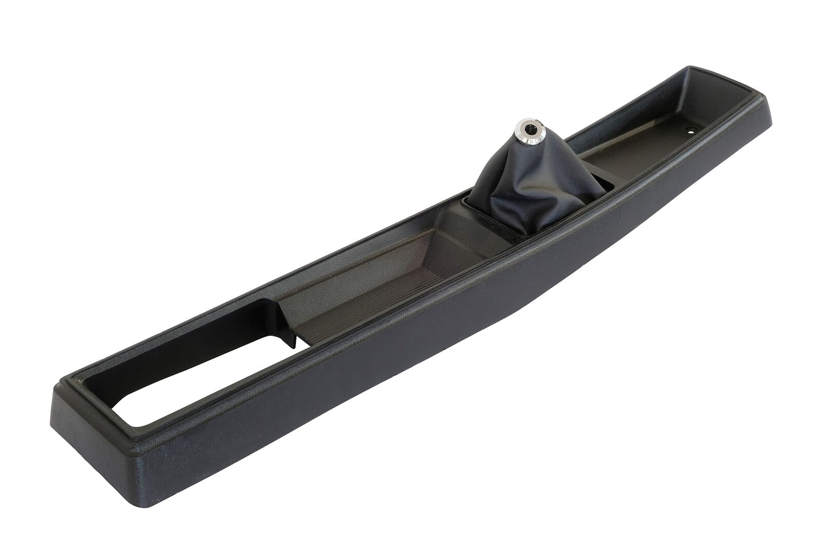

BaileyMex Posted June 8, 2023 Report Posted June 8, 2023 Hi all Just a quick question as I can't find out any info online. When fitting one of the long centre consoles into a MK1, was there any fixing or spacer that went in between the screw mounting points and the tunnel? Photo for example. Cheers
Ray Posted June 8, 2023 Report Posted June 8, 2023 are you fitting that classic trim one or an original ford one the ford one has a removable ice scraper, is fixed to the floor using the rear 2 handbrake gator screws, then 2 screws mid way, hidden under the scraper, and one at the front, no spacers underneath, but under the scraper near the handbrake youll find 2 slots, thats for a metal strengthener strap to stop it pulling apart the classic trim one does not have a removable scraper, and only screws to the tunnel with 3 screws, never fitted one, so dont know what theyre like tbh
BaileyMex Posted June 8, 2023 Author Report Posted June 8, 2023 Hi Ray Original Ford one, thanks for the info. So once the rear ones under the handbrake gaiter are in and lined up, it's just a case of making sure the plastic centre bit is reinforced and then drill down? Gulp ! 🤣 Sadly the ice scraper is missing, but I have seen some repro ones, or might fab something up in the short term
