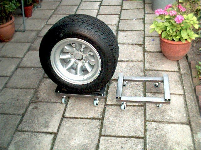

Miniliteman Posted September 29, 2023 Report Posted September 29, 2023 Even if you plenty of space these things are very useful. Made a set of 4 myself. Buy length of tubing and 16 castor wheels plus an afternoons work. Cut the tubing to size bolted the ends together and welded them for increased strength. Replaced the small wheels on the photo for somewhat bigger ones.
