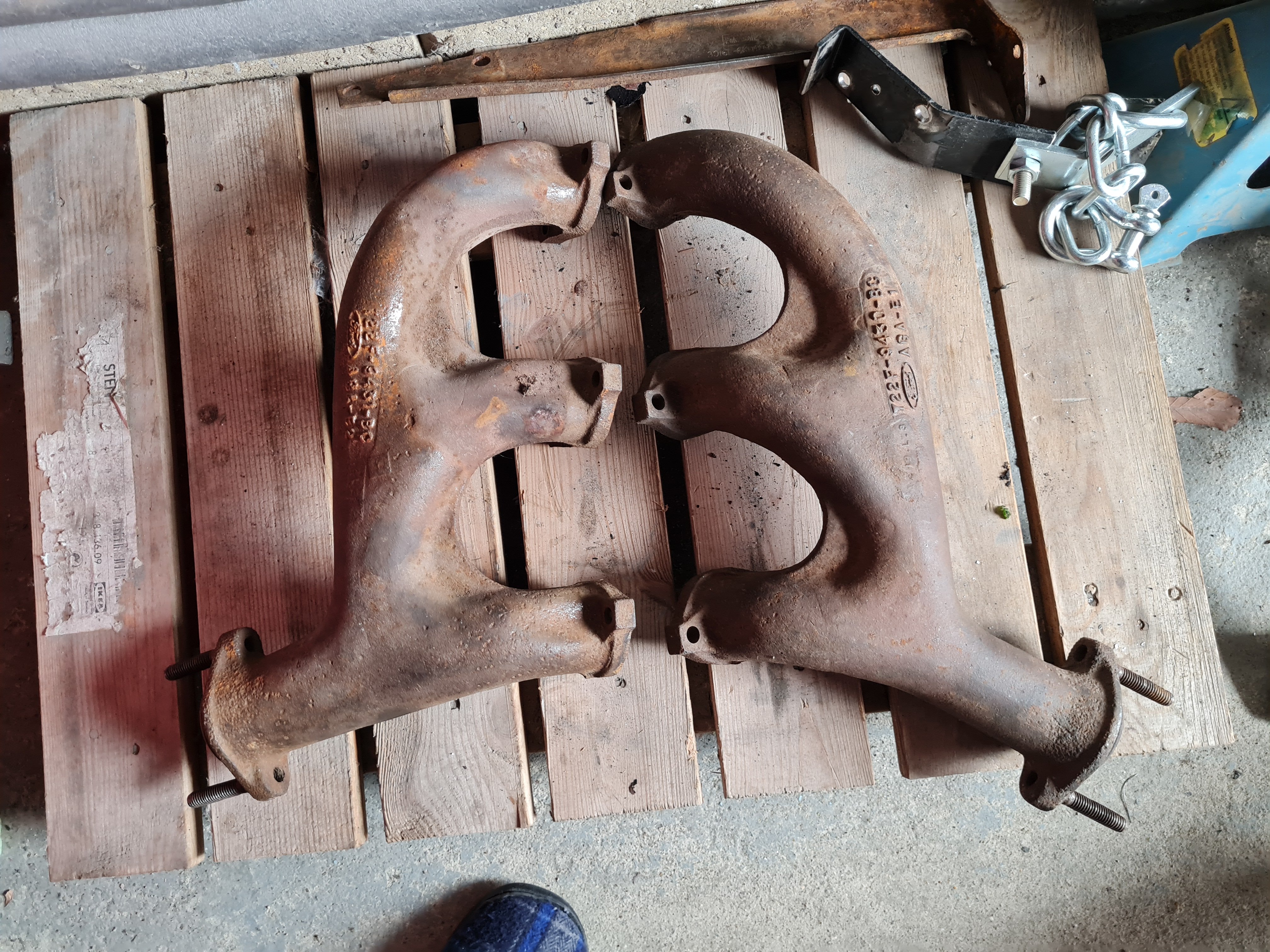

  19. also interested in another pair of V4 ones as in picture

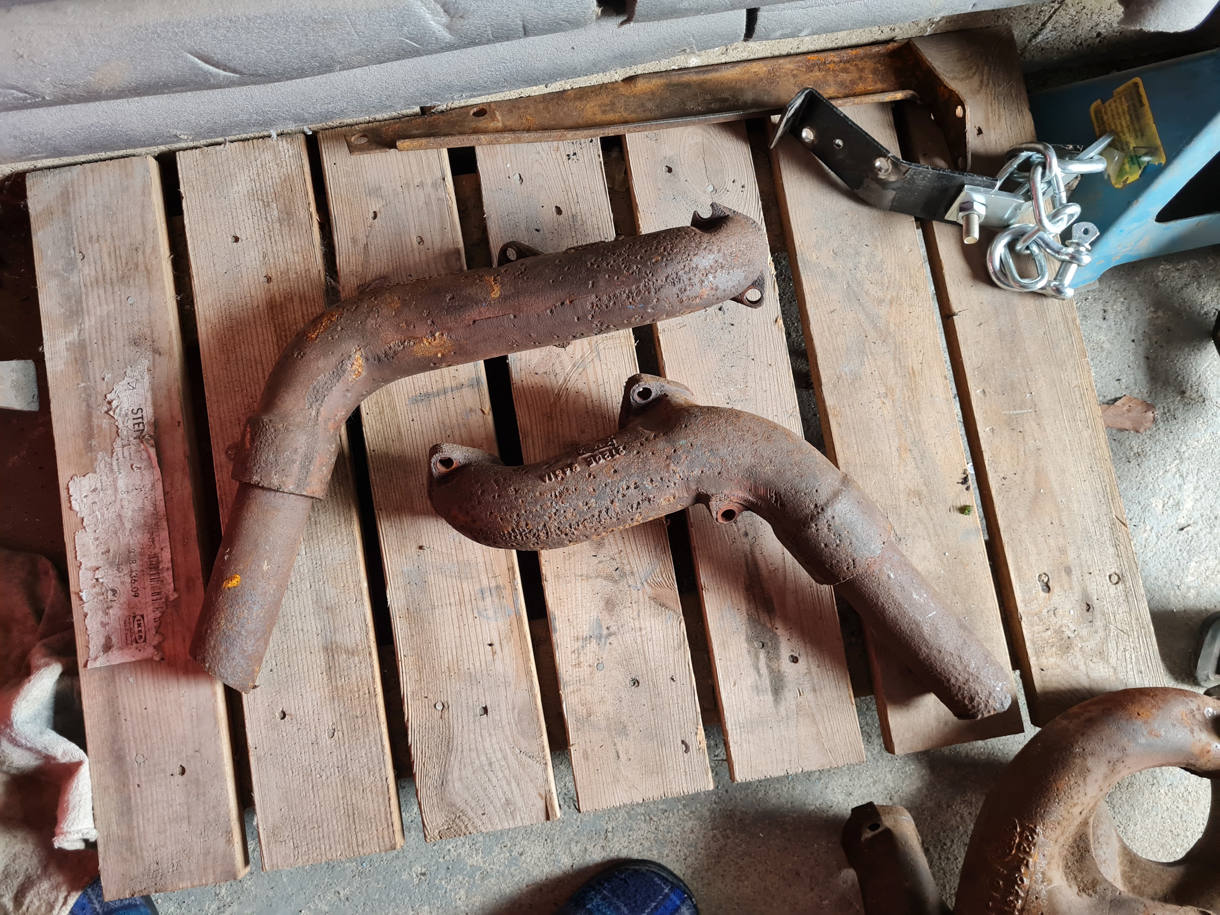

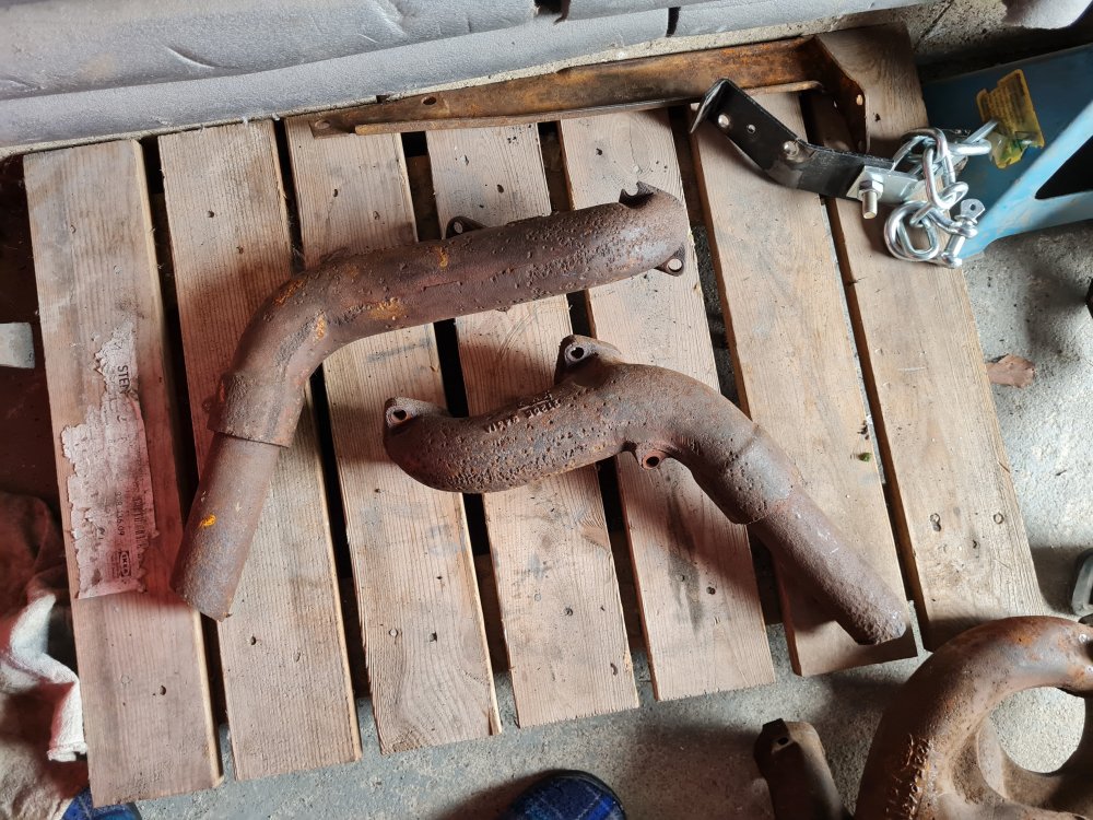

  22. Picture for example, the V6 ones I have are transit i think and they arent shallow enough, the V4 ones are perfect but obviously a port missing, I may have to resort to cut n shut somehow?
