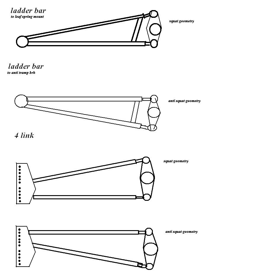

  5. if you set the 4 link kit up for sqat you wont need lader bars for drag it will also handle on the road too i found the pic on t/sport that retro motorsport uploaded
