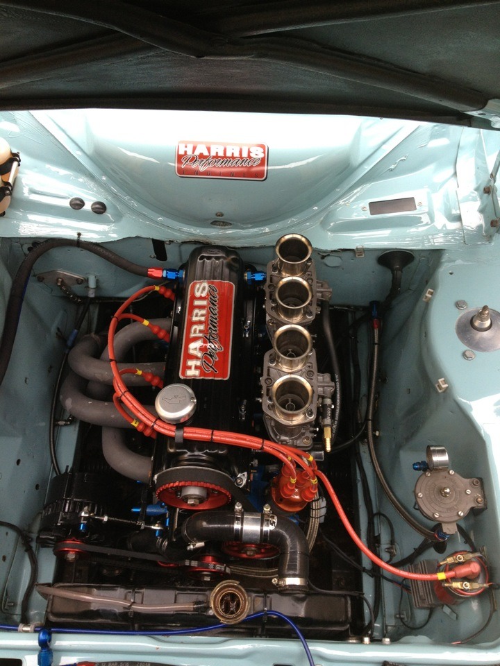

nik_plant Posted January 24, 2013 Report Posted January 24, 2013 Did Andy Harris not run idf on his escort at some point?? I'm sure I've seen a picture someone, Go for it they look über cool I've been looking at these myself
James HPE Motorsport Posted January 24, 2013 Report Posted January 24, 2013 Yes Nik, he did, but his IDF's are now on my Mk2!!! He did have to cut a hole in the bonnet though, but it was a saggy fibreglass one and it used to suck down onto the trumpets! I'm sure they will fit with shorter trumpets!
