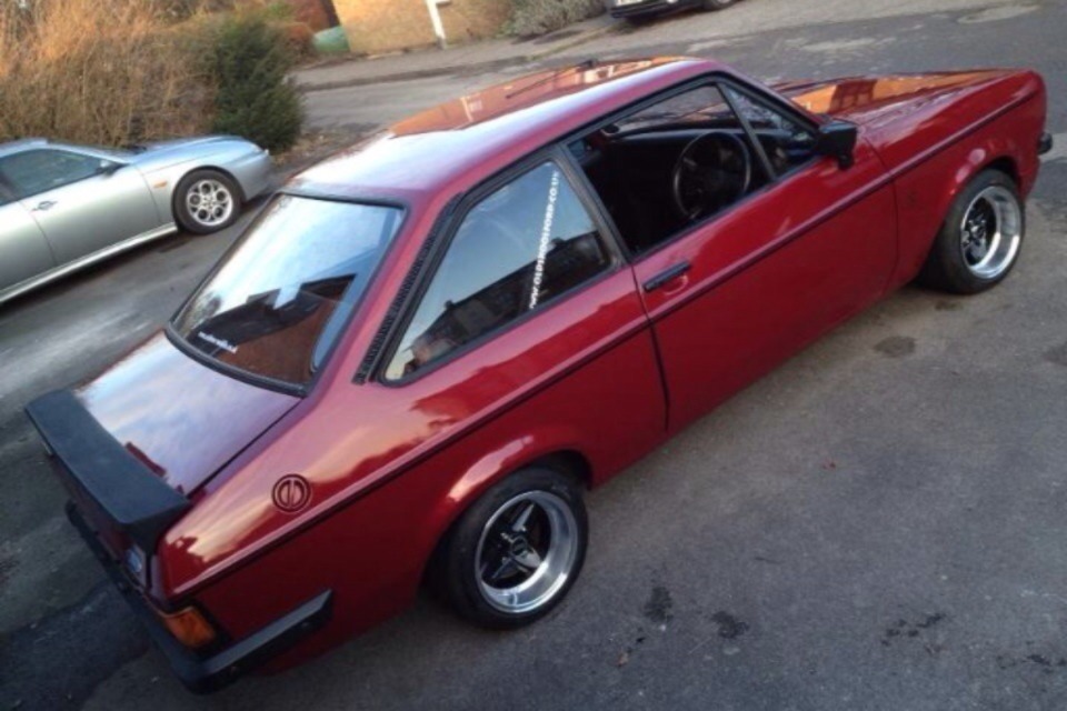

Here's some photos of a set I trial fitted on mine a few years ago as they were for sale locally
Put a tape on your drum / hub face and measure out the outer wheel arch these wheel rims will end at  127mm, i was going to try them on mine but opted for 7x13 with 185/60 tyres
Lovely car you have there.
What size wheels/tyres do you have at the moment? Here is mine with 7in Revolites (ET-7)fitted with 185/60 tyres. Dont think you would get away with 60 series tyres with a standard length axle . Think you would be ok with 50's. though. i like the deep dish on these wheels

ok, think I will be settled with these, what you think, they should fit ok - what size tyres you reckon??

I have the rims from JBW fitted with 175/50 tyres.
Don't rely on them fitting a mk1 because they fit a mk2 though. And be wary of the effect 175/50/13 tyres will have on your gearing before opting for those.
I was just gonna put up that there is less room under the mk1 than my mk2 some people have no probs with rubbing some do.
I have 6jx13 rs 4 spokes on my mk1 now, no problems with clearance under the wheel archs and it feels the archs well, cant remember what tyre size im running though, i will find out tommorow.

I wanted the 7.5 x13 for my mk1 escort. They won't fit unless you either chop the axle , put an Anglian van axle on or flair the arches.The offset is all wrong. Unless of course you want them to look like the ones in the pics Vista put on (orange escort)
