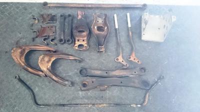

warrenk Posted July 8, 2014 Report Posted July 8, 2014 Thanks for your reply, I had heard of this being done a number of years back but it seems to have dried up with a focus on the alloy mounts these days. It sticks in my memory because i remember seeing a photo of the topmount with yellow eurothane which stood out over the black rubber originals. It wasnt done locally here in Australia though I thought it was the UK. It makes total sense rather than throw away the whole mount. Does anyone there in SA offer that service to anyone outside do you think? I'm sure I can make a plan for you. I'm going to start selling the Mk2 Sport Polyurethane kits on eBay soon. Regarding the strut tops.. If you do want to go that route.. Do you have the big or small diameter tops? And would you want the bare strut top casings sandblasted and powder coated before it gets cast with polyurethane? Just want to see if I can get two old ones and then get a price on recasting them. I did the loose suspension arms for a friends Cortina Mk5, had the arms sandblasted and powdercoated before we fitted the bushes. I'll post a photo of the arms just now. You can choose between blue, black, yellow and red. Once I have a price on old strut tops and the casting I'll get a price on postage for you. Someone in Australia getting advice from someone in South Africa. Love it! I help where I can bud. Plus I have access to the stuff so why not. Hahaha Makes perfect sense to me as both countries collaborated on their Escort programs originally. The forum going a bit more international can be a good thing given how many of our cars you guys keep pinching when yours turn to flaky red dust! Dont think we havent noticed LOL And here I thought we were one of the only counties losing our classics to the UK..

warrenk Posted July 8, 2014 Report Posted July 8, 2014 I have attached a before and an after photo of the Mk5 Cortina suspension arms 1

Moderator Rally Pack 2000 Posted July 9, 2014 Author Moderator Report Posted July 9, 2014 I have attached a before and an after photo of the Mk5 Cortina suspension arms DSC_0515.JPGDSC_0760.JPG Im sure the Cortina guys will be muchly interested in that!
