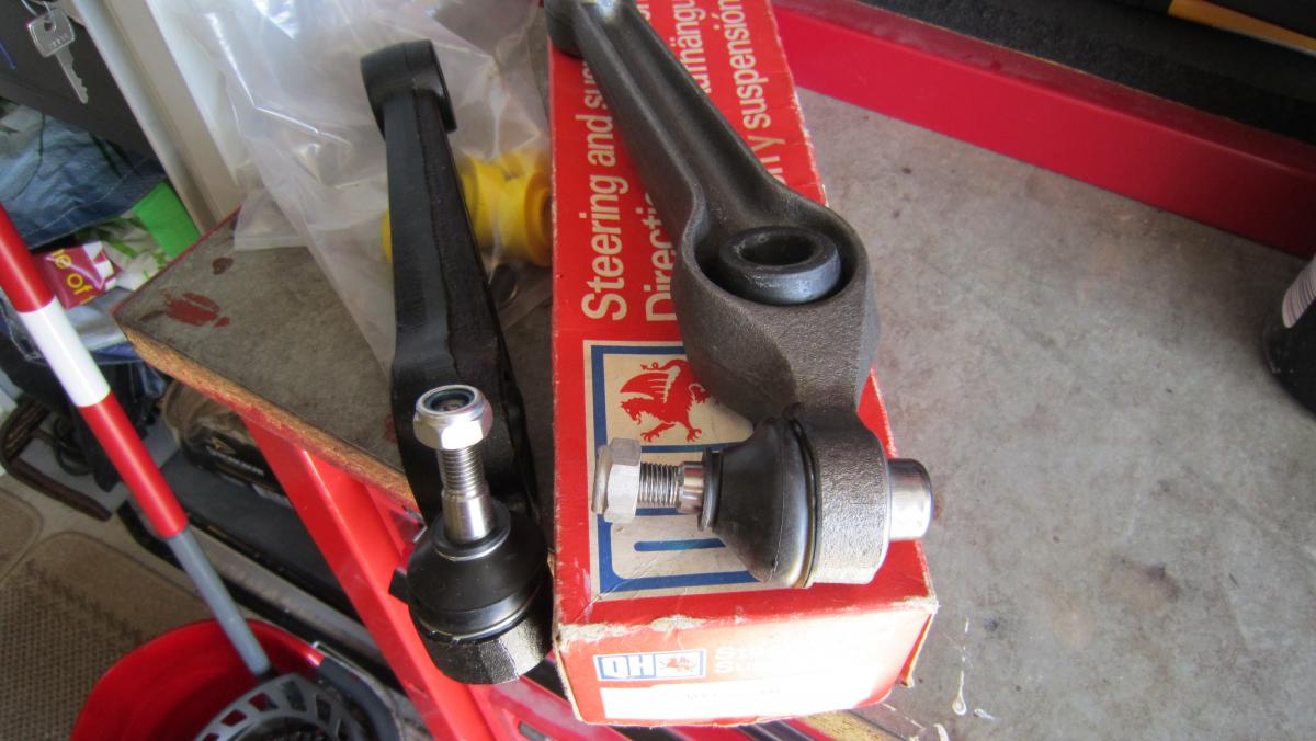

DT36 Posted July 11, 2014 Report Posted July 11, 2014 I'm sure it used to be ok, only a while ago it started knocking, so I assume it was the right one? When the MOT tester tightened it he said it was all good so I (again) assume it was the right one. Anyone know if its a metric thread? Hi Mike. Hard to say what thread you have and it could be either. Look at the pic below I've just taken. These are 2 different threads. The TCA on the left is a new one from Rally Design for the left hand side and the TCA on the right is an old one for the right hand side. One has metric threads and the other is imperial. 1
mk2 mike Posted July 11, 2014 Author Report Posted July 11, 2014 Imperial and metric? That's handy lol. Thanks mate I might just get them replaced.

Tom E Cropp Posted July 11, 2014 Report Posted July 11, 2014 You could always measure it with some verniers first of all measure the diameter of the thread say that's 10mm the nut you require would be m10 then you need to find the pitch, so measure the distance between the threads say that's 1.5mm this would mean the nut you need is m10 x 1.5 If the diameter is 9.5mm it's Proberly 3/8 11.1mm is 7/16 and so on so if it's not 10, 12 or 14mm it's likely to be imperial if that's the case it will either be unc or unf (coarse & fine threads) If that makes sense! 1
