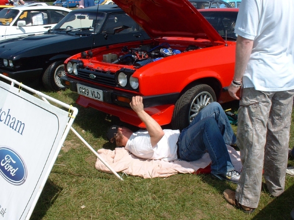

Coops V8 Posted September 29, 2006 Author Report Posted September 29, 2006 yeah i broke her at classic ford too, did my best ever run of 13.435 @ 102.50mph and snapped the engine mount mid track, but never backed off as you can see Replacing the broken engine mount to go for another run, ran a 13.7 after that as was a bit unsure if the mount was going to hold,
