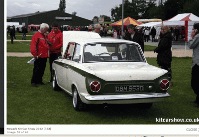

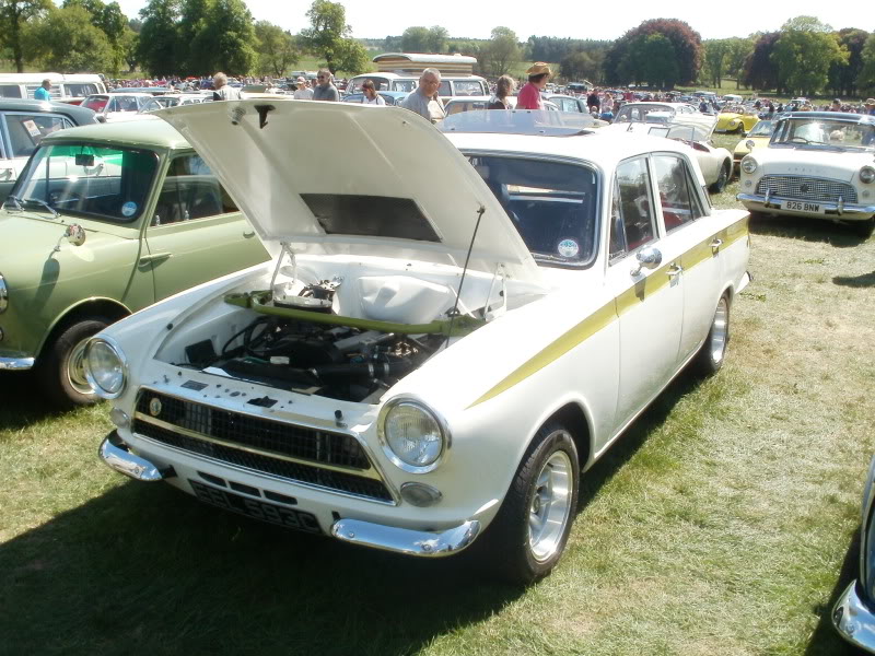

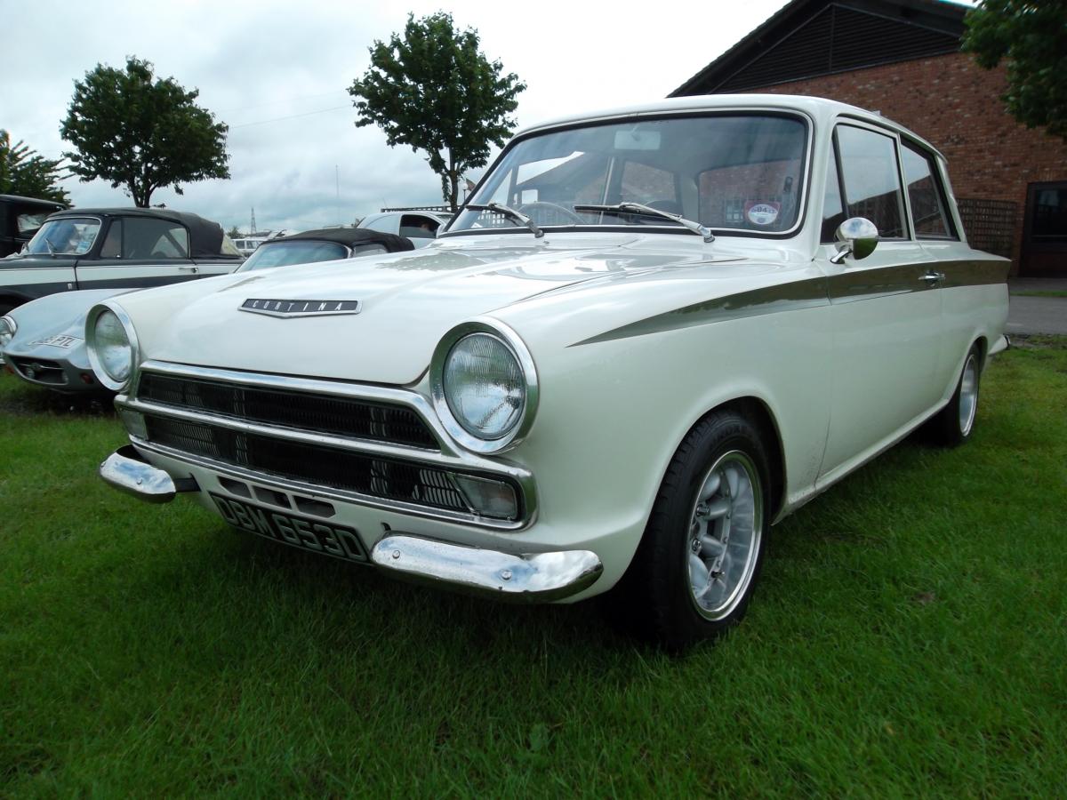

Leo,yes at the mo LHD but converting got all the parts from Escort-tec....Pete wants it in green, Paul will no doubt will say white and I guess you would say orange! Thought of lotus colours but most people do that so me liking to be different chose those colours.just have to see what it turns out like,can always be painted again!

Black and gold :thumbsup: Black where the lotus Tina is white, and gold where it's green...........is my bias showing at all :-)

Black and gold would be nice,but after owning a black car never again trying to keep them clean and scratch free to much like hard work!plus bodywork has to be flawless to be in black especially on flat panels.
Orange is just the wrong colour for that, the original gt red I reckon. If I was ever going to sell up my Escort, a two door Cortina would be next on my list. Very damn cool.
