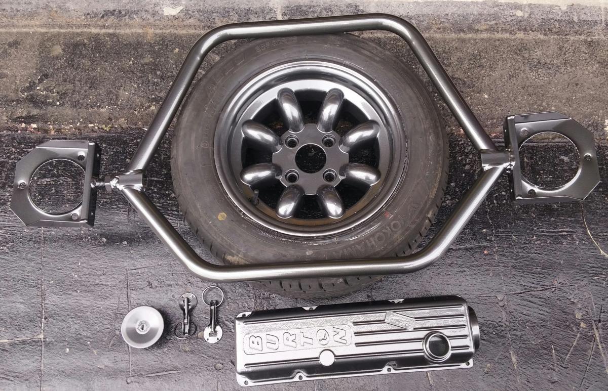

DT36 Posted April 25, 2017 Report Posted April 25, 2017 Had a few bits done myself in Gunmetal Grey. Also had pulleys and carb trumpets done since pic below. 2

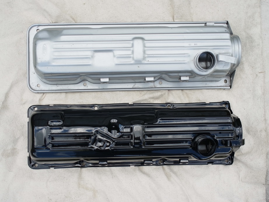

Moderator Rally Pack 2000 Posted April 30, 2017 Author Moderator Report Posted April 30, 2017 Some very informative experiences have been presented so far. While I have recently had a couple of great results with a professional powder coater I can certainly see how some have turned away from using it. I cannot attest to the long term durability of it so far. So much so I am reluctant to get my booster tower done. If I had a few years with the cam cover I may feel otherwise but at the moment I am still hesitant. With the cam cover and bracket its a safe test. If the coating fails then both are removable in minutes to be redone in something else (except that darn water bottle bracket of which I hope the coating lasts forever as I never ever want to paint that thing again!). The booster tower however is a bit different and involves alot of brake component and lines to get it out so I want something that I can be assured will last forever pretty much so I dont have to do it again in my lifetime. I think not only do you need to be very selective to who does the coating for you but also what components you get done. Areas prone to stone chipping like wheels and bumpers and as Col mentions bike frames then I would definitely shy away. Water exposure may also be a factor as some feel that once moisture get underneath is promotes rust and flaking of the coating. However under bonnet and in car stuff it can prove a viable alternative. There are many different formulas and quality of coating materials as well it seems and the one I have had success with was expensive I think. Here is the black cam cover I had coated recently as posted in another thread. The deep gloss finish was a good as any 2 pac I have seen. But in order to achieve that takes several layers apparently not a single layer process that most of the industrial coaters do. Would still love to hear about some long term experiences. Has the finish lasted or has it faded or lost some of its gloss with time?

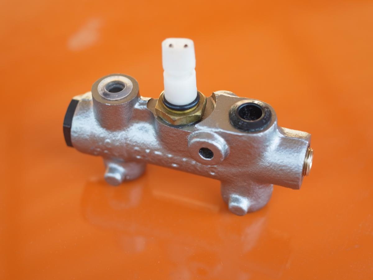

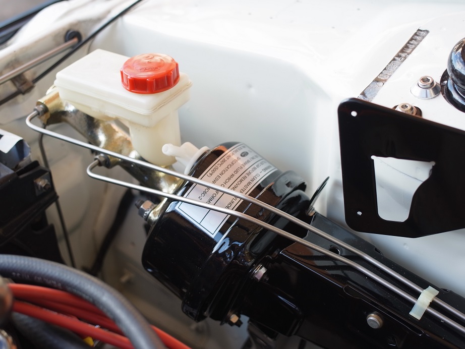

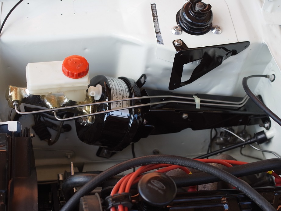

Moderator Rally Pack 2000 Posted May 26, 2017 Author Moderator Report Posted May 26, 2017 I ended up biting the bullet and had the booster tower powder coated. They did a quality job as they did on the cam cover and the infamous washer bottle bracket. It will just come down to longevity pretty much so time will tell. I also had the booster itself reconditioned and by the nature of the components I couldn't have that stuck in an oven to have it powder coated to match, so I just painted that myself with a high gloss chassis coat paint. It seems to match up and don't think anyone will notice the different between the two finishes. Especially after covering up the unplanned paint run with the booster decal. That probably would have given things away, Woops. It will be interesting to compare how the different surfaces age together with time.
stephens_xpack Posted May 26, 2017 Report Posted May 26, 2017 Looks like a very nice paint job, especially the home grown effort - nice job. Most components I will paint from a can, and as long as you work in a clean and dust free area and take your time to prep and then take your time to apply lots of nice thin coats there isn't much to it really, just need to be patient and let the paint dry between each coat. I have painted both front and back bumpers on the Capri, and they both look great, albeit satin which is an easier finish to work with. 1
Moderator Rally Pack 2000 Posted May 26, 2017 Author Moderator Report Posted May 26, 2017 Looks like a very nice paint job, especially the home grown effort - nice job. Most components I will paint from a can, and as long as you work in a clean and dust free area and take your time to prep and then take your time to apply lots of nice thin coats there isn't much to it really, just need to be patient and let the paint dry between each coat. I have painted both front and back bumpers on the Capri, and they both look great, albeit satin which is an easier finish to work with. Thanks The booster paint was just from a rattle can. The trouble I find with high gloss black though is its hard to tell when you start to get runs especially on unusual shapes along edges. The brake lines have been painted from a can also with a specialised paint for brake components. Many dont like the look of painted lines but I found this particular one that's not a bold silver that it doesn't look overly fake and its also brake fluid resistant so hopefully will preserve the lines more than just being exposed. Those lines are the originals from 79. Even though the proportion valve was brand new (and incredibly expensive) it had gone yellow from being wrapped in its brown wax paper for 40 years so I painted it in the same stuff which looks like an original finish. It was this thing bursting that started me down this path. A domino effect where you cant help but fix or restore everything connected.
stephens_xpack Posted May 26, 2017 Report Posted May 26, 2017 Thanks The booster paint was just from a rattle can. The trouble I find with high gloss black though is its hard to tell when you start to get runs especially on unusual shapes along edges. The brake lines have been painted from a can also with a specialised paint for brake components. Many dont like the look of painted lines but I found this particular one that's not a bold silver that it doesn't look overly fake and its also brake fluid resistant so hopefully will preserve the lines more than just being exposed. Those lines are the originals from 79. Even though the proportion valve was brand new (and incredibly expensive) it had gone yellow from being wrapped in its brown wax paper for 40 years so I painted it in the same stuff which looks like an original finish. It was this thing bursting that started me down this path. A domino effect where you cant help but fix or restore everything connected. BiasValve.JPG Hadn't even noticed the brake lines had been painted, just assumed they were new. With regards the runs, I think that comes with just a little bit of practice, but as with all of these type of things, we do a few bits and pieces and then may not do any again for a few years so practice we don't get too much of. It all looks very nice so you must be doing something right.. 1
Moderator Rally Pack 2000 Posted May 26, 2017 Author Moderator Report Posted May 26, 2017 Hadn't even noticed the brake lines had been painted, just assumed they were new. With regards the runs, I think that comes with just a little bit of practice, but as with all of these type of things, we do a few bits and pieces and then may not do any again for a few years so practice we don't get too much of. It all looks very nice so you must be doing something right.. I can generally get an acceptable finish first go but I found with the booster, its tower and the washer bracket that as original and untouched parts they had decades of brake fluid and stuff impregnated into them. Each attempt would cause a different effect that no amount of practise seemed to compensate. The washer bracket I even acid soaked. While I eventually got an "ok" finish on the tower it wasn't very professional that I finally went with the powder coating. Even the guy who did it say he had several attempts and believed it had been tainted by years of exposure to everything. So powder coating proved to be helpful for me personally in this circumstance and hope that it stands the test of time. That said I would still probably paint something first to see what results I get before going with the coating process.
