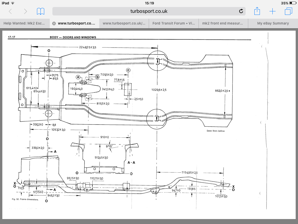

colr6 Posted May 27, 2017 Report Posted May 27, 2017 The repairs to the inner wings wouldn't be a problem for me to do....the wing mounting rails are still intact all the way along so I've got a good reference point when I'm lining the new wing rails up for height. The strut top corrosion is confined to just above the under wing cup so I wouldn't need to put a full top plate on. I still intend to paint the engine bay satin black or a semi gloss black so I wouldn't have to spend quite as much time filling and smoothing. Found this in my photo file might be some use for you checking measurements
