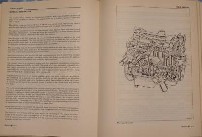

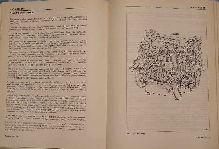

Moderator Rally Pack 2000 Posted May 30, 2017 Moderator Report Posted May 30, 2017 Only for internal use. Haynes are an independent company that wrote their own manuals based on a complete strip down and re-assembly of the car: https://haynes.com/en-gb/ Thats interesting. Ford Australia offered them to the public and they were cheaper than any of the Haynes ones and also 2 to 3 times as thick. The Mk1 Manual even has the Twincam in it. Ages ago I picked up this one at some car show/swapmeet. I just always assumed that our manuals were simply based on readily available British ones, although it doesnt have the Twincam in it like the Australian one does. As to the original posters request, my Australian manual has a huge fold out wiring diagram but if I size it down in a photo it wouldnt be very easy to read?
