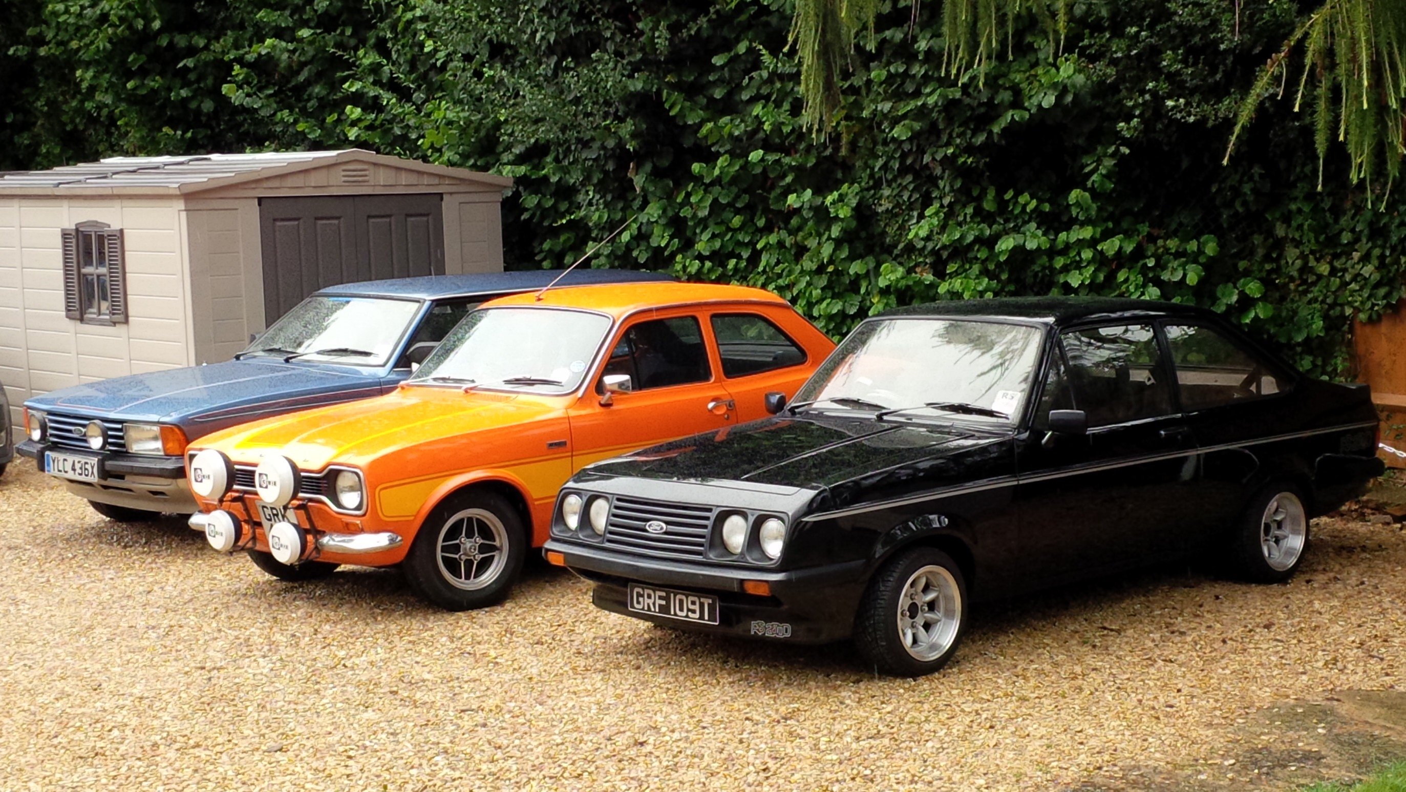

Admin Vista Posted September 18, 2018 Admin Report Posted September 18, 2018 53 minutes ago, frenchy said: what rs jo ? Last seen on the road when Adam West was still wearing a leotard in the Bat Mobile Or maybe a little more recently 1
Admin Mk2Jo Posted September 18, 2018 Admin Report Posted September 18, 2018 Aha ... that was the hotel me you and Malcy stayed at prior to Ford Fair the other year wasn't it ... great night that was
Admin Vista Posted September 18, 2018 Admin Report Posted September 18, 2018 14 minutes ago, Mk2Jo said: Aha ... that was the hotel me you and Malcy stayed at prior to Ford Fair the other year wasn't it ... great night that was Yep, August 2014. I think that was the last time we had a stand there?
deltamal Posted September 19, 2018 Author Report Posted September 19, 2018 22 hours ago, Vista said: Last seen on the road when Adam West was still wearing a leotard in the Bat Mobile Or maybe a little more recently The Mk5 Crusader is the car the DGAS throttle body is being fitted to.... 1
