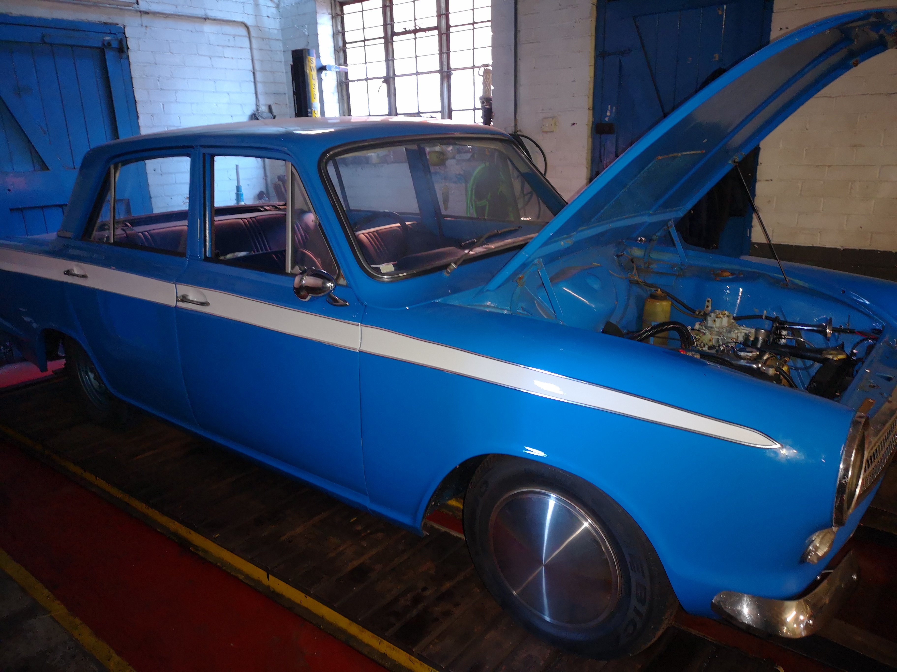

1 hour ago, chinkamon said:

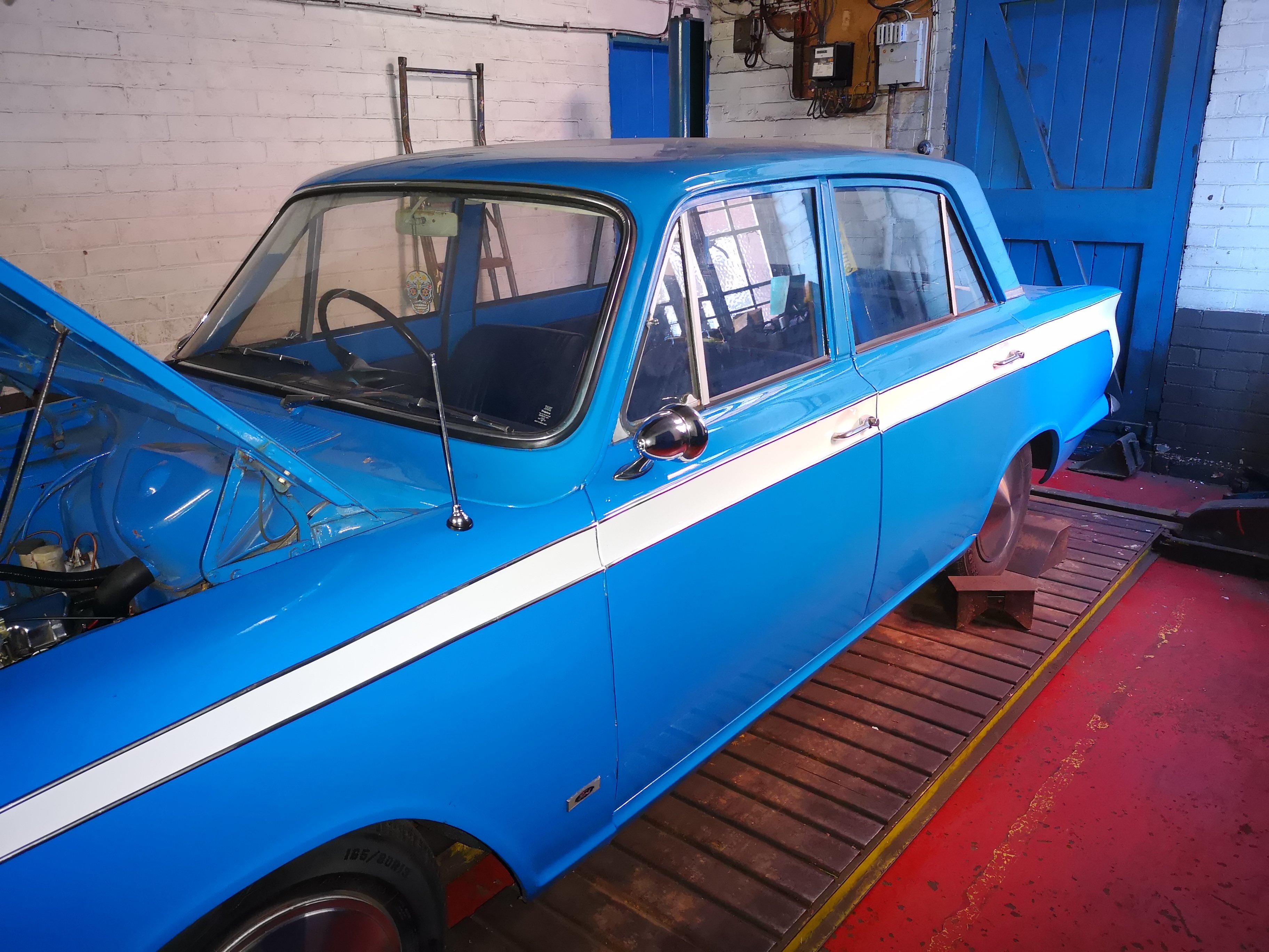

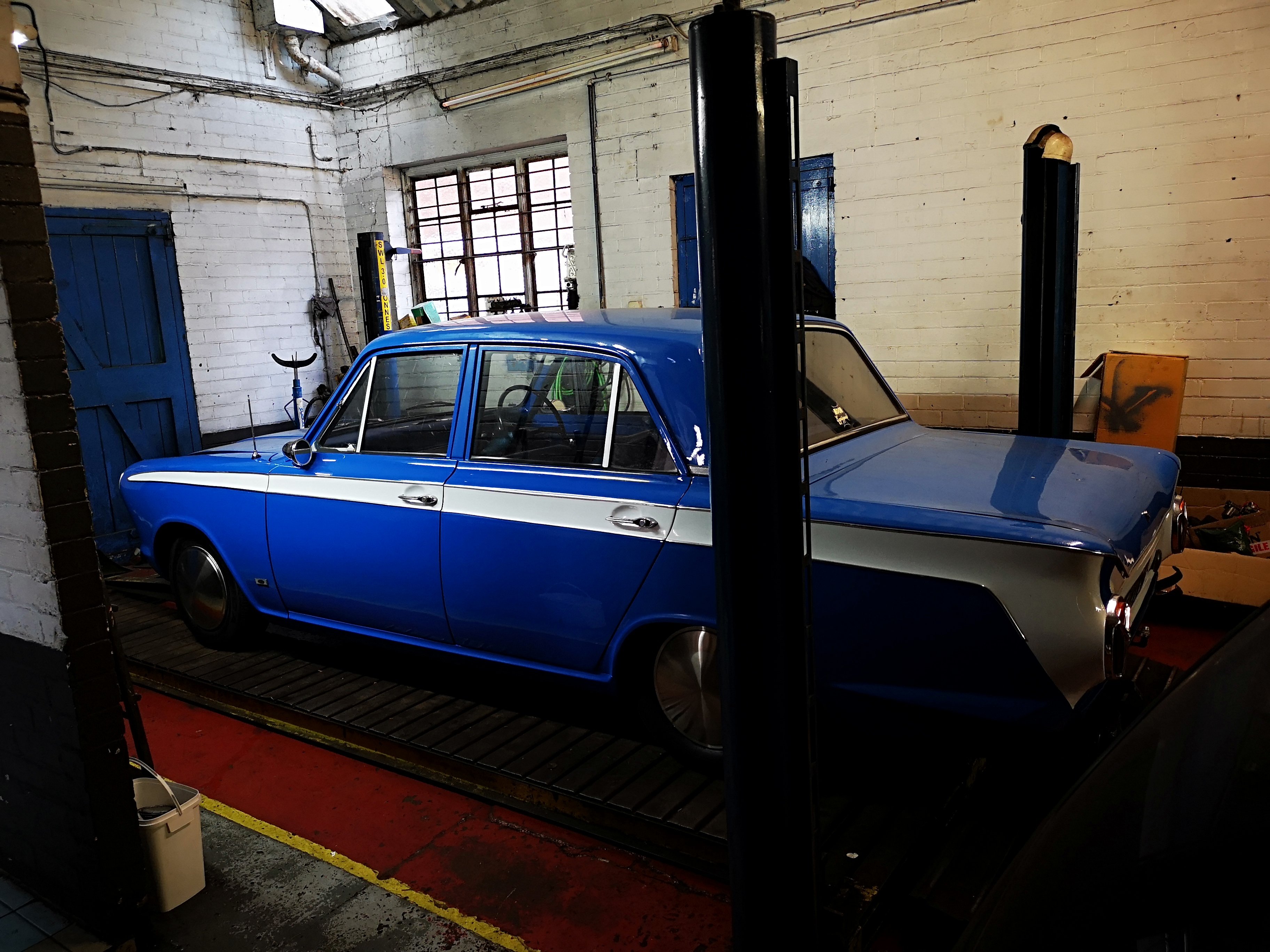

Finished both sides an welll chuffed with it!
It's not perfect but it'll do for me ?
Pics or it's not finished. :-)
  • 3 weeks later...

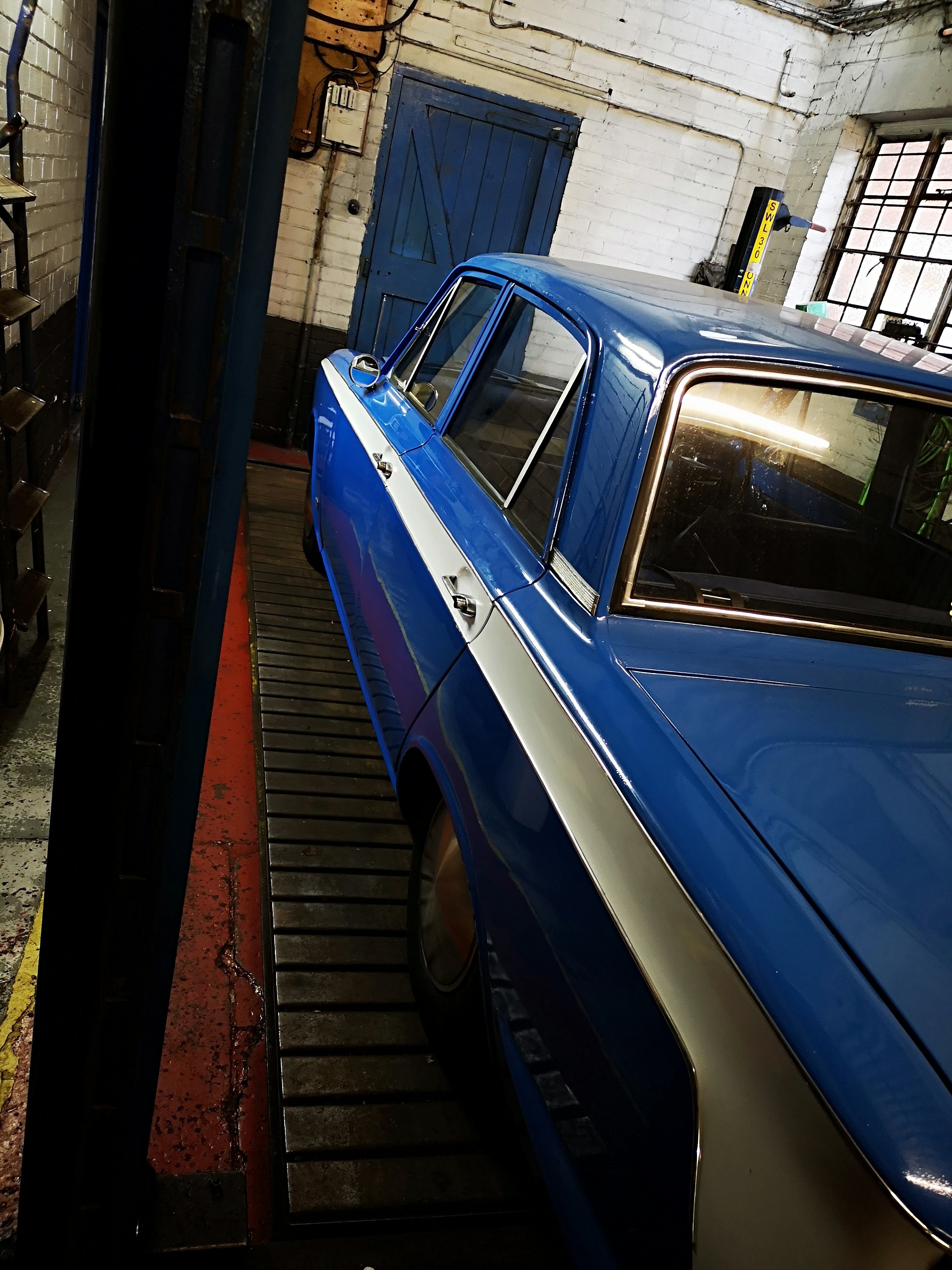

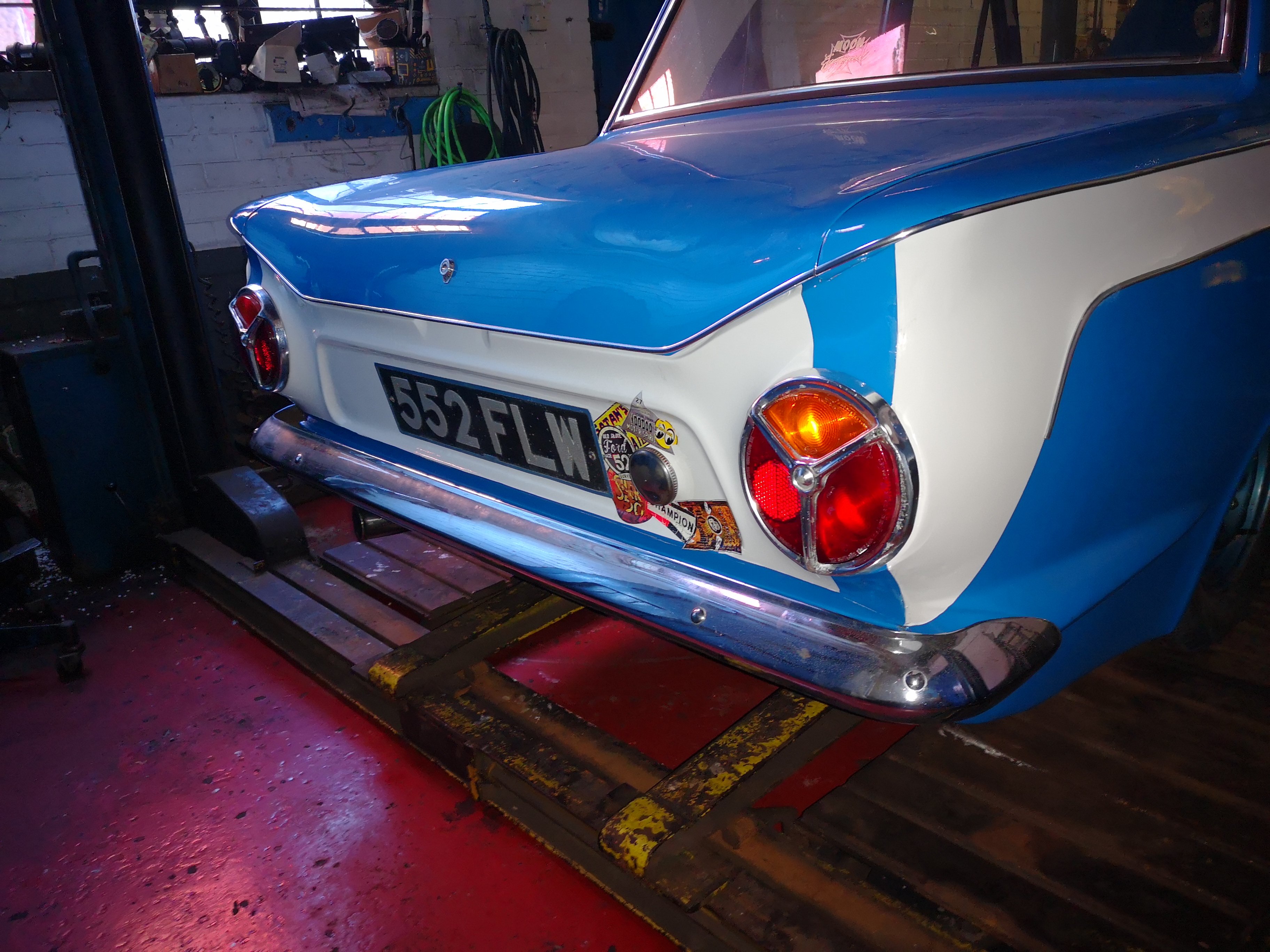

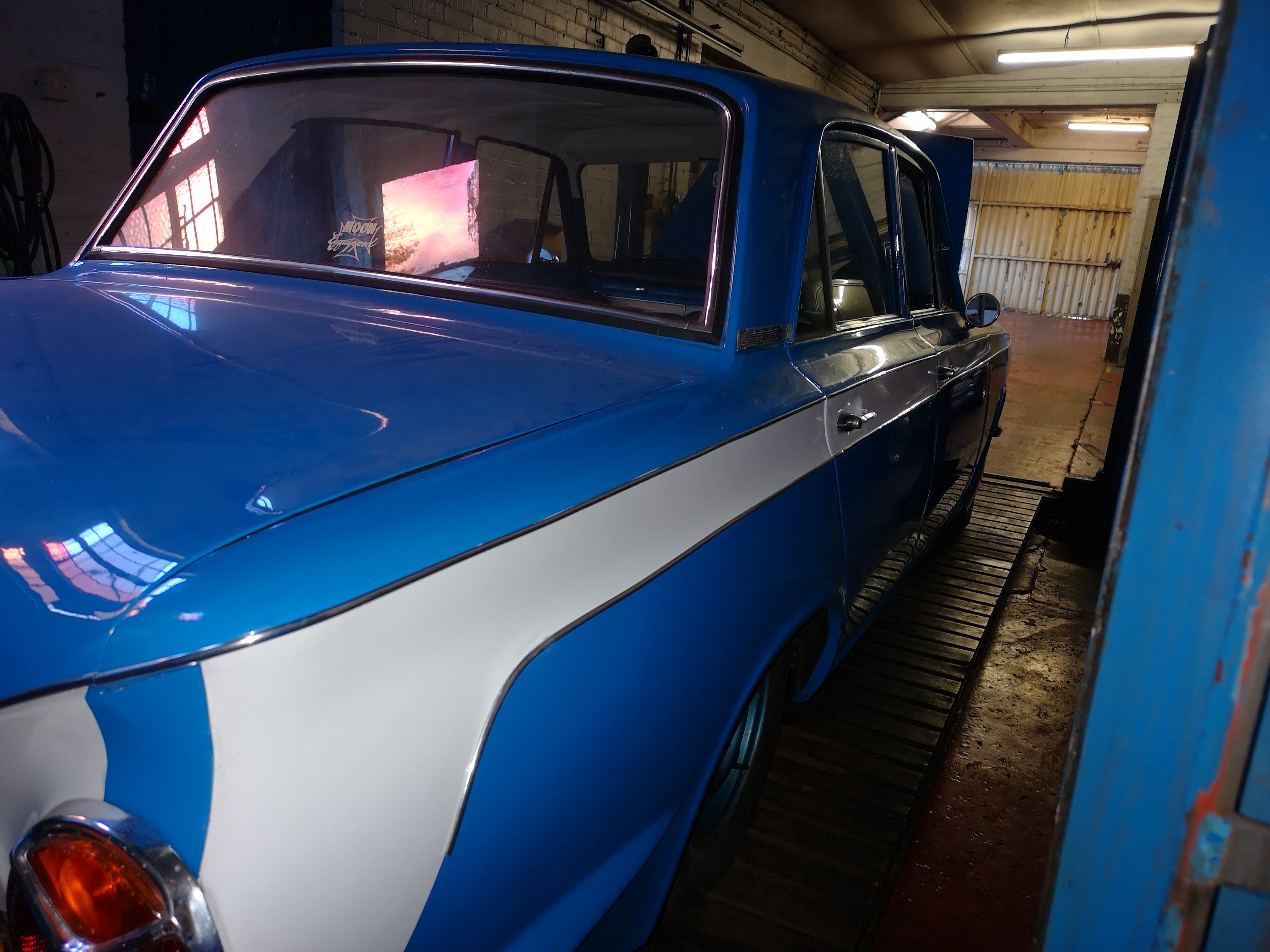

The blue lines at the rear look wonky in the photos but from the Back you can see they're shaped in the lines of the car
A few reasons for the blue lines at the rear
1, I didn't want 'those people' sneering it's not a lotus why try to pretend?
(I'm not trying to pretend hence the chrome trim, the colour, it's a 4 door, the non lotus touches)
B, I wanted it a bit different than other white striped blue cortinas
3,the f***ing vinyl was nearly the death of me through stress and it WOULD NOT stick in those two areas ?
D, I couldn't afford to buy more and try again ???
So that's my excuses and I'm sticking to them ????
That looks good, can understand what you mean when things like that drive you mad. If you watch these blokes fitting vynal graphics to weird shapes and make it look so easy, really pees you off and think why doesn't it work like that for me!?
