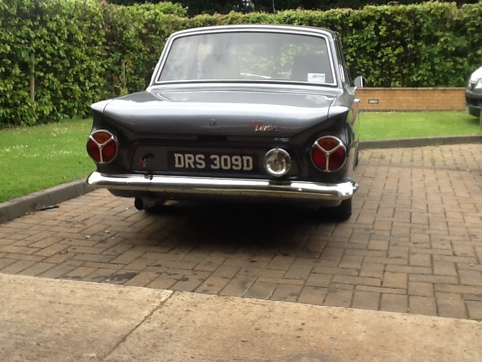

chinkamon Posted November 29, 2018 Author Report Posted November 29, 2018 Maybe fit 1 of these to the back, no bugger could say they didn't see me then ??
chinkamon Posted November 29, 2018 Author Report Posted November 29, 2018 Is that on the filler cap??
colr6 Posted November 29, 2018 Report Posted November 29, 2018 It's fitted where if was! Rev lights like this are normally fitted opposite side. They're really great as mentioned to really annoy people close behind ?
khanlad Posted November 29, 2018 Report Posted November 29, 2018 You should really have two though col, and a swivel type captains chair with your driving ? 1
