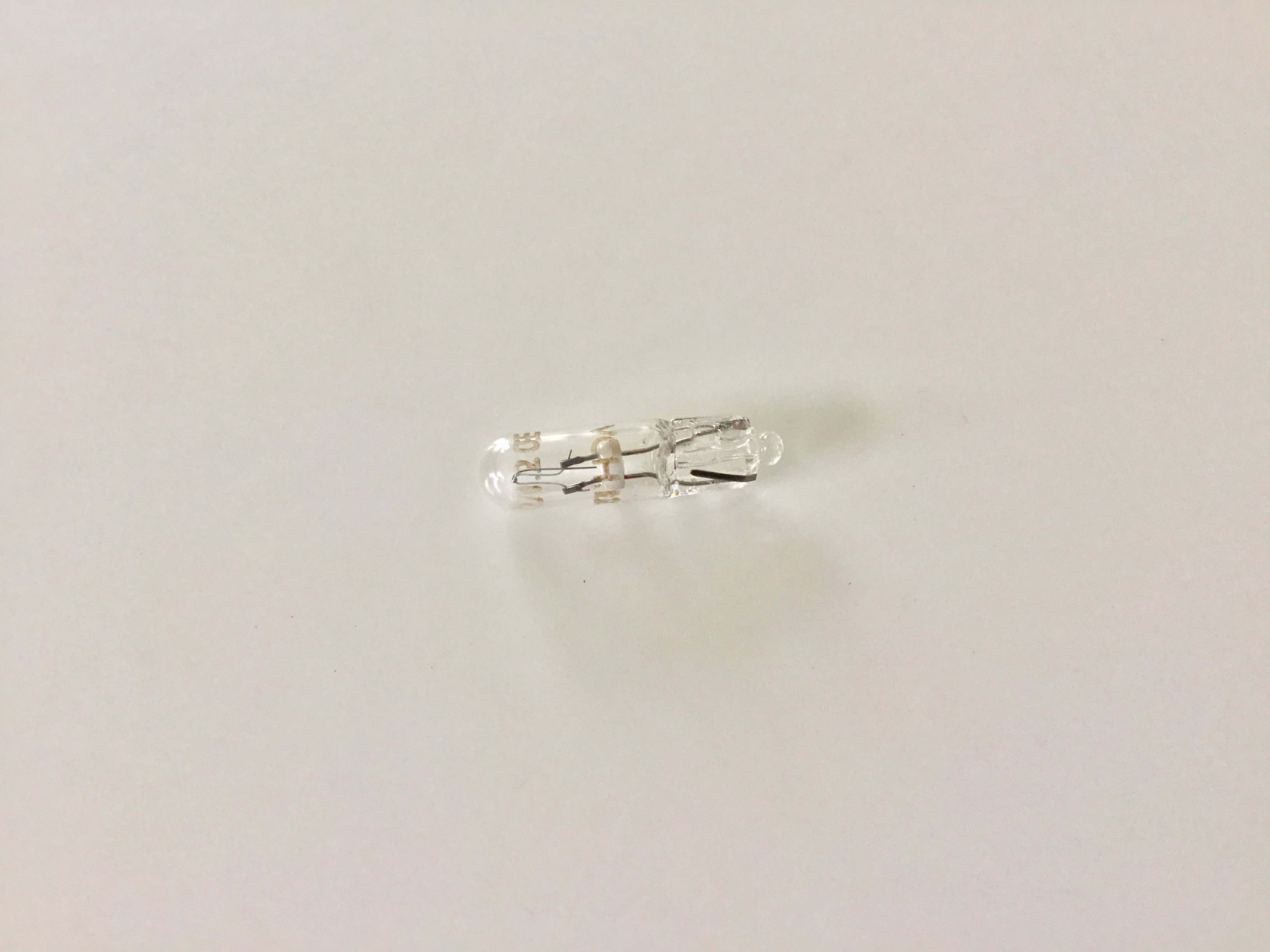

Jerrytom161 Posted March 3, 2020 Report Posted March 3, 2020 Hi , please can anyone help me ? i am after a bulb holder for a mk1 escort rear heated window loom that fits into the back of the switch it takes a 286 capless bulb . Or does anyone know where i can purchase them from ? I have checked with autosparks and they dont do them . Have had a google search and they seem to be an oddball holder and nothing comes up . I don't know if any other fords at the time were fitted with these ? If so could someone let me know . I would appreciate any help you can give . I have attached photos of what i am looking for if this helps . thanks Guys . David

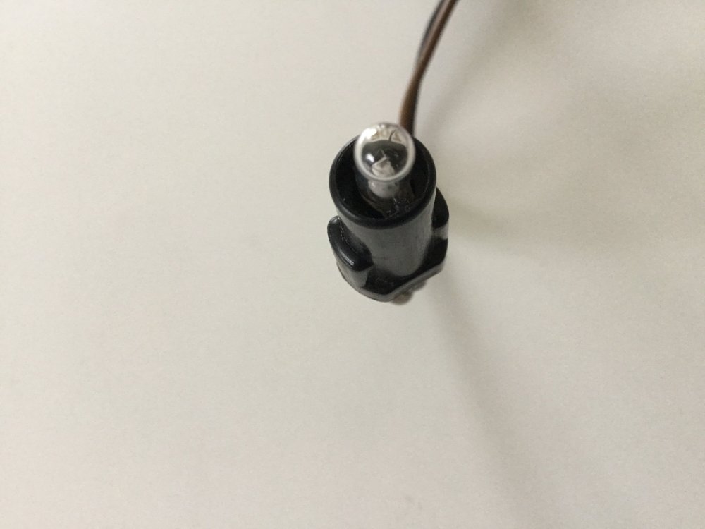

caprimk1v4 Posted March 4, 2020 Report Posted March 4, 2020 Picture of lamp holder, only short wires on it, so will need to be extended. Regards Al. 1
Jerrytom161 Posted March 4, 2020 Author Report Posted March 4, 2020 Hi Al , perfect , can you pm me please , do you happen to know what vehicle that one was out of by the way ?
