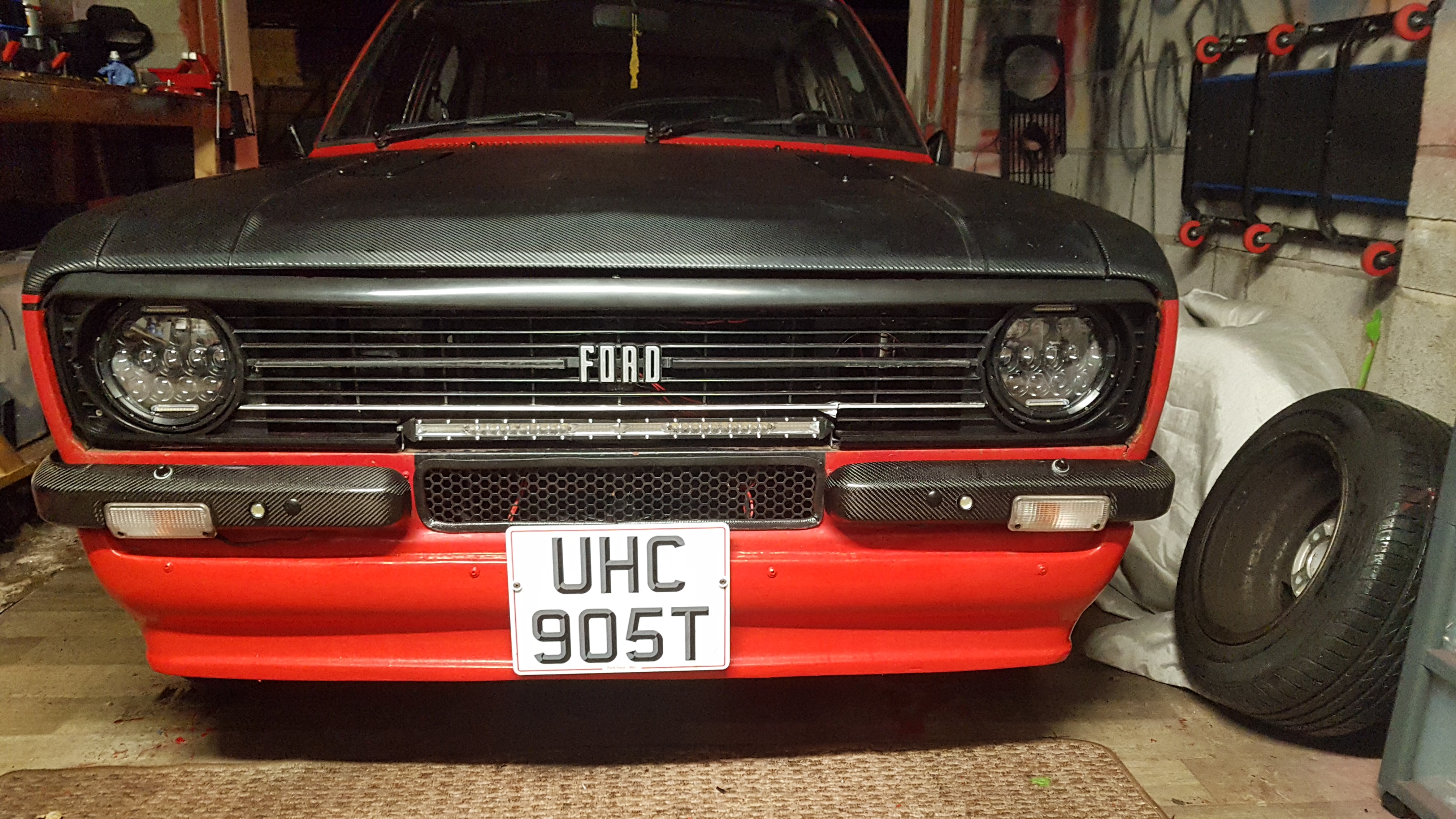

These were great when I first installed them. Now they are pants. Dipped beam is quite vague,main beam is ok though. They are coming out on the weekend . The light bar is awesome and staying
