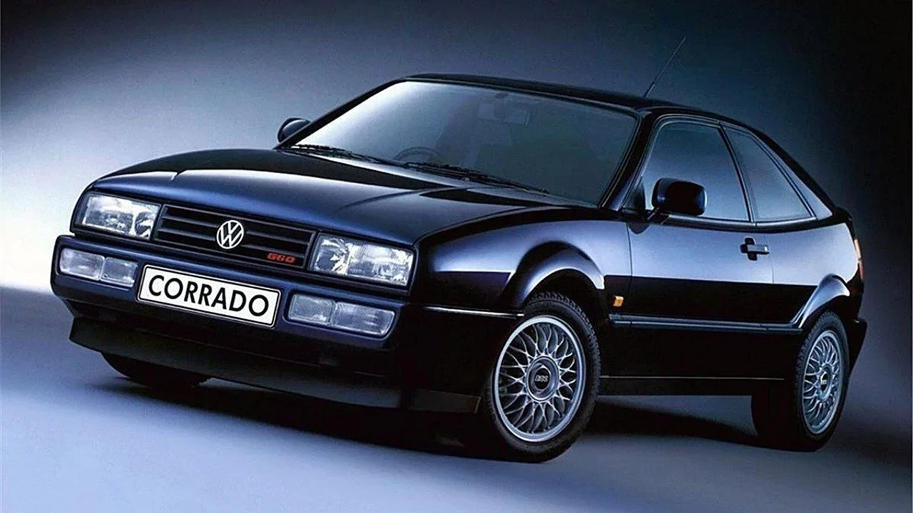

Admin Vista Posted November 27, 2021 Admin Report Posted November 27, 2021 2 minutes ago, Rally Pack 2000 said: Here is a question for all you enthusiasts then, if you could buy a classic (More than 20 years) as your every day runaround what would it be? Factoring in your own personal needs to carry family shopping work also affordability and availability of parts etc. That's easy 1 1

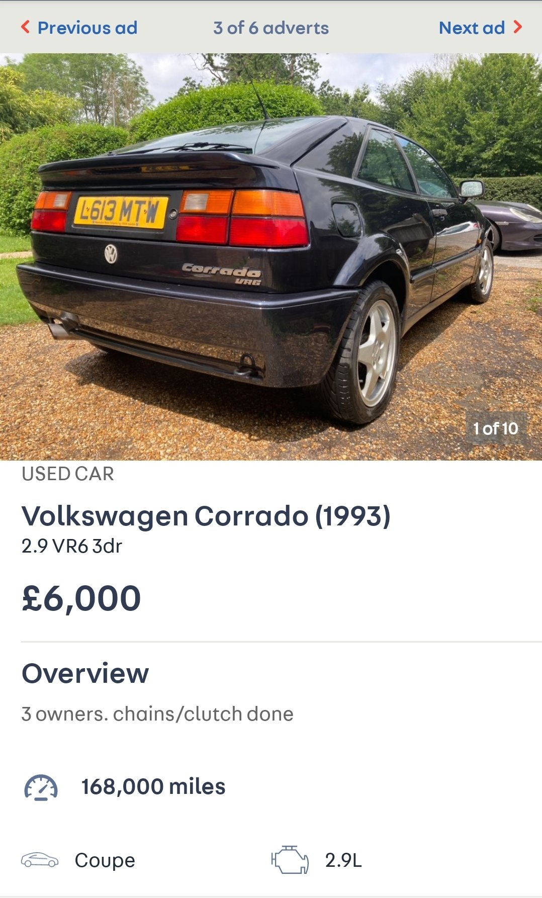

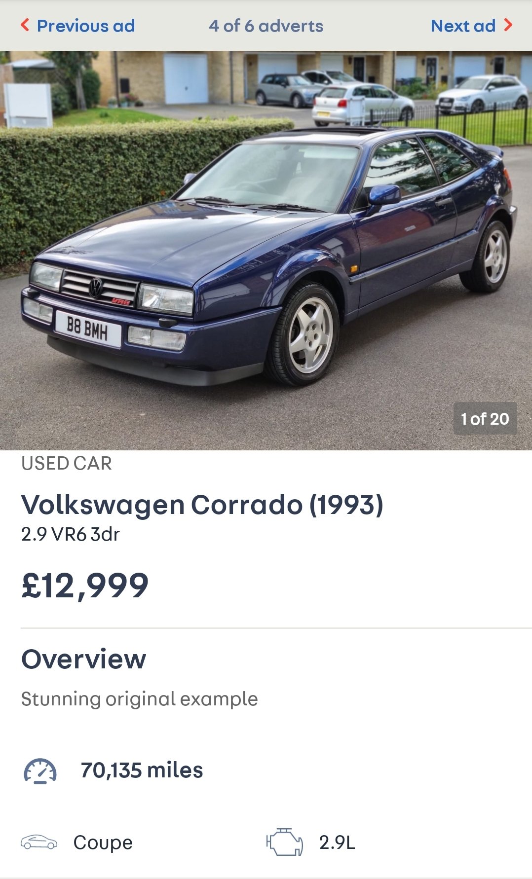

Moderator Rally Pack 2000 Posted November 27, 2021 Author Moderator Report Posted November 27, 2021 1 minute ago, Vista said: That's easy Very nice I wish we got those here! What would one of those fetch now?
Admin Vista Posted November 27, 2021 Admin Report Posted November 27, 2021 5 minutes ago, Rally Pack 2000 said: Very nice I wish we got those here! What would one of those fetch now? Price dependent on condition and mileage but still very affordable I think. Got to be a G60 or a VR6 though 1

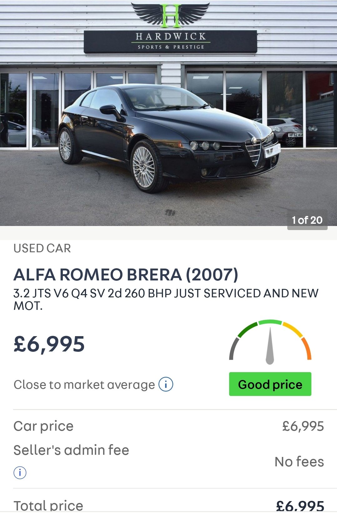

Admin Vista Posted November 27, 2021 Admin Report Posted November 27, 2021 12 hours ago, Rally Pack 2000 said: Here is a question for all you enthusiasts then, if you could buy a classic (More than 20 years) as your every day runaround what would it be? Factoring in your own personal needs to carry family shopping work also affordability and availability of parts etc. Staying with the muscular coupe theme, I'd have the V6 version of one of these quite happily too. Not quite in your 20 year bracket yet though
Moderator Rally Pack 2000 Posted November 27, 2021 Author Moderator Report Posted November 27, 2021 4 hours ago, Vista said: Staying with the muscular coupe theme, I'd have the V6 version of one of these quite happily too. Not quite in your 20 year bracket yet though What Alfa is that? As usual most of the good stuff isn't available here and I don't recognize that model. What age bracket are they? Looks more costly than the Corrado though.
Admin Vista Posted November 28, 2021 Admin Report Posted November 28, 2021 7 hours ago, Rally Pack 2000 said: What Alfa is that? As usual most of the good stuff isn't available here and I don't recognize that model. What age bracket are they? Looks more costly than the Corrado though. It's a Brera, manufactured 2005 - 2010 https://en.m.wikipedia.org/wiki/Alfa_Romeo_Brera_and_Spider Again, price dependent on age and mileage but you can have one for about the same money as the Corrado. The issue with the 6 cylinder versions here is they fall into a very high road tax bracket based on their CO2 output. £600 per year Vehicle Excise Duty is a painful price to pay.
